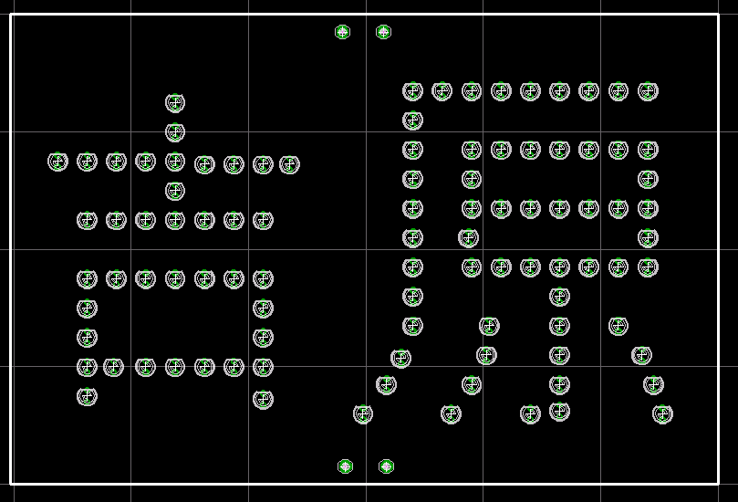

Here is poobah's text as rendered by my default TextEdit font. (i just had to change the text encoding to see the text is Japanese -- i had to cut & past it into TextEdit to make it big.
Is it 98 or 86 LEDs?
I have my 98 laid out, but this is much more interesting (harder to wire no doubt)

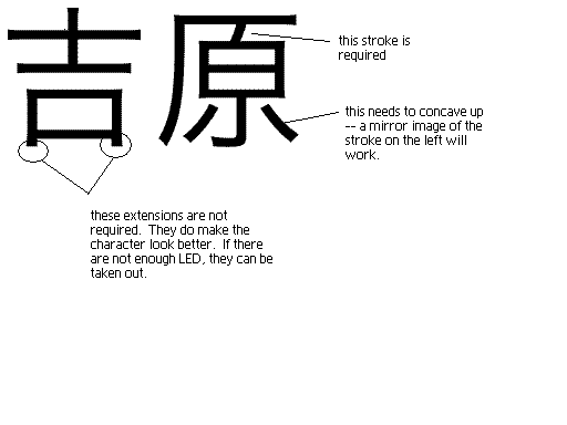

It just gets better and better. Don't we have work to do?
My symbol shows the forth leg of the second symbol as concave down.
Planet 10's symbol shows the forth leg as concave up.
Could P 10's symbol mean, "going to"; and my symbol mean, "just been"? Speaking of the district, that is.

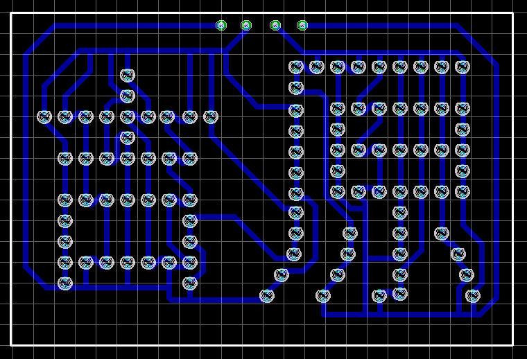

pinkmouse said:No copper yet...![]()
Guess i shouldn't even try to wire mine up like that... i'll wait for boards.
dave
planet10 said:Guess I shouldn't even try to wire mine up like that... I'll wait for boards.
Actually, the wiring would be easy; it's the drilling that would be hard. However, an accurate PCB would make a good template for precise drilling of the chassis top plate...
