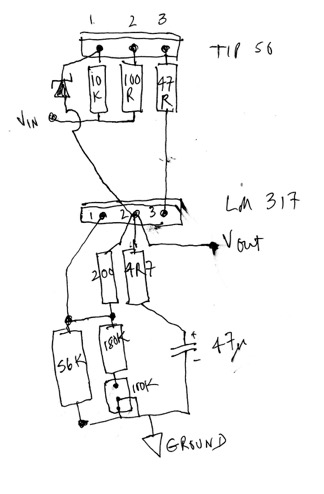

Well, I seem to be unable to make a Maida reg that regs. First, I am checking it out on the breadboard. I have a 120/240 volt transformer into a bridge, then 3k3 resistor followed by CLC (100u/9H/100u). This gives about 260 volts into a 25k dummy load (about 10 mA.)
When I connect the Maida I get the same voltage whether the pot is set to 100k or 0k, about (220 volts.) The TIP50 checks ok as a diode from pin to 2 and pin 2 to 3. The zener checks Ok. I have replaced the LM317.
Also, there is something funny about the pot. I put a new one in, and it goes from 100k to 0k. Then I put it under power, recheck the pot value (without adjusting it) and it reads 24k. Then it won't go above 75k in the circuit. I checked the pot I took out (because it was doing something similar) and it now goes from 100k to 0k. So, it acts weird in the circuit.
I have re-soldered everything several times. No regulation.
Just to have another pair of eyes on this, this is what I made on perfboard:
I am stumped.
