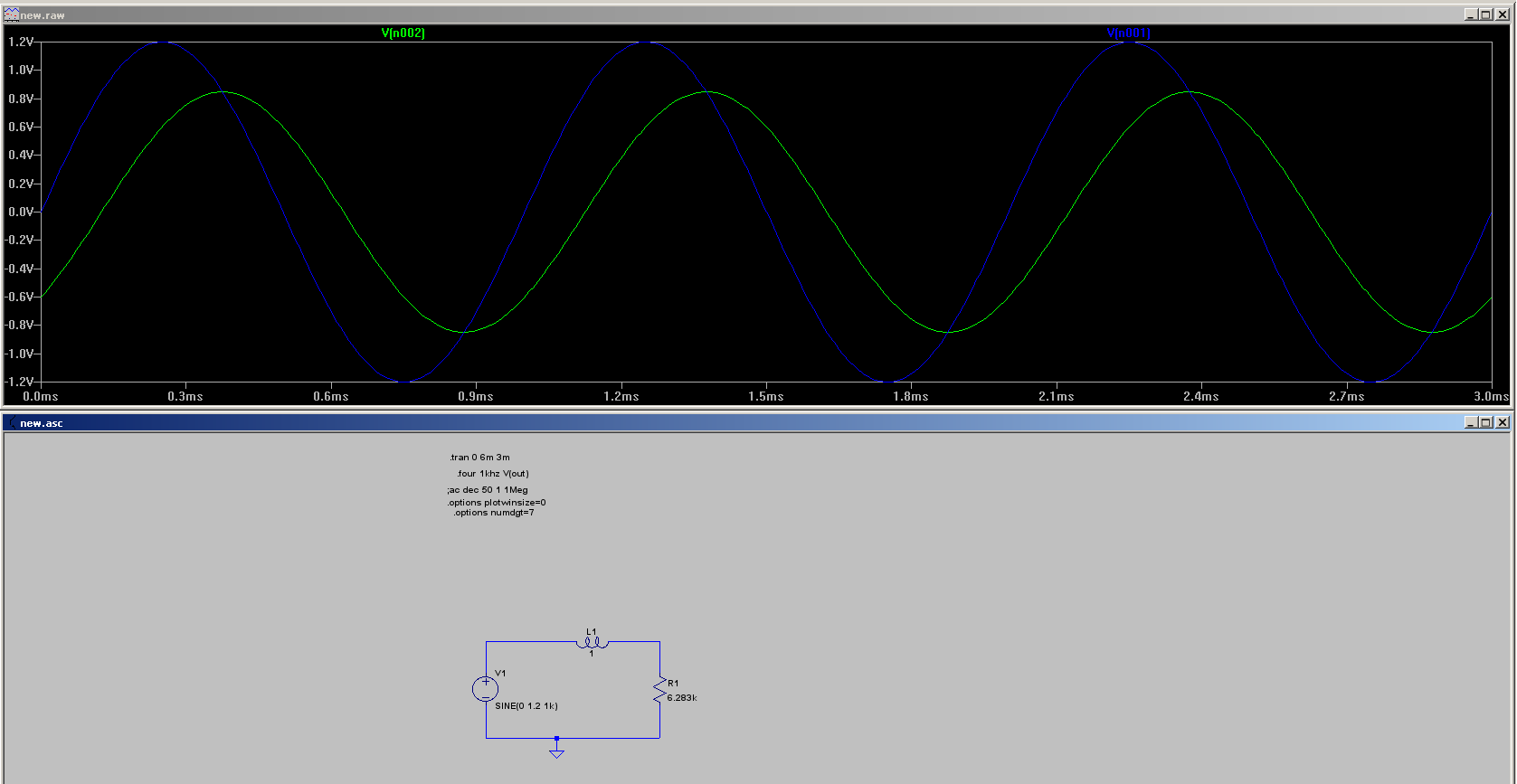

It's -3dB. Remember phase.
I have had the itch to make an EL84 amplifier and in reading through this build thread I remembered my silly question not too long ago that SY was kind enough to answer for me. As most of you know that voltage is leading by 90 degrees for an inductor and lagging 90 for a cap I just want to show it via a graph. My question was that if you calculated the reactance of a cap or an inductor and use the equivalent value resistor to create a "voltage divider" you would think the outcome would be -6db, but as SY brilliantly pointed out to me that phase plays a role in the answer. Here I simulated a 1H inductor which it's reactance @ 1kHz is 6,280, then I used the same value resistor for the filter. For me it helps to see where the peak waveforms are in relation to time, it shows that because of phase it is indeed -3db and not -6db. Most of you out there are very smart and probably find this rudimentary but there are some like me that this will help to see what is actually going on. Oh and I did work through the math but it gave me a headache and figured I wouldn't bore anyone with that. 😱
Thanks again SY for all you infinite wisdom!!
