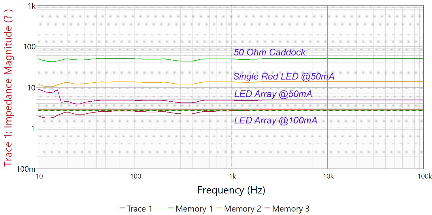

Turns out that at 10mA the dynamic impedance of the single-chip array is 9.2 ohms with Vf of 5.2V -- as you need two it isn't quite satisfactory. If, however, the array is bypassed with 100uF the impedance is ~1.6 ohm.
I would expect the array to have lower Z around 80mA, so will test tomorrow with 6BQ5 at this quiescent current.

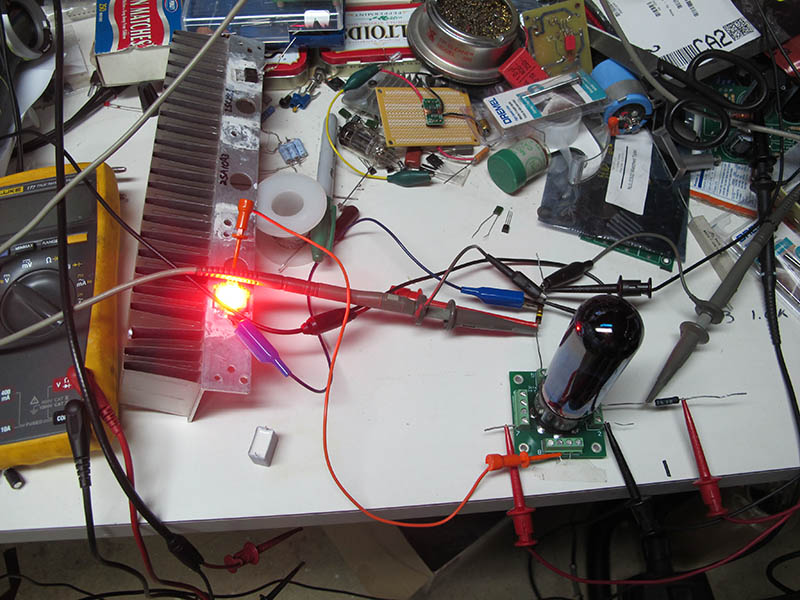

The arrays are these from Marlin Jones, Vf is 5.5V so you'll need two for each channel:
350 Lumen 10 Watt Super Bright, Red LED | MPJA.COM
Just using the setup suggested by SY in the DIYMAG article, plate load resistor is 220R/3W. Adjust the plate voltage until you reach 80mA.
Some measurements -- this is one array -- the dynamic impedance @1kHz and 100mA is 2.7 ohms, so two arrays will get you in the 11V ballpark at 5.4 ohms. The single red led should read 10mA, not 50mA
