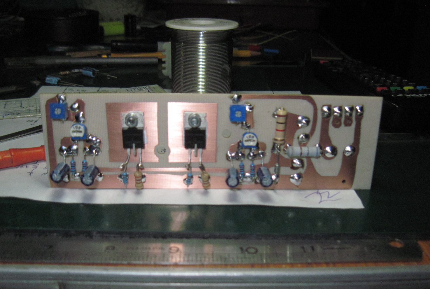

i used the irfbc20 mosfets with zener strings to regulate g2...

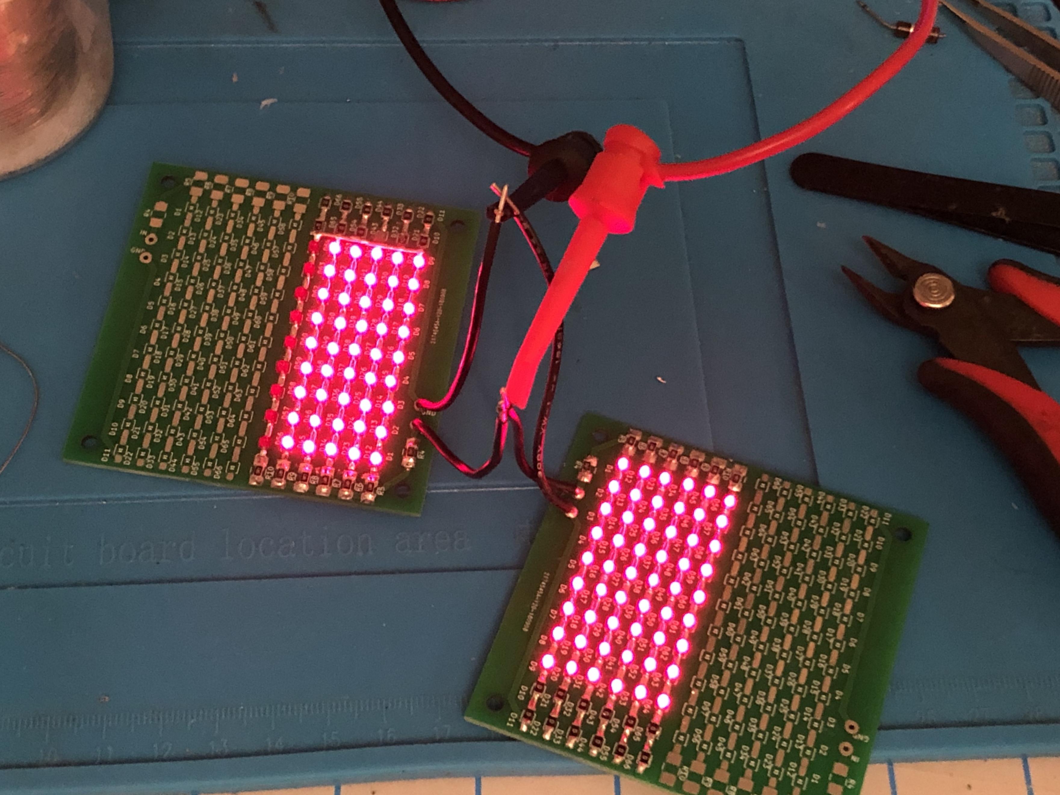

Just using the setup suggested by SY in the DIYMAG article, plate load resistor is 220R/3W. Adjust the plate voltage until you reach 80mA.
Some measurements -- this is one array -- the dynamic impedance @1kHz and 100mA is 2.7 ohms, so two arrays will get you in the 11V ballpark at 5.4 ohms. The single red led should read 10mA, not 50mA

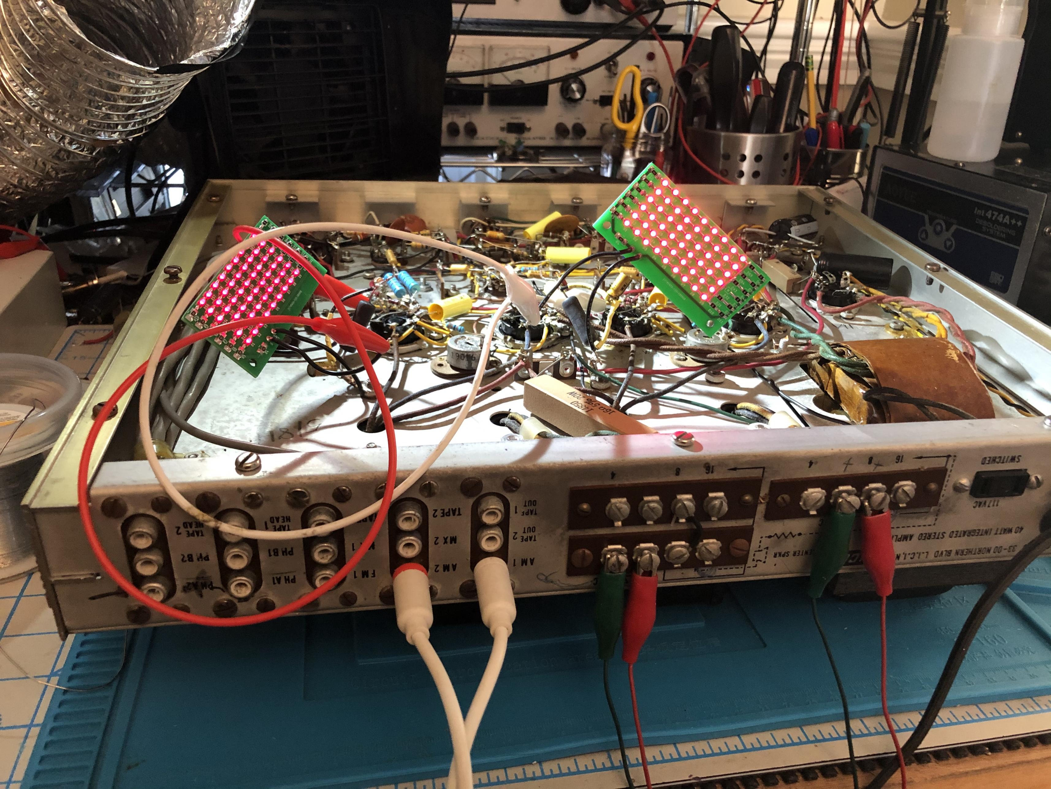

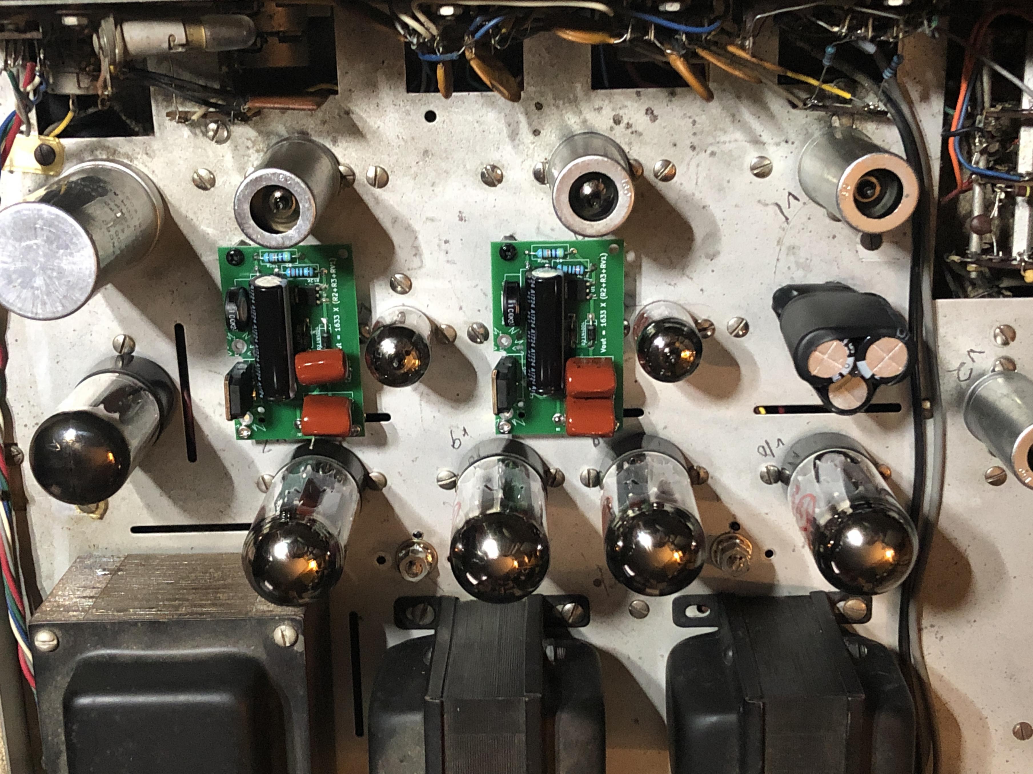

I had been planning a RLD and I still may but what I have done is to RLD-ize an Eico ST40 by adding led arrays and screen regulation. The state of the eico was such that I can’t make a reasonable comparison but I am pretty happy with it.

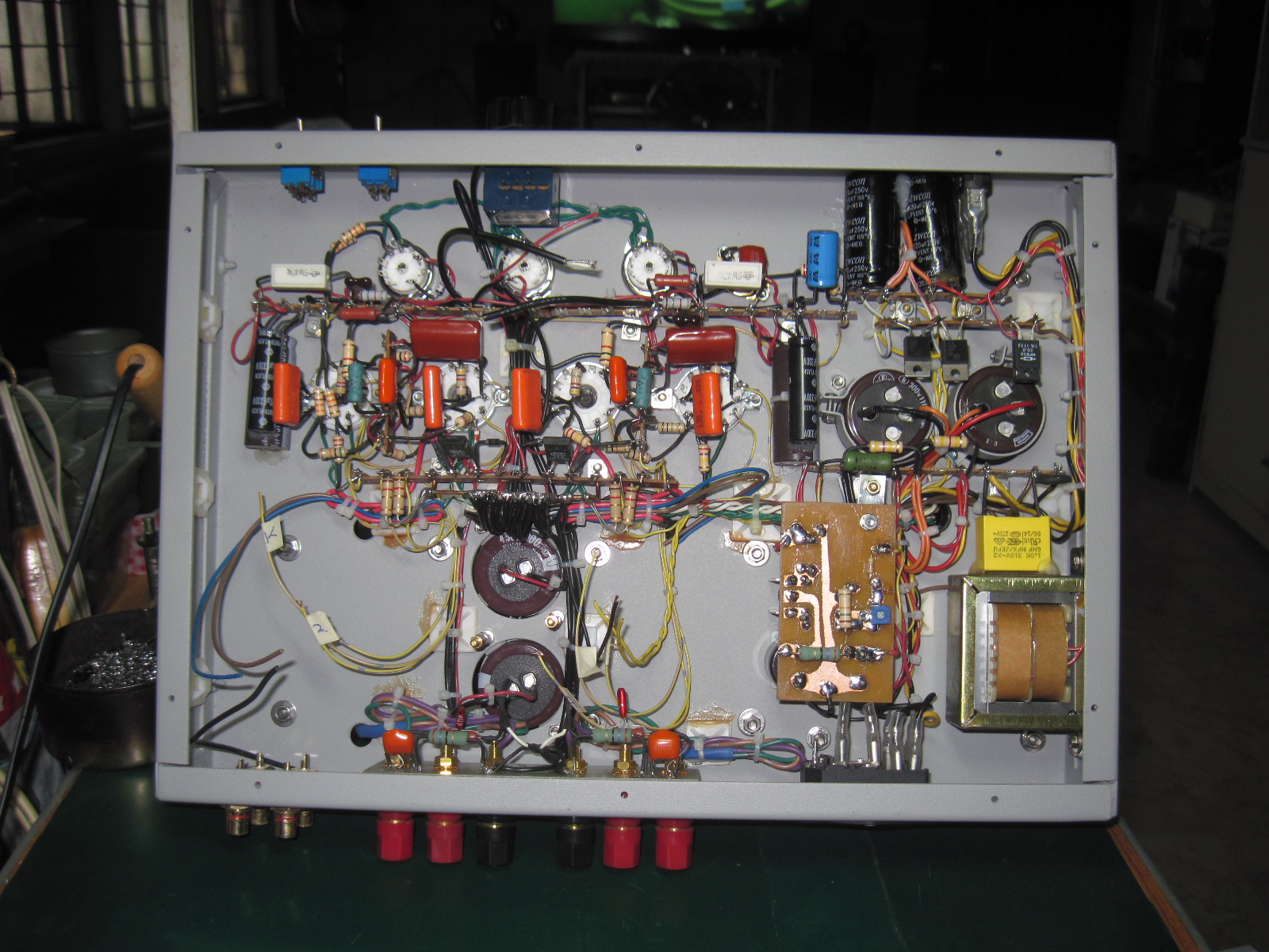

I really enjoy this RLD amp. It performs well. I sometimes like to play loud. And
this amp can.
I just fell for this approach, the way Stuart desgn this amp. Atleast for me it
was a new way to use penthode's.
I don't claim to have `Golden Ears´ I'm an old man. But I know when it sounds good.
Rolf.
