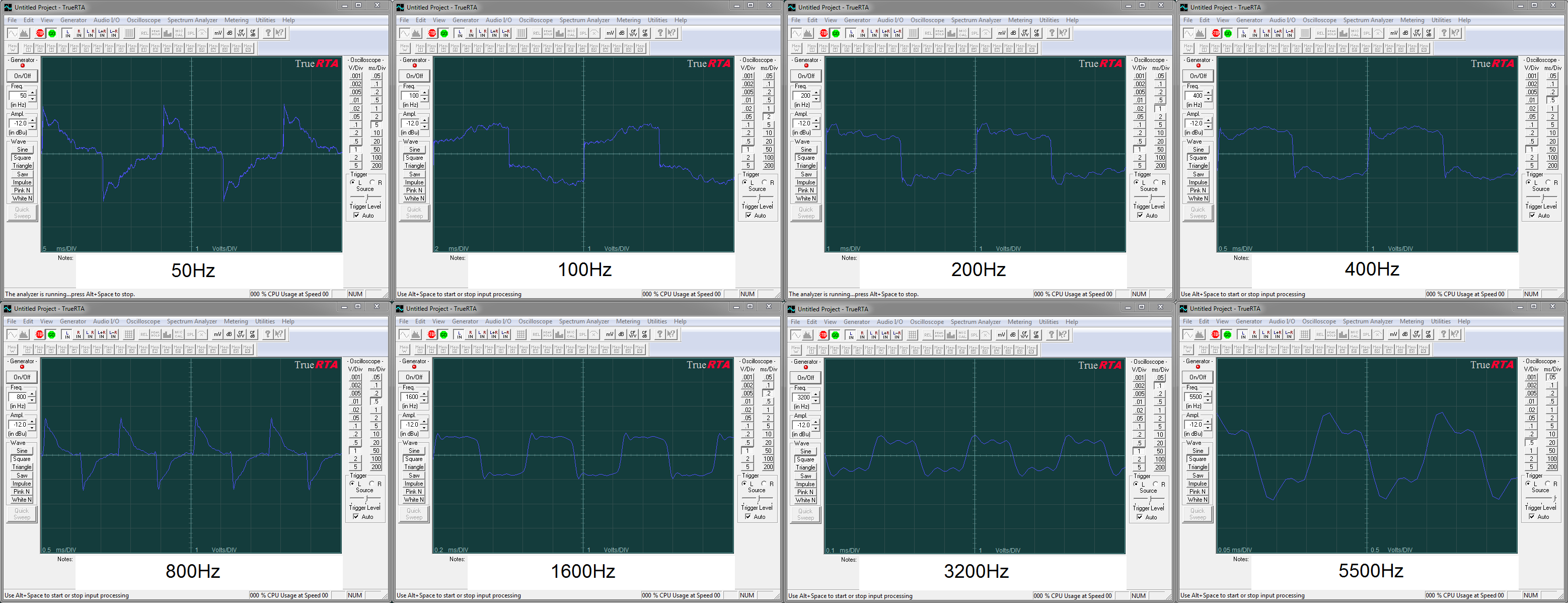

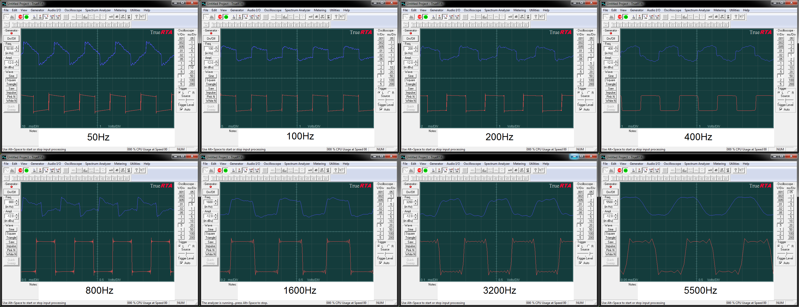

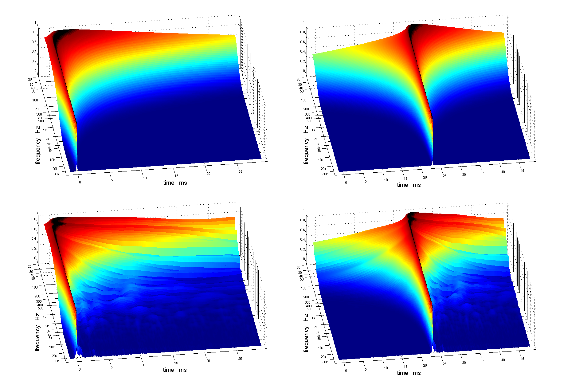

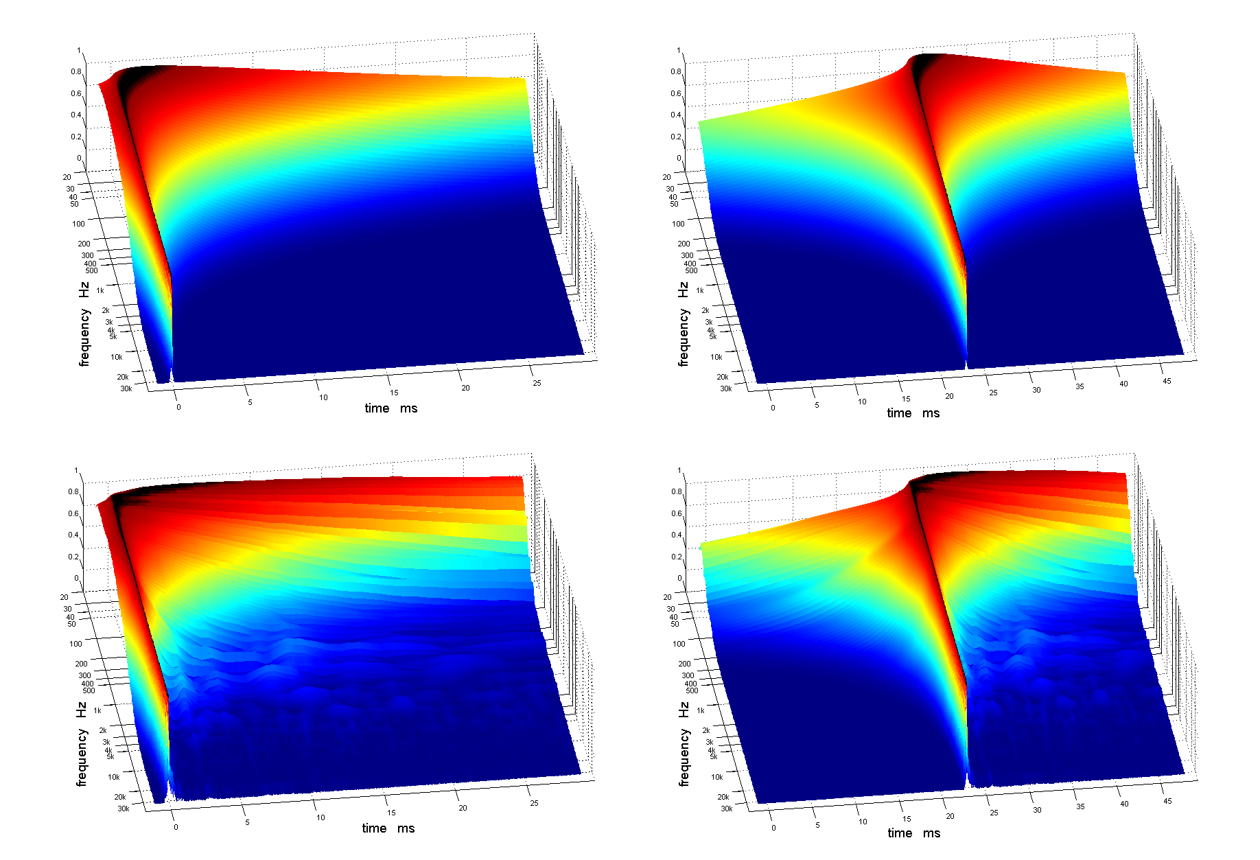

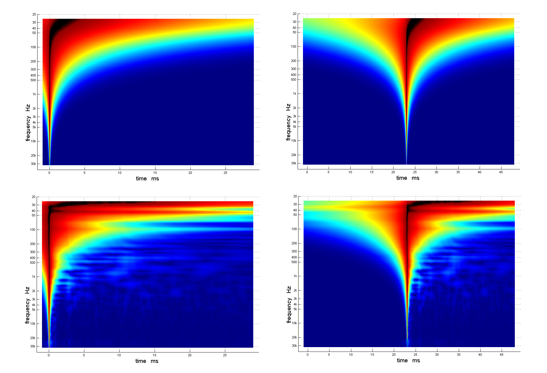

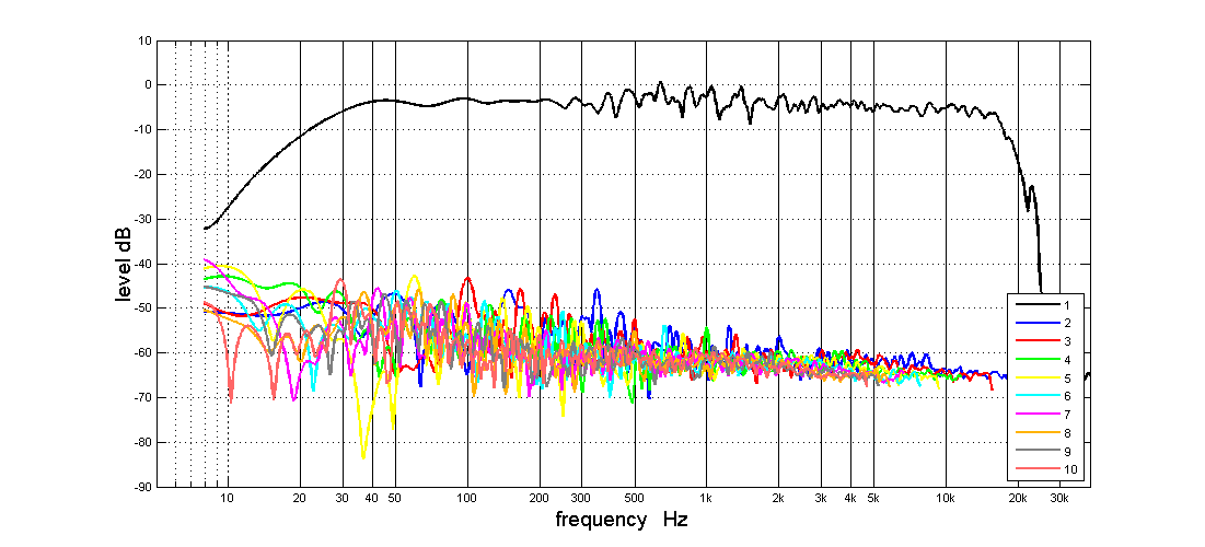

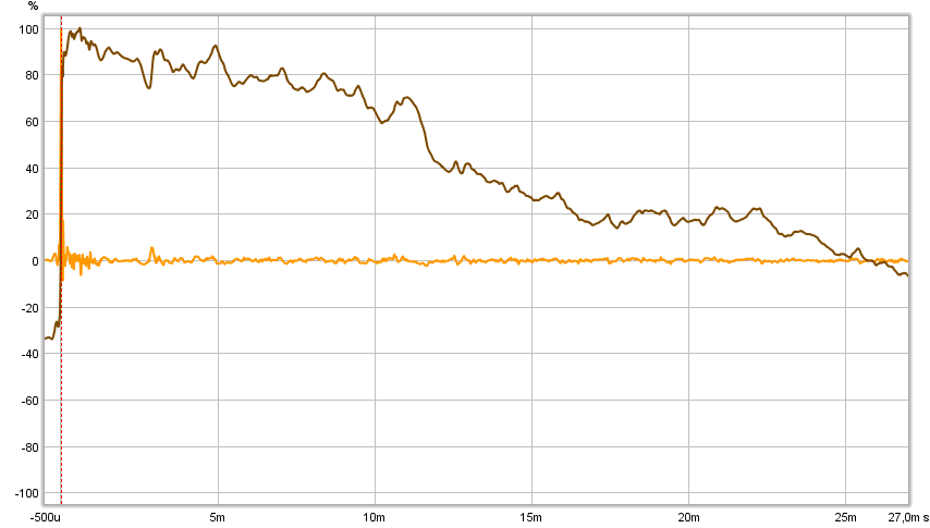

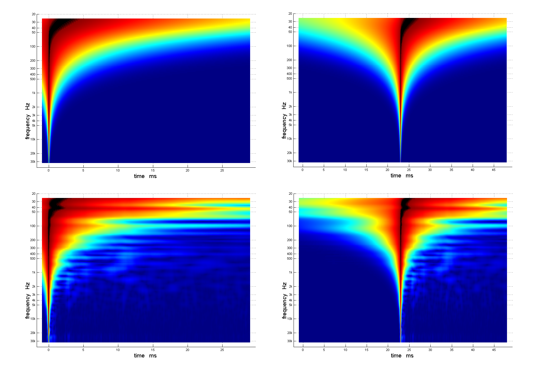

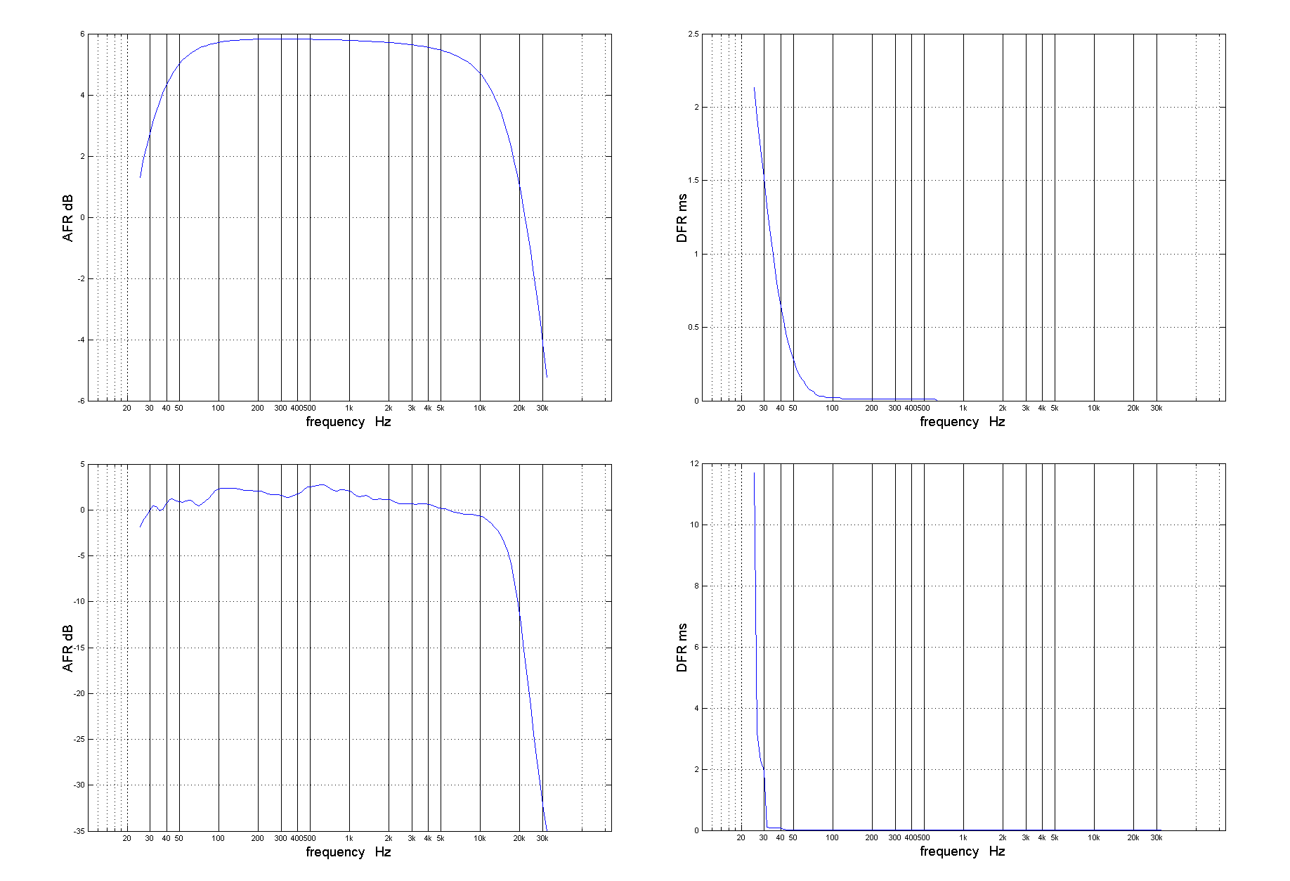

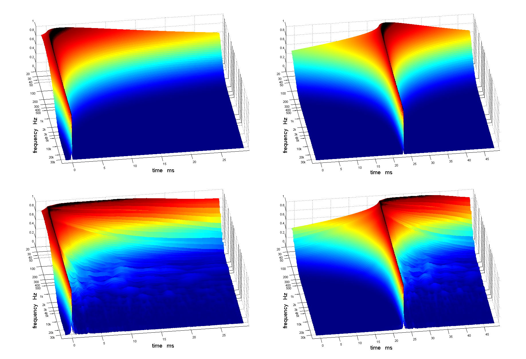

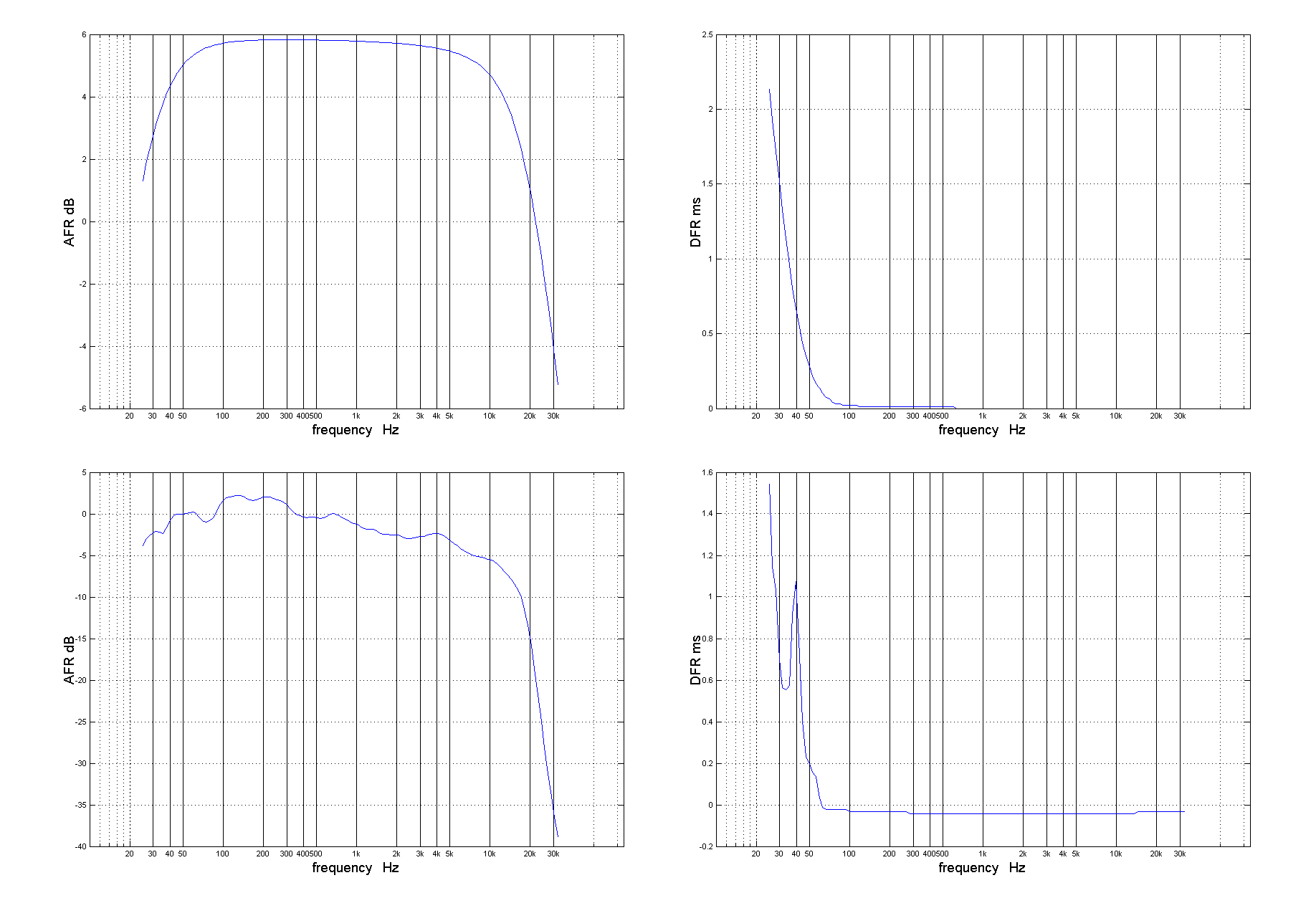

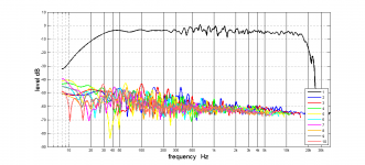

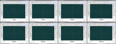

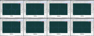

Exercised a bit with program and see it can fine import IR from other software so made a IRR bandpass target profile in Rephase at 96kHz that looks close to my speakers actual bandpass BW2 30Hz to BW2 18,8kHz measured at 30 cm distance. Attach plots where perfect targets is at top and actual progress so far below.

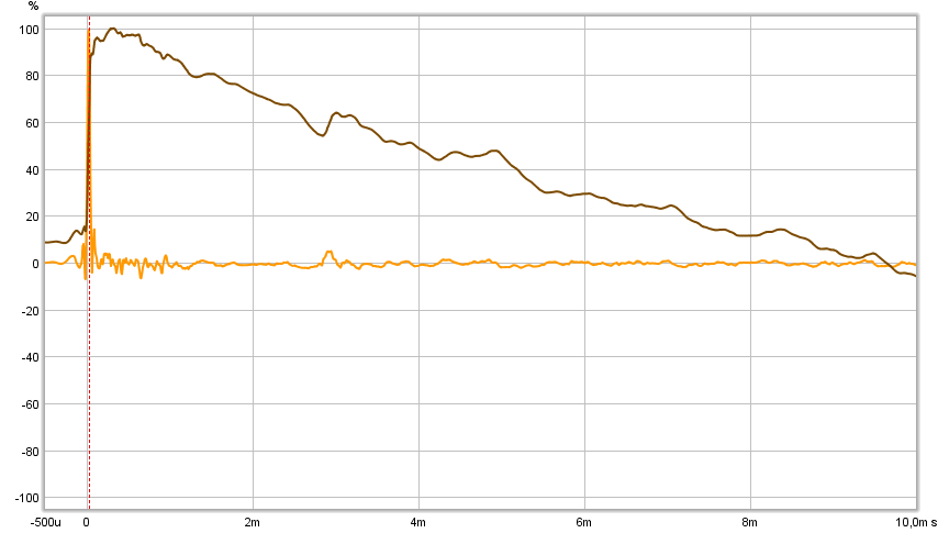

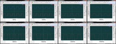

Results associated "just AFR correction BYRTT_1p_AFReq.wav" combined Rephase created FIR filter explained post 179.

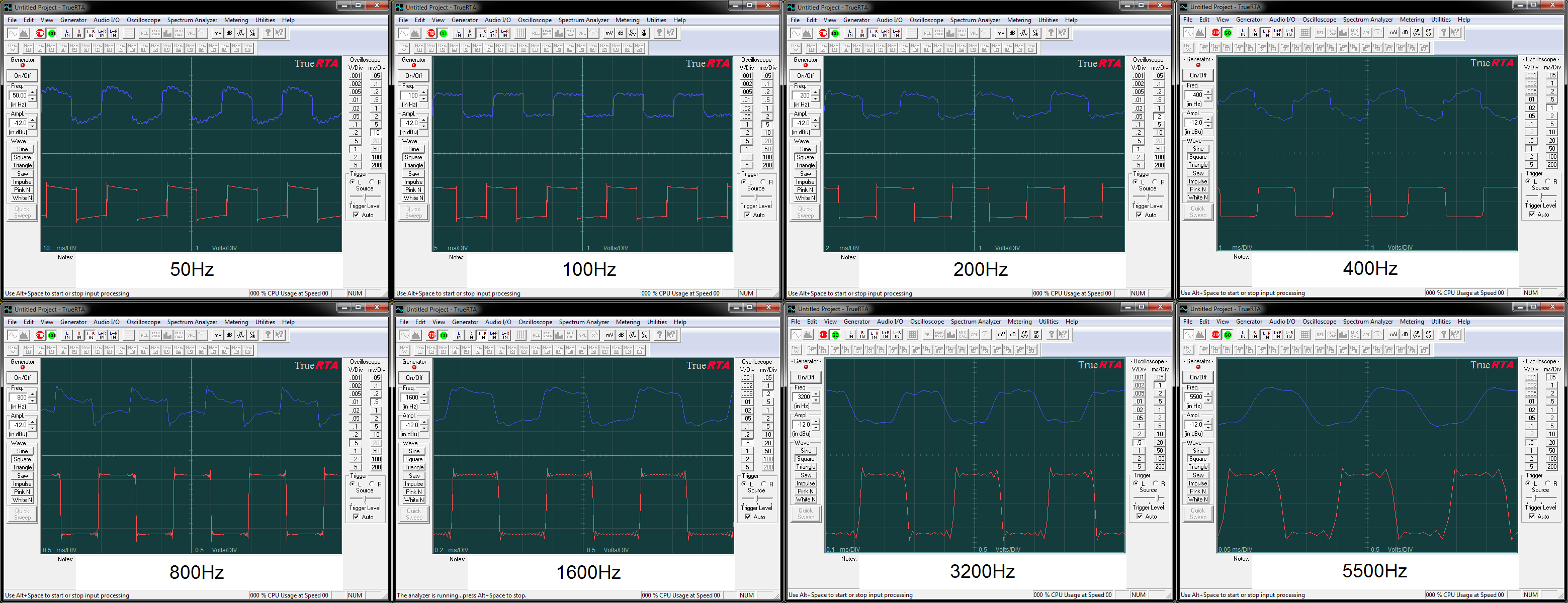

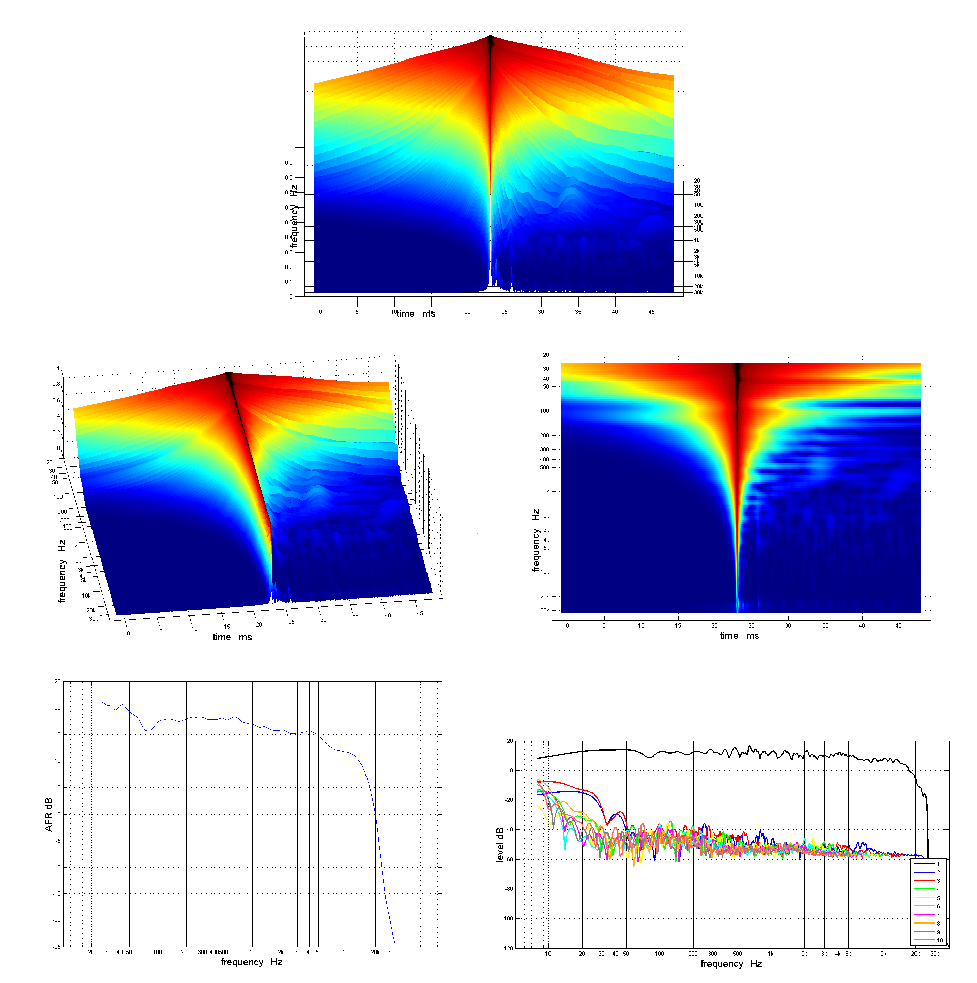

Square waves and APL_TDA plots with targets at top set to BW2 30Hz -BW2 18,8kHz.

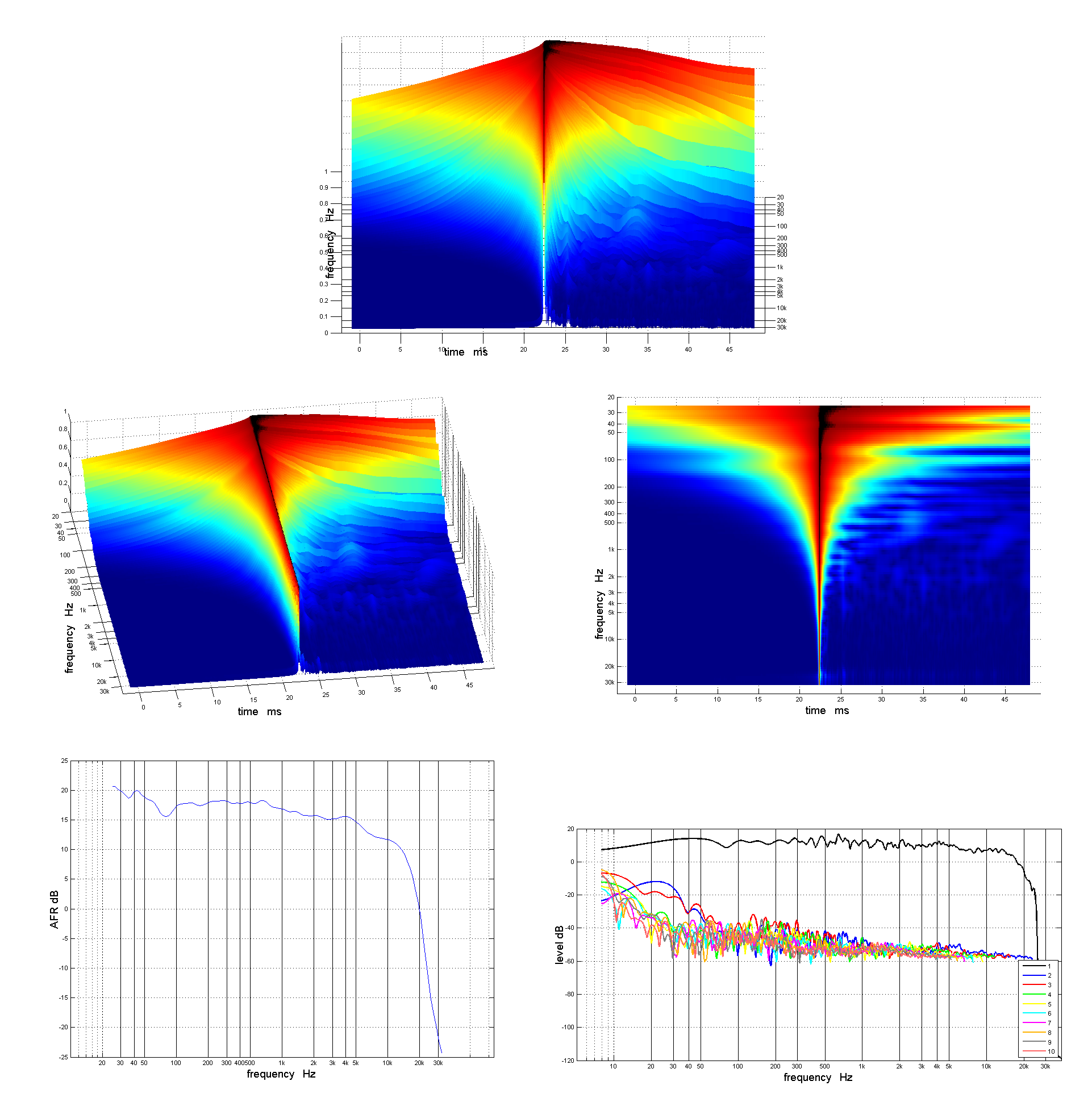

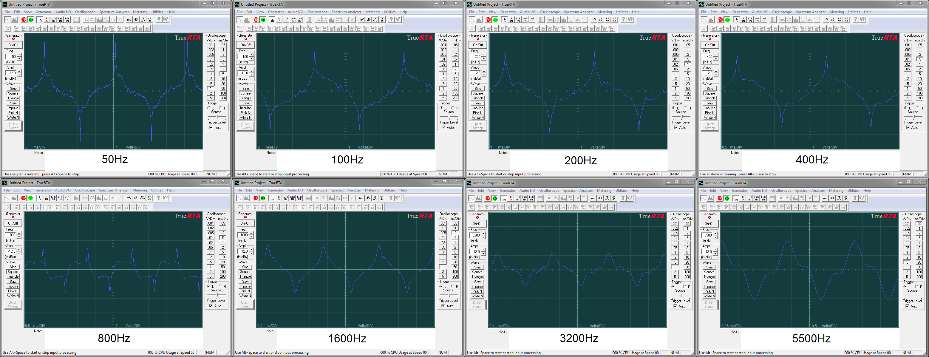

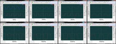

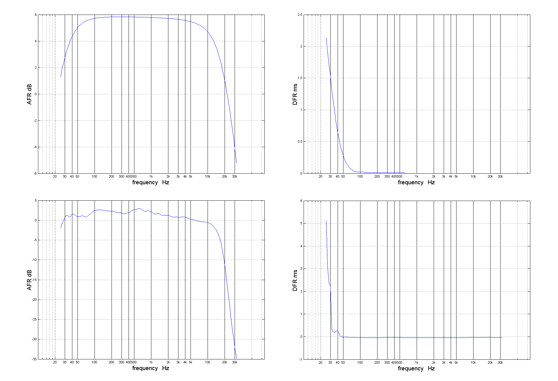

Results associated "AFR and DFR correction BYRTT_1p_A&Deq.wav".
this one timing looks super flat most of band but no squarer waves.

BYRTT, did you try the AFR and DFR corrected version too? From post #180?
Above

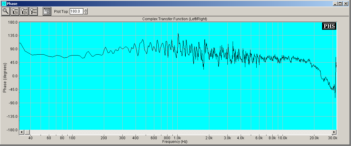

All components are shifted by 90 degr in result - Hilbert transform ...
But why : )))
Really don't know but reminds me minimum phase AC filter coupling function BP/HP/LP, inductors and capacitors, and 90º phase shift per order.
Enjoyed music via first 25 pulse filter all evening, quality is incredible good work.

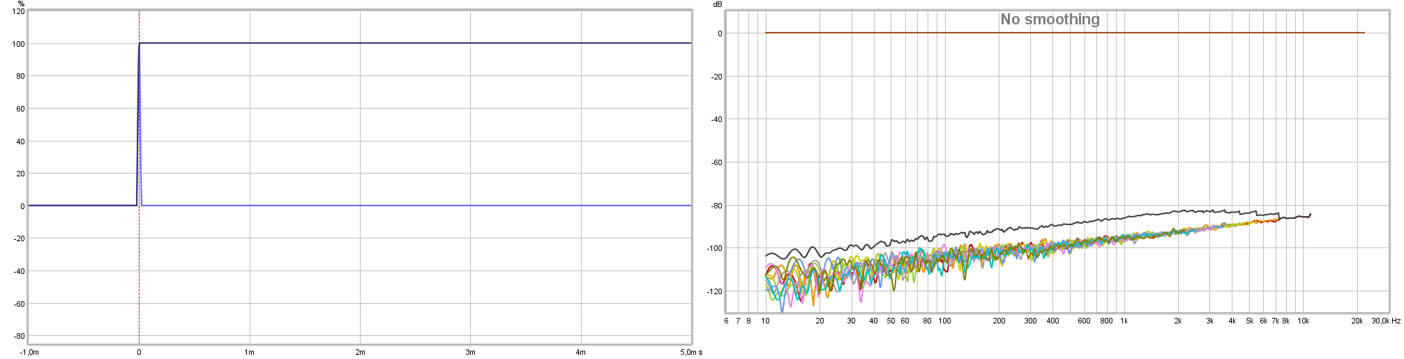

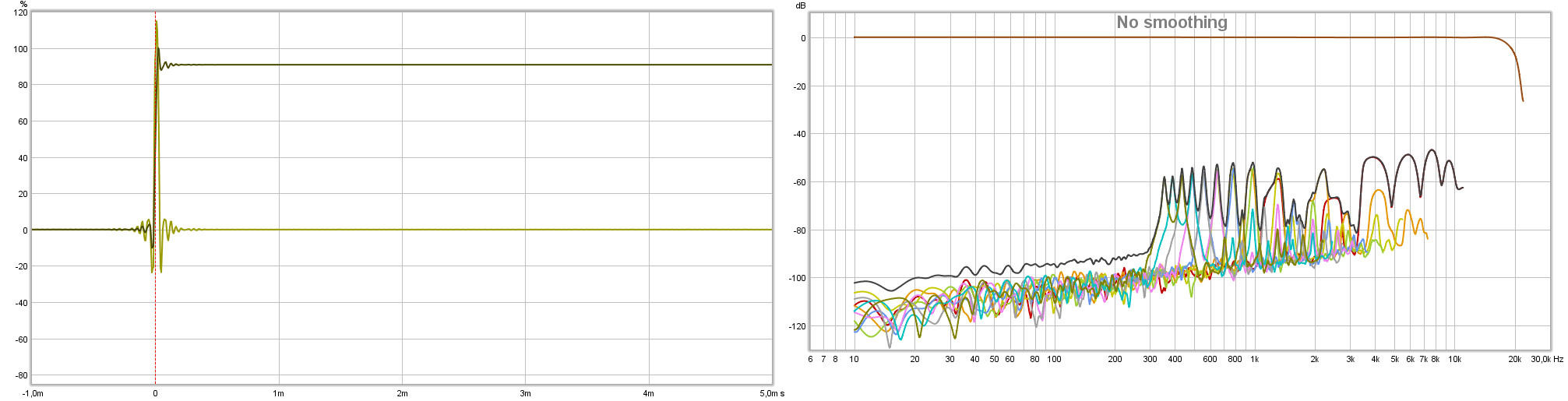

Is it possible to get EQ correction IR-wav file from post 174 in 44,1 and 192kHz. Ask because done some loop tests and it looks like SRC don't come for free, in two examples below its a SPDIF I/O loopback where WDM is locked 44,1kHz and REW is run at 44,1kHz and 48Khz. Don't think JRiver DSP distort as much as WDM but can see output frq response is distorted from JRiver when plug ins is not native sample rate. If its possible to do myself would like to have a tip, had a try in Audacity but in exported file one could see that even peaks and dip scheme was same they were not in sync at same frq points.

Interesting that resampler is whistling at 48000-44100=3900 Hz and that is displayed as 355 Hz on 11. harmonic`s curve, as 390 at 10. harmonic`s, 433 at 9. and so on.
You may use any reliable wav editor to resample to any sample rate you need.
The slight difference you observed may be caused by too short FFT block size.
The padding with zeros to block size of 65536 or even more will make curves more accurate and readable.
You should consider use of APL VST plagin. It is converting IR`s to any necessary SR by itself and automatically at any stream SR change.

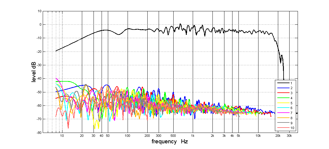

Put some more time into tweaking with APL_TDA, news is extended low end reach with IRR filters now roll off in 15-20Hz area and made new FIR correction that suits new low end reach in two versions, one with linear phase in lows and one with phase turn as a 15Hz IRR BW2 stopband.
