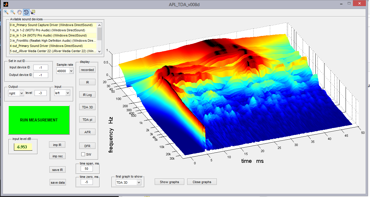

Don't you have drivers that came with the MOTU interface?
I would use MOTU drivers (probably ASIO), and not Windows DirectSound.
-71dB means the mic is not picking anything, even though the sound coming out of your speakers was loud, the problem is the input.
Also, I can only run APL once, if I try to run a second time, the window will close by itself, which I thought was a demo limitation. If I want to measure again, I have to reopen a new APL window.
It doesn't support asio and I am using the MOTU windows driver. I don't see any other knob to twiddle atm, the wdm input is turned up and REW reads the same input at the same level ok. I will try again later anyway.
I don't think mine is closing deliberately after a measurement, it seems more like an out of the blue crash to me. Hard to be sure though.
there is definitely something dodgy with these motu windows drivers or windows. I debugged further and found that choosing the windows audio device wasn't actually choosing that device, instead it was just using whatever was selected as the default device in windows irrespective of which output device I chose (same behaviour in both REW and APL). The glitch was present at 48kHz too independent of APL. Mysterious.

So setting up the Asio drivers in JRiver as output, setting JRivers WMD driver as default in Windows AND choosing that one in APL should work, right?
Be sure to have JRiver open and visible when running APL, it will show something passing trough. I had a hard time getting it to play nice until I set: "Play silence at startup for hardware synchronisation: None" in JRiver's audio settings. I had that set to a (very short) value to mask a different (Asio related) problem.
I'm not sure exactly which thing fixed it (reboots were involved) but I managed to get some data by going through the jriver wdm (and by fixing the input level, I had missing a setting on the input ... must have been measuring at war volume at some point
). There was still a glitch in the sound but it was before the sweep so doesn't seem to have affected the measurement itself. I still can't get a clean loopback through the motu windows device though, not sure what is wrong with that. I usually only use asio so never noticed whether it works properly or not before.

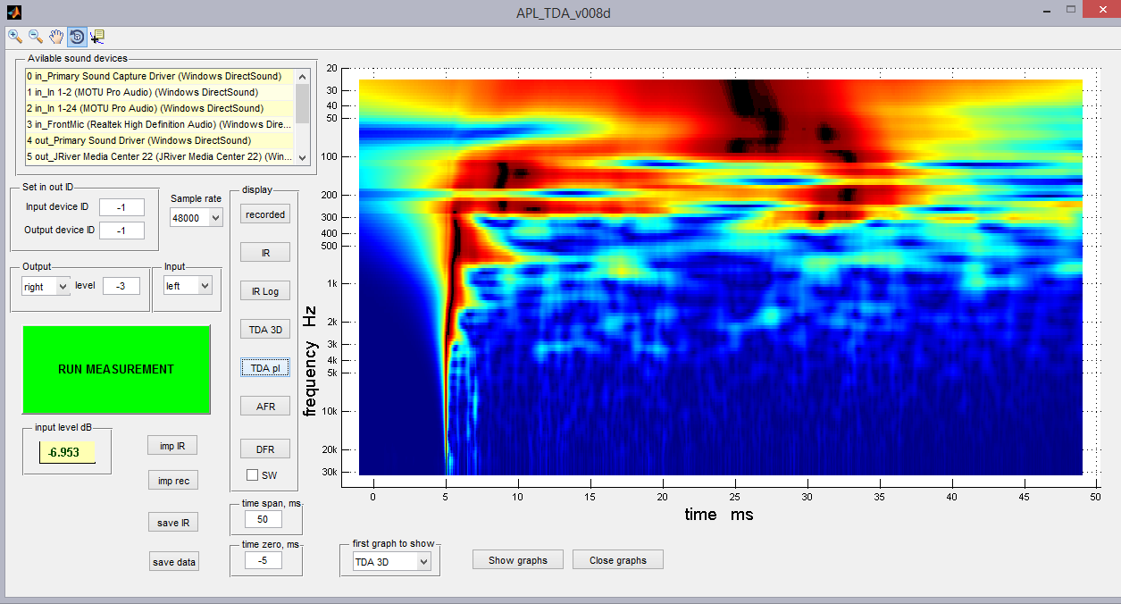

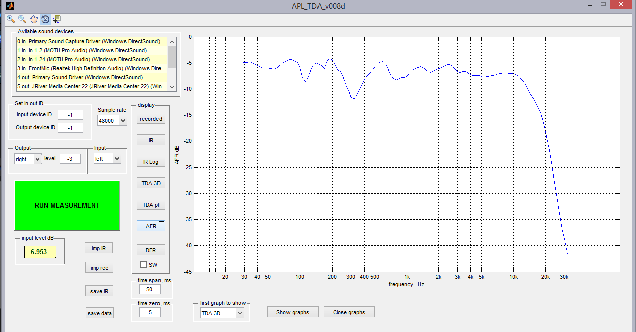

It's quite ugly at the low end though I think this is exacerbated by normalisation (& the matlab jet colour scheme). The "heel" around 60Hz is due to mic positioning in the 1st axial width null which kills the initial level. The bit I definitely want to work out how to fix is the v slow decay around 120-200Hz which leads to an excessive warmth with some content atm. No formal room treatment in here atm btw and I haven't done anything beyond a "get it working" set of acourate filters since I built some new speakers so some optimisation is required.
FWIW I persevered because I wanted to see how this view looked for my room. I think I agree this is a clearer view than the REW equivalent. I say "I think" because I think an unnormalised view would be a good thing to have.
![APL_3d.PNG APL_3d.PNG](https://www.diyaudio.com/community/data/attachments/533/533031-e13eb12675bdbe6b4393ed60d5c98406.jpg)
![apl_afr.PNG apl_afr.PNG](https://www.diyaudio.com/community/data/attachments/533/533049-7fe106c76ef689099118efa4bed3b791.jpg)
![APL_top.PNG APL_top.PNG](https://www.diyaudio.com/community/data/attachments/533/533062-75f8b3c1490029c5b243898def140f90.jpg)
It is still v crashy btw, it generally lasts for 2 measurements before disappearing and is definitely crashing because the window just vanishes while I look at it (and can leave behind the "this is a demo" extra window). I installed to my local user dir so don't think the system partition thing should be a problem. I don't have a win7 machine to try it on, only win8.1 and linux here.
