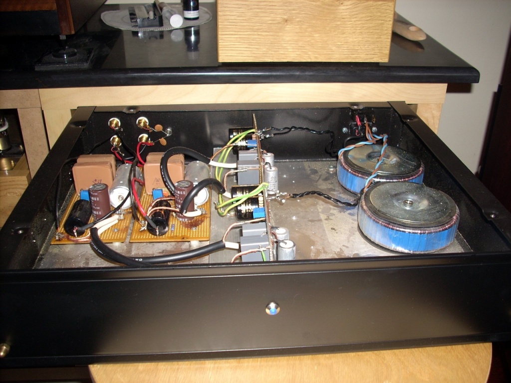

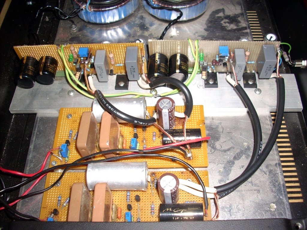

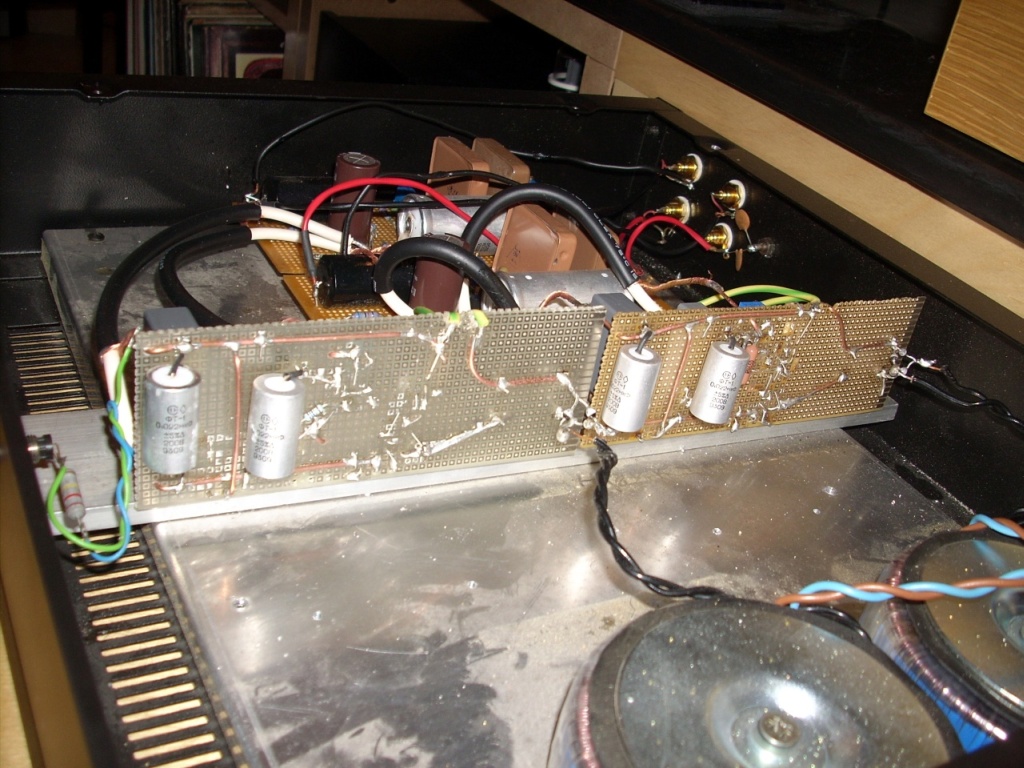

V1.2 on njfet simplistic MC phono
Ooops! I had pics from another 1.2 build for simplistic phono in my email box and forgot to see. Its about double mono 36V V1.2 with IRFP9240s this time. Like the first single rail CCT in page #190. Made by member Mikvous. You can see the application of coax on sense and force (Mogami stage monitor speaker pure copper thick coax). Also bypasses of Teflon FT-1 CCCP NOS on the main film caps. Mikvous said no practical problems he had, and also found nice subjective performance. He substituted V1.0s. Thanks Michael.
Hi Guglielmo
In V1.2 circuits, the sense wiring should be carried with a coaxial shielded cable. Else noise will never be really zero in very high frequencies beyond audio. Mikvous had thick coax so he used it for the main force wiring too. If his phono was originally made with 1.2s in mind, he would probably had +/gnd near so not to expose the edges so much. But 1.2s are a recent months project.
