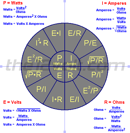

Many thanks AndrewT, so for a total parallel resistance of 10R2 I have to parallel a 68R 2W to get 200mA, right?
no. Volts / Amperes = Ohms.
Your calculations:
62,6V / 0,2A = 313 Ohm

measure voltage on R1. Then divide this voltage (Volts) with R1 value (Ohms) and you will get current through resistor (Amperes). You can not just stick your input voltage, then multiply with wanted current, this is not correct.

Tomorrow I will use 12R 2W, so:
Voltage on R1 = 1,62V / 12R = 0,14A
I will follow Salas advice, 1st test the phono & after fine adjustment using 10R or other value to reach 0,2A
merlin el mago said:Tomorrow I will use 12R 2W, so:
Great
Now you can use formulas from my picture and calculate power dissipation on your 12R resistor:
Watts = Volts x Amperes
1.62V x 0,14A = 0,227W
Your resistor will need to dissipate 0,227W. Multiply this value by 4 or 5, to be into safe area and round to nearest higher standard value.
0,227W x 4 = 0,908W and with 1W resistor (or more) you will be on the safe side
