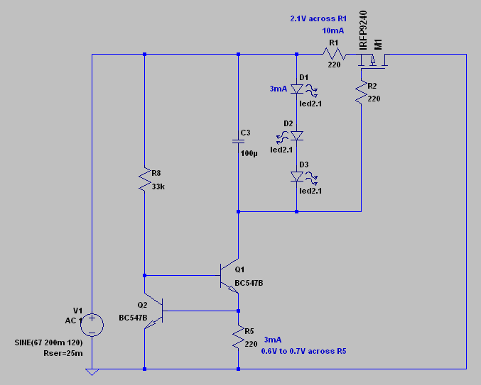

Do you know what is the Vf of your LEDs? R1 should be roughly equal to (3 x Vf) / desired_current. So for testing, if your LEDs have Vf = 1.8V or even Vf = 2.1V, and we're aiming for something around 20mA, then you can use R1 = 300R.
For 1.8V LED
I = 3 * 1.8 / 300 = 18 mA
For 2.1V LED
I = 3 * 2.1 / 300 = 21 mA
The 300R resistor can be 1/2W or whatever you have around.
You will know it works well if you measure the voltage across R1 and divide it by 300 and if the result is close to about 20. Of course you should see the LEDs on.
Try to implement just the CCS portion with a 300R for R1.

Many thks for links to test devices, I printed to follow instructions
I have a Caddock MP820 301 ohms & another Caddock MP820 4K75 both 2.25W, could I use them?
Have a look at this attachment, and the test points. In reality the values will be a little different, but not very much.
It's possible that depending on the LED type, not to show a lot of light with 2-3mA going through.
Iko, that's not for me, right?
That one will run +/-180mA if your Leds can reach 2V Vf for about 2.5mA. Else, about 150mA. R1 sets that. ICCS=(Vf3LEDStot-Vgs)/R1. Fix it given your actual parts. The trimmer gives you an adjustable Vout. Don't ask more than 65V out. You can use BF245A if you can't get 2N5457, don't use anything more than 3mA IDSS collector load, so to keep the error amp BC546B dissipating conservatively. Remote sensing is recommended. You have seen how on the one I showed for Merlin a few pages back. Good luck.

Sorry Iko, so if I understand well is possible that LEDs don't shine or shine very low, but the reg. still not works?
Yes. More importantly though, you should measure between 5 and 6 volts across the LEDs.
My advice is to implement the exact schematic (using bc546) that I showed above, and if you measures very close to the values indicated on the schematic, then you have the CCS, a current limiter, working well. Only then move to the next section, the shunt part, without fear. Because no matter what happens in the shunt portion, your current limiter will not allow anything to happen in case of a short circuit in the shunt.
