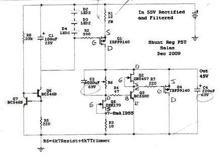

If you'd like my help search the schematic, post it here and show the values of any capacitors and resistors that you've changed, then I'll ask you to measure some voltages around the circuit.
![161034d1267733290t-simplistic-salas-low-voltage-shunt-regulator-salasshuntregpsulowmcph.jpg](https://www.diyaudio.com/forums/attachments/power-supplies/161034d1267733290t-simplistic-salas-low-voltage-shunt-regulator-salasshuntregpsulowmcph.jpg)
R1 / 10ohms, the rest of caps & resistors as the schematic.
If needed can I post a picture with the other pcb side?

Are you using a single heatsink for both mosfets ?
The image is too small, what was the post number please?
But, if the LEDs are not lit up then the CCS mosfet isn't biased properly. Check the two bjt on the lower left side of the picture. With the DMM on diode test you should read something between B-E and B-C pins, one way only, and the reading should be close in value.
Yes I am using the old chassis of an Audionote DAC as heatsink for the 4 mosfets.
If they aren't insulated, bingo! Here is your problem. Use your DVM, you must not see zero Ohm between their middle legs. And take out that 150R. Its overloading beyond CCS setting even if when it will work. Find something around 1k to 2k. Or leave it unloaded. I wrote again yesterday.
The mosfets are properly insulated. I used mine DVM & I not see zero Ohm between their middle legs. I only have 1k 5W to load the reg. it's ok?
Newbie question: I have to read both BC546B with the power on?
1k 5W is great. Get em out and trace 'em against schematic. Is your trimmer wired like that?
So you want that I replace the 150R 10W for the 1K 5W to load the reg.?
Make sure there is current going through Q6, Q7, R8, and R5. Measure the voltage across R5 for instance, and divide by the value of R5, let us know what it is.
Is necessary that reg. is loaded with 1k 5W before do the measurements?
The voltage across R5 is 0.5V, across R8 is 61.2V
Yes.And I want to be sure that you have the trimmer and its tail resistor Rref system connected as I posted on top of this page.
After the mosfet Q1 I have first the resistor & after de trimmer, is necessary to change the order?
