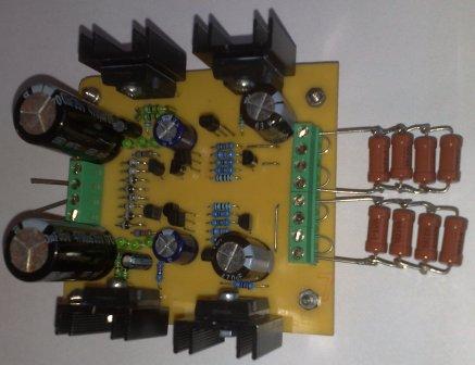

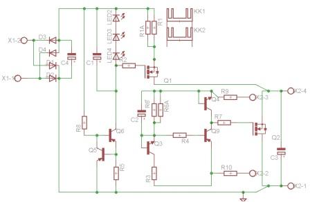

Dear Salas,
I have built Salas v1 nice regulator. It is symetric +-24V - it is working properly. I have one question. I can chose shunt MOSFET from whole range of gate to source voltages at 200mA. My opinion is that higher voltage could improve performance since Jfet at input of this Mosfet will be working at e.g. 5.5V Drain to Source instead 3.5V. Is it reasonable or just my fiction?
Dear Salas,
As you can see I tried to avoid to use 12 Led as a reference for plus and minus power supply. I simulated this circuit in MicroCap and the results were nice. I avoided trimer as well. I used two resistors - one trimming the other one. The voltage is stable. It starts at 24.3V and within two minutes it finish at 23.9V in each branch.
I will try to replace my existing power supply in Dispre preamp from PMA (you can find in diyaudio).
Some another notes to my pictures:
I used IRFP 240/9240
Current source is set to 200mA - there are 2 paralel resistors in source
Heatsinks are below 60 deg
Diodes are BYV26C
Design is made in Eagle software. I can send the design to anybody who would like to have it - of course for free.
At the picture you can see bipolares instead Jfets - it is just because in my database is not nice footprint for 2SK170. At the ready sample there are 2SK170V.
Transformer secondary is 35V after rectification
Diodes are BYV26C
Eagle works OK for assigning pin compatible BJTs. Good work.
Of course using fixed resistors is good if you know your fixed application. Low ppm good quality resistors as reference and the quality of the capacitive bypass is audible enough.
What is R9,10 in the remote sensing take off points?
Let us know your impressions after listening on Dispre. I hope it will enhance.
