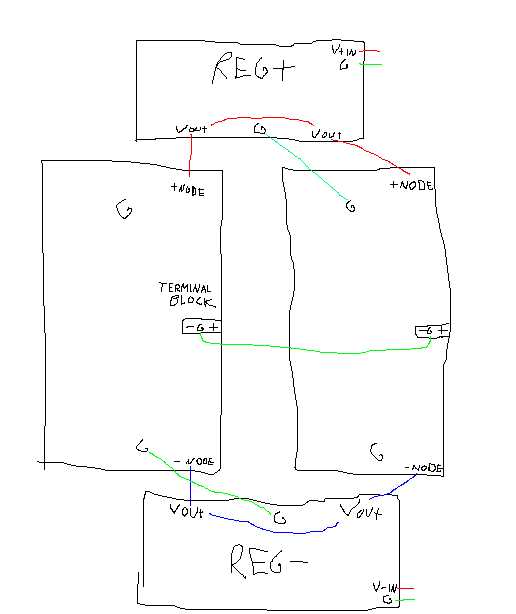

yes i know that would be optimal but the thing is that with two seperate amp boards for left and right channel, i think it s pretty much the same to just put the reg as close as possible to the amp boards with short wires, no? we have to consider the size of the amp board in my opinion also
i agree that for a device that has everything on one board, it s more convenient. but in my case there still will be a good lenght of wire left, that the sense wire wont have control upon. i dont know if you get me?
so my theory is that i m better off with one reg for each board, or no sensing wires at all keeping short connections.
what do you think?
I think that double mono symmetric 1.2s and to sense each amp from its own reg where the most important consumption and grounding nodes are on each amp's PCB, that would be optimum. But we can always connect best possible what we got. Post even a cellphone camera picture of your amps and shunts placed as you find handy for inbox construction, so we can think of best compromise.
sense leads should sense where the paralleled outputs leave the single track output. Design the single traces routes as close to the amp boards as possible.
Then put the amp boards as close to the sense points as possible.
Do not sense one board while another board is the load. The signals at one board could be out of phase from the needs of the other board and the reg will make the wrong corrections.

also, attached is what i had in mind for my amp (beta22). i think that way remote sensing is unnecessary, with the boards very close one to each other. maybe there is a founding mistake or two but the idea is there

Use something PNP in hand loosely compatible for now. You substitute best soon.
I would connect 0 from regs at one mid point between the 2 amp channels. Can connect their 0s with a thick copper wire and bring the regs 0s on its middle.
