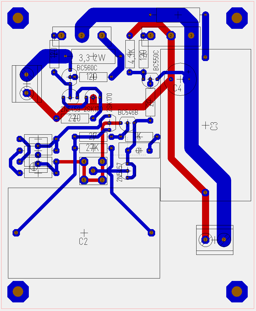

I finally had some time handy to do the PCB design I wanted to do for the version 1.2.

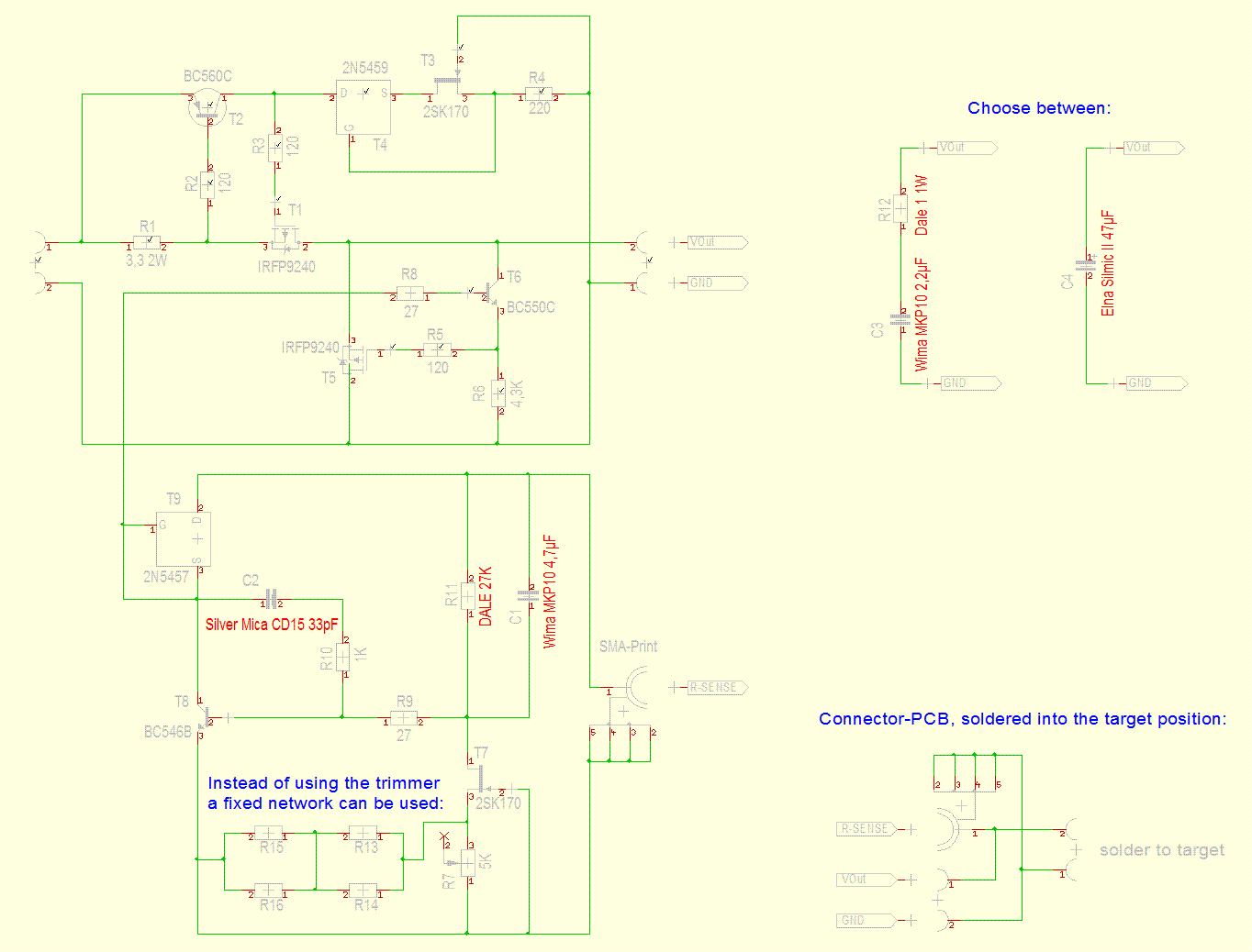

First I drawed the schematic again for having an easier time to do the PCB-layout. Then I thought of using a PCB-version of a SMA-connector for the remote sensing and added that one.
I have included options to replace the variable resistor with a network f fixed resistors for lower noise and the pcb allows for the use of a zobel network or a electrolytic cap as output compensation.
The two IRFP9240 are meant to be soldered from the bottom and directly screwed onto a big heatsink - it is for experimenting with lower values for R1 and correspondingly higher heat dissipation.
I usually only design smaller uC-Boards and so I have no experience whatsoever in designing analogue PCBs. Therefore I would be very happy about feedback on how the design could be improved.
Blue is top and red is bottom copper-layer. Aside from two very short sigals, only R-Sense-Ground and general Ground is routed on the bottom (red) layer. The final PCB will have a groundplane on the bottom-side. It is just omitted to show the ground pathes.
Talking about ground-planes, do you advice to add a second ground-plane to the top copper-layer, too?

I would use the second layer and mounting under, so to bring the 120R gate stoppers and base stopper pads in touch with the semiconductor pads they address. Especially the BC560's base stopper is very far as it is now. C3 and/or C4 output caps can (think pin2 C3) and must solder nearer to the output Mosfet. SMA connector must go to the other side so to be near the components, long free runs negate using a coax Kelvin connection (sense) to a point. You could mix TO-220 Mosfet pads too, along TO-247s?

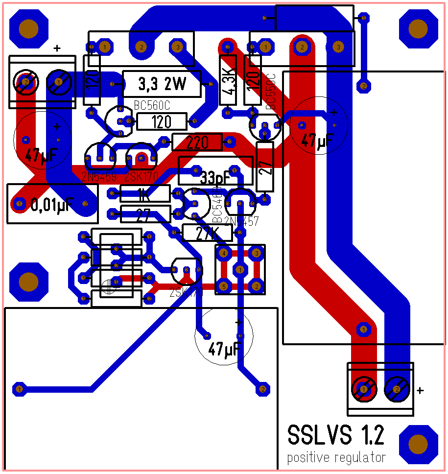

V3 is attached. Board size is 68x72mm.
I corrected the trimmer and rearranged some components for overall shorter traces. I added the option to use a electrolytic cap for C2, too.
There is one major design decision, I'm unsure with. Looking at the base of the BC546B there is a 1K and a 27 ohms resistor connected (central portion of the PCB).
I have two options here - put the pins connected to the base as close as possible to the base and increase the length of the other traces or leave it as is in the attached layout which resluts in slightly less overall trace-length.
I don't know whether the proximity of the two resistors to the base of the BC546B is as crucial as with the base stoppers on the FETs.
Additionally I was thinking whether it would be good to have another electrolytic capacitor with bypass on the Vin side. Space would be available on the pcb. Which values would you choose?

The 27R has proximity priority to the base of BC546B. The 1k should still go nearer than now. Give them 90deg rotation opposite to each other from now parallel, will be easier.
Its a good idea to have a Vin decoupler since you got the space. When rather long cables come from rectification it may help. 47uF//0.01uF.
Also make the red GND trace double width from C4 to 1 OUT.
P.S. Those C2,C3 4u7 MKP look a bit fatter than usual, or is it my idea?

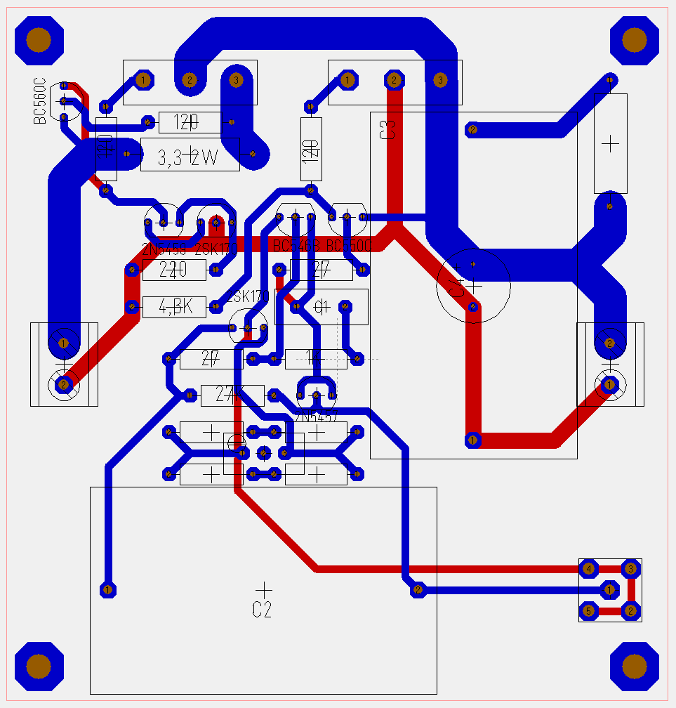

You would have to know it works fine on a prototype first. Are you going to make its negative mirror too?
When the design for the positive version is ready, I will do the negative and a bipolar version, too.
Regarding doubling the pcb trace's width, I have done so for the next iteration of the design (which I will post shortly - just some polishing and exporting), but I was actually thinking of using a ground-plane covering the complete bottom-side of the PCB which will "significantly" increase all ground "traces".
When showing the design with groundplane it is just hard to see a "real" ground path.
Or would you advise against having a ground-plane?

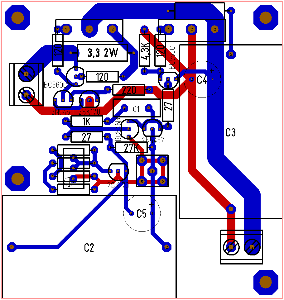

Next Iteration of the layout:
- swapped the resistors around to be very close to the base of BC546B
- added 47uF and 0.01uF decoupling
- increased the width of pcb-traces
Anything else that could use some tweaking on the latest PCB?
I'm definately not so deep into the circuit that I would know which signal pathes should be kept as short as possible and which ones could be longer...
I used MKP10 for 0.01uF and Silmic II for 47uF - better choices?!
