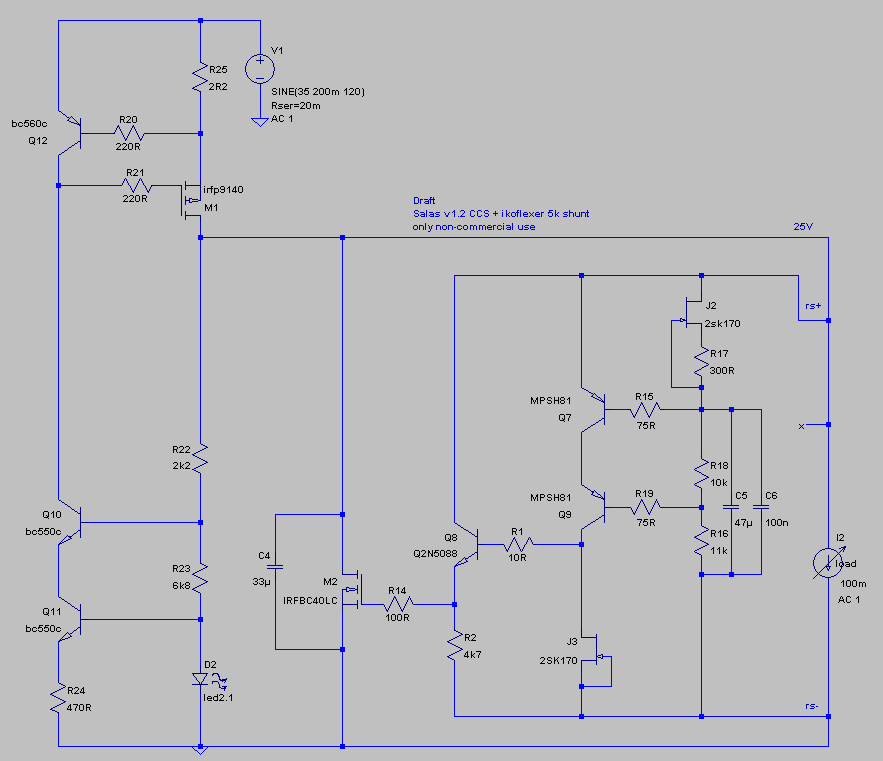

What I was saying is that if I were you, I would use the CCS from Salas v1.2, and the shunt from my 5k. It simulates well, but I haven't built it.
I'am glad to hear you again. Please let us know the schematic of your 5k shunt, better if you can draw full schematic togheter the CCS Salas V1.2 & handfull how we can reach several voltages?
Sorry, I wasn't paying attention to this thread. Here's a draft of what I had in mind. As far as I know it has never been built, so take it with a grain of salt. The usual issues should apply, good layout, etc. It simulates well.
Thanks for answer, how can do to get differents voltages, for example +45Vout, +-24Vout, +-5Vout, etc?

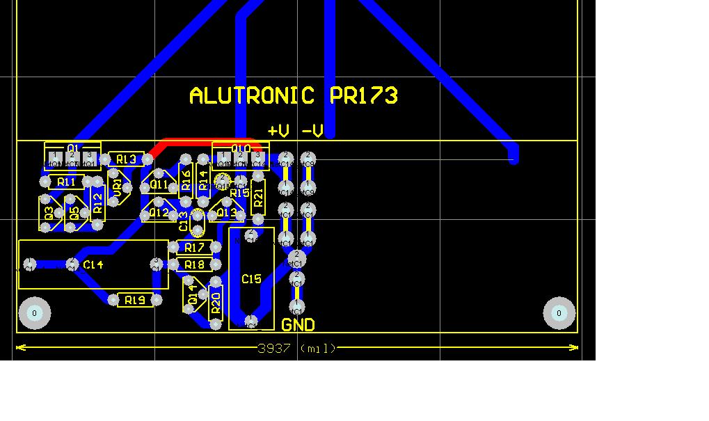

post2996,
I note that C4 is shown, as with all decoupling capacitors, at the transistor that changes current demand quickly to try to compensate for the current demands of the load.
This is where I have been placing it. But many are locating the decoupling at the load.
Can the location actually affect stability.
Is there a way to simulate the trace capacitances and inductances to show if location can produce different performance.

Hi Andrew
I have been experimenting with this output cap placement and can assure you that the location really affects stability.
In some cases, the shunt stuck on 13v. To get to the desired vout (37v) I needed to shut the power off for some seconds (3~5) and than power on again.
With a carefully chosen GND layout, the problem is now solved.
(Thanks Salas
For smaller voltage output decrease the value of R18 and R16. The current limit is set by R25. To get 45V output Q8 would have to be replaced with some higher voltage npn.
