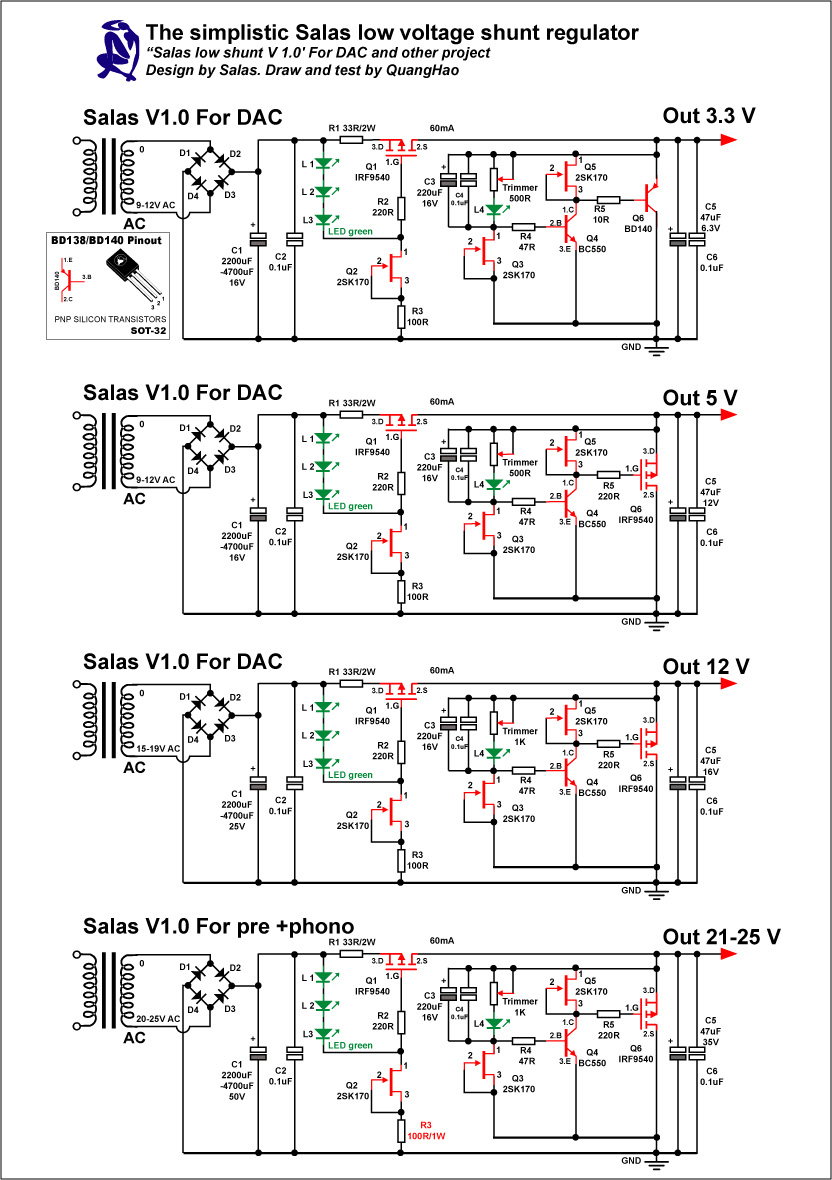

The simplistic Salas low voltage shunt regulator

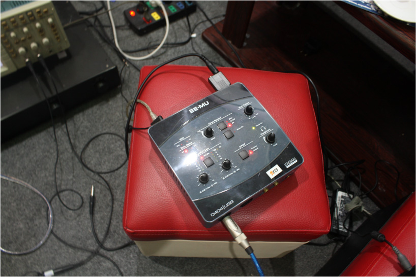

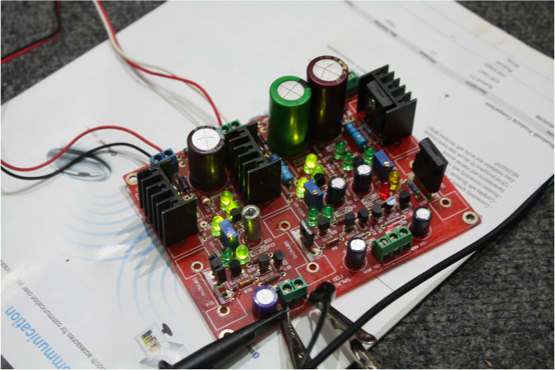

You probably mean low voltage, not SSHV. What are the conditions of measurement, what those charts represent? You capacitor coupled the DC and fed an FFT, or is it the noise floor of some audio circuit supplied by such a reg?
Yes! Salas low shunt, I mesuare at 5 v and 3.3V
I see Bd140 it the best ad 3.3v, better than Mje350
That is macsin for measure!

I recommended BD140, I know. My questions were about the method of measuring not what was measured. What your charts represent? Noise floor of the card on top chart, and AC coupled noise floor of the regs outputs below? Also what kind of current you run for the tests, because I see no sinks.

After I tested at Salas shunt voltages from 3V to 25 v. I found it great, suitable for various projects such as DAC, Clock, Pre, Phono. I sum up all in a drawing back, there's nothing wrong on the schematic hope you showed me! Thanks!
As I said before can not connect the sense with the force, you must added 2 holes for sense output + & -

Please for the new Classic Pass Labs D1 with an ESS Dac we need your design for Vin 60V & Vout 50V / 250mA could you help us?
Sorry Salas, don't need help because I see in the last schematic the Vout +-45 like the regs I'm using in my Simplistic NJFET phono RIAA only have to change for the negative rail the mosfet to IRFP140 & BC556B, finally will be two +-45Vout & one +5Vout

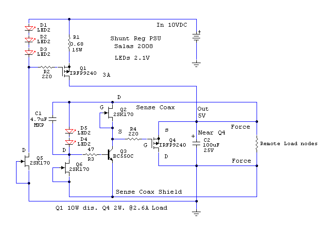

Is this pcb ok?
Hi guys!
I decided to make PCB on the Squeeze shunt regulator and I would like to know if the way it is is going to work. The markings are the same as in the scheme.
Don't want to burn anything. :redhot:
Regards Aleš

I know this has been answered before, but, this thread is pretty long...
The sense wire; it is coax, and the ground screen is attached at the shunt board, is it also attached at the load end as well?
Ken
Coax or twisted, the ground side is attached on sense pcb ground and at load ground. Pcb sense connections meet force connections only at the load.
