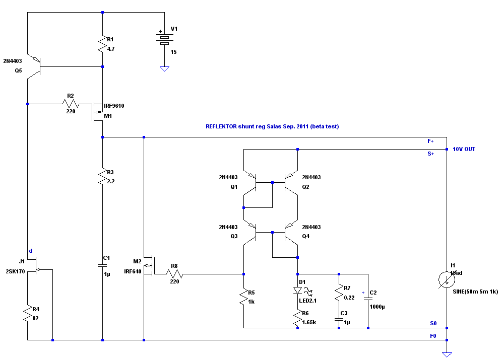

If you fancy a new test instead, there is an idea I am revisiting and studying lately. Maybe you remember a different approach I had shown once, many moons ago in one of the sadly late Babo's threads. That one only Juma took notice and implemented in his BF862 line pre. Also Onvinyl tried with success by 1.2 CCS and mirror reg marriage, soon he solved his 1.2 problems too.
But those were just the core idea, not optimized for performance. Have a look in the attached schematics to see where I am getting at. Q1,Q2,Q3,Q4 comprise the so called improved Wilson current mirror. Q1,Q2 are the heart, Q3 takes care of their base currents impact, restoring equilibrium between the system's both legs, Q4 lends same voltage across Q1, Q2 (1Vbe). Q1,Q2,Q3 need have close hfe. If Q1,Q2 also have same Vbe and temp, we are near a perfect theoretical current mirror function. Its mission is to exactly copy the reference current from its input side to its output side. Its normally used as an active load for LTP input pairs in all kind of amplifiers lending CCS high impedance action to improve gain and PSRR, and as basic building block in op amps. But what a current mirror can do for a shunt reg? Is naturally the question.

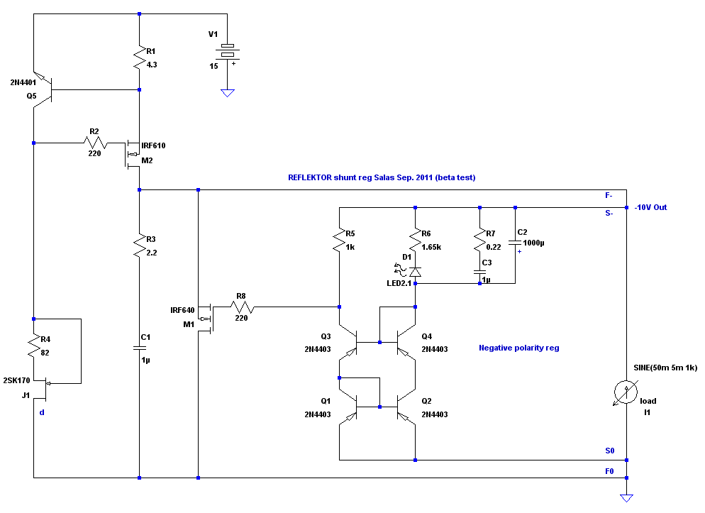

Here, R6 is on the Wilson's input side, only thing it can disturb the reference current fed through it is Vout play. Iref=(Vout-(2Vbe+VfD1))/R6 or Vout=(Iref*R6)+(2Vbe+VfD1). R6 can be a 2K trimmer in these 10V examples for your P2P DCB1. What a dynamic load demand does to a PSU? Modulates its output voltage of course. That changes the bias on R6 slightly, hence the input side reference current. Any change will be mirrored (reflected, thus I code named this reg REFLEKTOR) to the output side. R5 does I/V there and drives M2. Also sits the Wilson on Vgs potential. That Mosfet will add or subtract current on the power node, thus restoring the voltage output. A current feedback system watching the output in other words. Elegant. As for the other parts, R1 and Q5 set the CCS current by ICCS=Q5Vbe/R1. ~150mA in this example. J1 increases the CCS performance by setting its control tail current steady. Can be cascoded even with a 2SK246 or BF245B for example. Depends on max voltage by application specifics. Will not have start up problems with non optimal layout parasitics, since it does not reference to the output node. The whole system looks like giving 60dB open loop gain, also fine Zo frequency extension and stability margin on the simulator, even with strong gfs M2 types and no buffering, keeping simple. Lends to hot rod easily also. IRF640, IRF840, IRFP240 look OK for phase margin and current gain. Keep M1 low Ciss, as 9610. I will make a prototype soon to see it works OK. The other mirror regs did fine back then, so these hopefully improved and optimized ones are looking yummy to check out. Watch Q1,Q2 matching especially, face to face tied is even better. A remote sensing configuration is drawn in the examples, and it can be done 2 wire if very near to load. But you know about that from so many regs here by now. I have many cheap 2N4403 PNP low Rbb' (and low noise) BJTs that I have seen they keep a very tight hfe and Vbe as they came same batch loaded on ammo pack tape. C2 filters R6 and D1 (Vref), and must be 470uF and up, for low 1/f output noise, low VLF Zo, and bypassed as shown. ~4mA charge C2 up to Vref and lend slow start characteristic to Vout. Nice. Many low noise higher Vceo PNP transisors can be used, like BC560, 2SA1015, 2SA970 etc. or even BD140, MJE350, 2SA1381 as Vout and Q3's dissipation demands go up. The Wilson current mirror will have very good balance even with low beta BJTs and that's a plus. If Vin-5V need exceed J1's max in some higher Vo application, a BJT cascode CCS @ 2.5mA can be used instead.
Continuing on practical examples beyond your home brew point to point DCB1, by using a 2x22VAC 50Va Tx, 1A diode bridge, two 4700uF/35V filter caps, but with two green Leds (2xD1) and 5k rheostat connected trimmer R6, a +/-24V system can be made for powering Pass Burning Amp input stages with the transistor types and rest of values exactly as shown in the 10V schematics for instance.

I like the Reflektor. (No output caps and no startup issues). I also like the idea of output current sensing.
Can I use BC560 instead of 2N4403 all over ?
R7 C3 C2 are to be used all together ?
There is 1uf+2.2R output Zobel non the less. 560 yes. R7+C3=''quality'' bypass, C2 is must. Maybe a 120-220R will be needed on the PNP or NPN Q5's base in practice, but if no local oscillation in the CCS if tight layout, better not.
