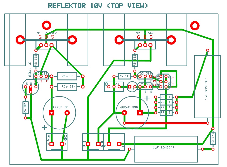

I want to have at least 220mA in the CCS so I am using 3r3 // 10r instead of 4r7 for R1.
R4 = 82r (I do not have such value so I will try 100r)
The 470u BG std on the input is good for decoupling.

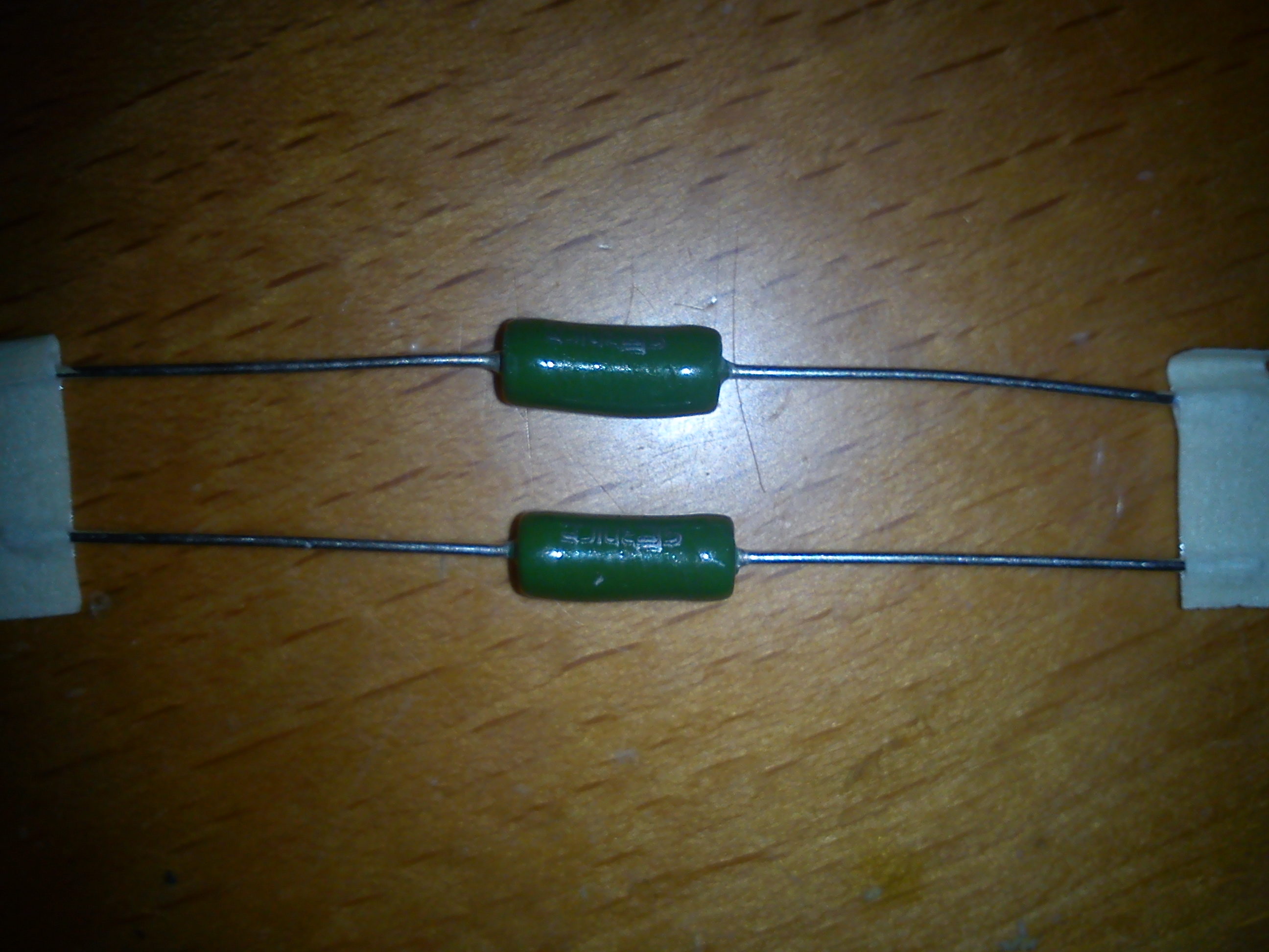

R7 (0.22r) will be done with 4 x 1r (R7 a-d)
The output zobel cap (1u) is placed on the edge of the board so I can easily replace it (I want to try 220nF FT-3)
For C2 I will try 680u BGN that I have left over.
I would apreciate your oppinions on the layout and particularly on the Mosfet connections because I am not sure I got M2 Drain and Source well connected... Does M2 Drain go to F+ ?

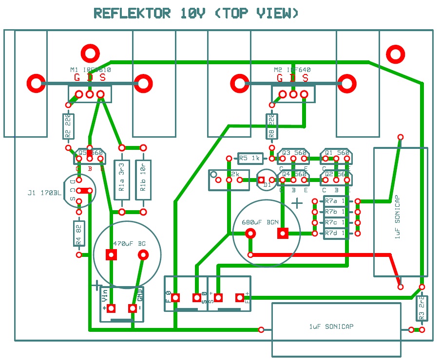

Q1,Q2 reverse so they look to each one's face so you can bond them for same temperature. See they have the best hfe & Vbe matching also.
I will do that , thanks. What type of glue should I use ? Or can I use thermal compound and fix them with termal sleeve ?
Can I use metal film 220r for gate stoppers or should I go for CF ?
Is R3 2.2r determinant or can I use 1r8 ?
Gate stoppers MF OK, worked with other regs with comparable gain and frequency too. Have some space in case a base stopper for Q5 is going to be needed in the end, there is some layout distance that may demand it. No glue! Thermal grease and thin tie wrap or heat shrink sleeve.
1.8R looks safe (theoretically). If it proves very stable, we can look if it will be stable with only 220nF teflon zobel cap also. But don't start with too many changes, in case it will not go well, to know where to experiment step by step.

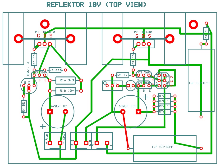

Good idea:
In this case I left place for the Q5 Base stopper (120r ?)
I compared this layout with the V1.2 and see that in that case the power mosfet has the Drain connected to F0.
In the Reflektor, the power mosfet Drain is connected to F+... Why ?
