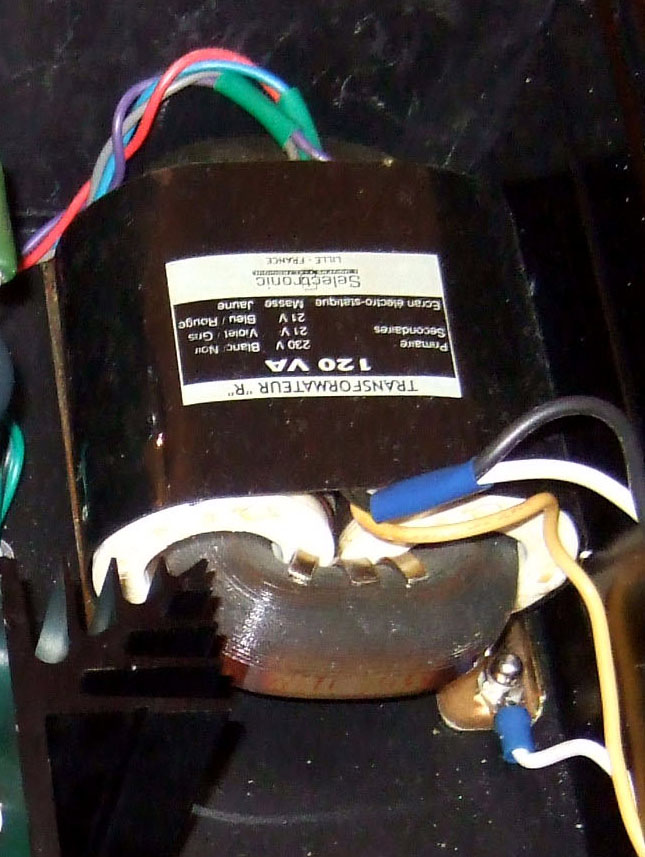

Hi Salas, I want purchase some R-core txs from Selectronic, but by the photos they are all
center tapped (they have 3 output wires).Can I divide phisically the secondary to get two
indipendent ones? ... desoldering the two wires that form the central tap?

Selectronic R-Cores transformers have writed the color codes in each transformer so don't need to do nothing.😉

............... I'm confused by the photo of 50VA, there are 3 big wires(white,yellow and black),I thinked they are the secondary ones, and 4 little ones
that I thinked the primary ones.

A picture settles it better.

That pic clearly tells me that this Rcore has a single primary marked Black/White (Blanc/Noir) for 230Vac duty
AND
it also tells me it is NOT a 3 wire primary !!!!!!!!!!
(I can't read French upside down), but I'll guess the yellow wire is an electrostatic screen that should be connected to Chassis.
AND
finally it tells me it has dual primaries marked Violet/Green and Blue/Red, they are insulated as pairs.
The yellow primary side wire is ''Ecran electro-statique'' i.e. electrostatic screen to be grounded. I connect that to the mains earth IEC prong and from there I run a wire to chassis ground. You may see a white one bolted to the trafo's bottom right corner.

You ment Dual Secundairies AndrewT.......
