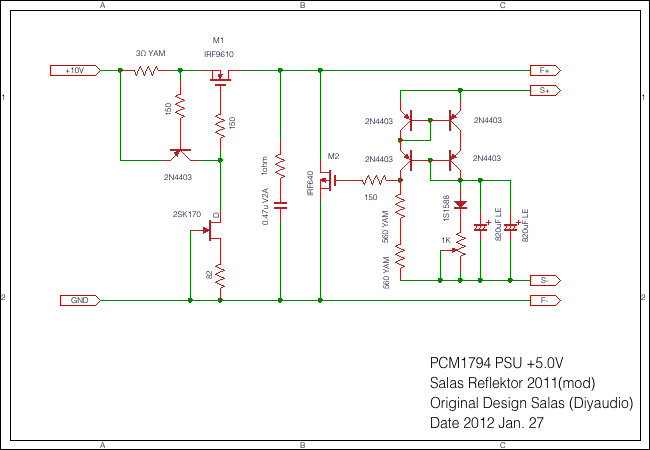

The 0.1uF decoupler is across the Zobel effectively shorting the 1 Ohm damping higher band. The small resistor you put there is a proper move that I recommend also in difficult interfacing cases. Scope it and if still not well damped a 100uF cap across the sense out wires can be of further aid.
Reflecting back to the Reflektor when I chanced on this Kon San's account in his Japanese blog. Its about a +5V one for his DAC as attached. Google translation of the parts selection and his impressions is:
"I increased 0.47uF to 0.1uF were conventional ones Zobel circuit placed in the immediate vicinity of the IRF640 which circuit (2) shunt. I made this because there is no hand in the measures listed in Diyaudio, 1uF, but it seems really good too.
Was in 8200uF × 2 of (generally from Kemi Sun) 10000uF conventional electrolytic capacitor that is connected in parallel with the semi-fixed resistor and 1KΩ 1S1588 that make up the reference voltage (3). In the LE series of Nichicon, which is similar to what is referred to as Sanyo (Panasonic) and OS configuration.

* So he found 047uF a better choice for the output zobel (my choice too)
** Does he use 2 x 8200uF (16400uF) for vref ? I did not go so far but found that the reflektor is uF ungry in the vref area also

Also found that to be true: "1) to 3 ohms resistance provided for entire current constant current circuits from conventional 5.2, increasing the current.
This is already listed in the Diyaudio measures, and the reported system began singing in the increase of the current. "

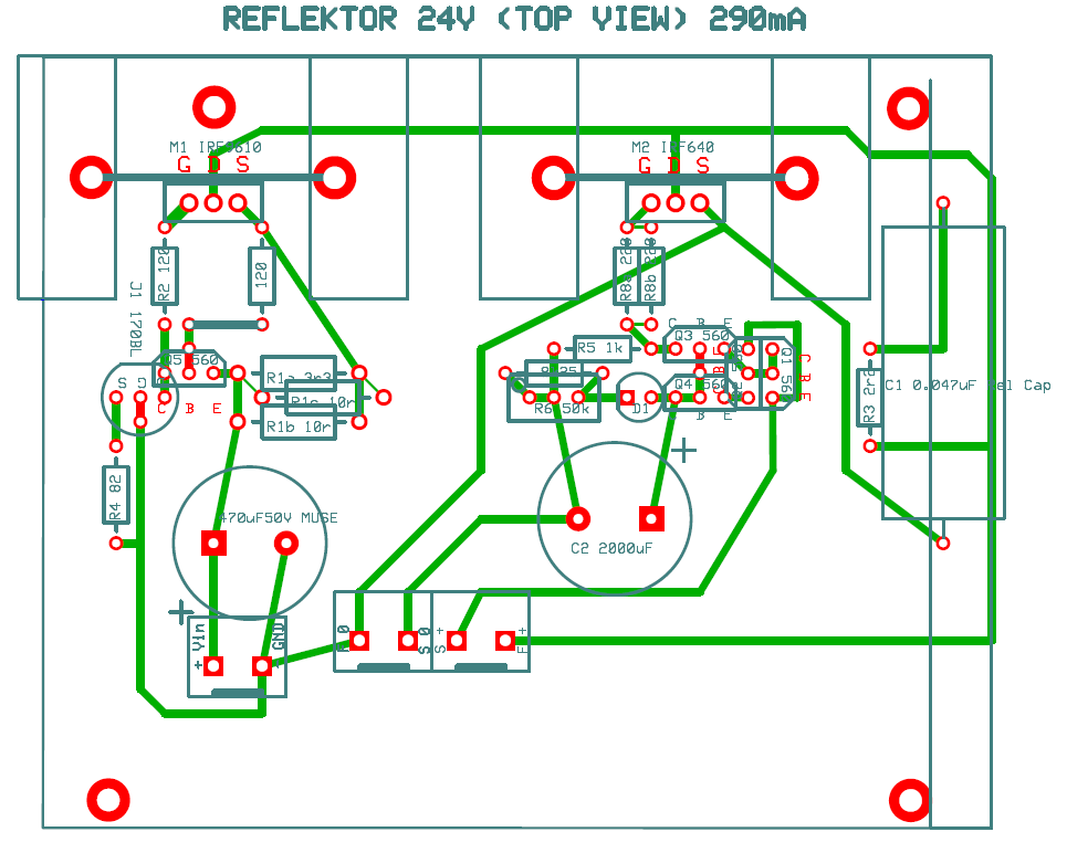

Yes there is. Only that was the beta test post, has some differentiated stopper resistor values, zobel values, that we experimented on subjectively later. Maybe you could follow Cruz and Kon suggestions. The input should be decoupled to ground with 0.1uF to 1uF if the rectification and filtering is wire connected and not integrated. Around the input CCS must be tight layout and add a base stopper that's missing from the original post schema. Vin must be no less than 5V higher than Vout in worse mains conditions, better have 7V or more margin.
Thanks Salas
Nothing much, let us know if you will try it. There was a bypass Zobel parallel to Vref cap (R3,C7) that was found not adding anything perceptibly better so skip that too.
Ta da! Mystery solved, found the Nichicon LE datasheet. Those are a solid Alu series in low voltage that don't come bigger than 1500uF. Not bigger than 820uF at 6.3V J code type anyway. So its 2x 820uF as in Kon's schema, the text has a typo.
