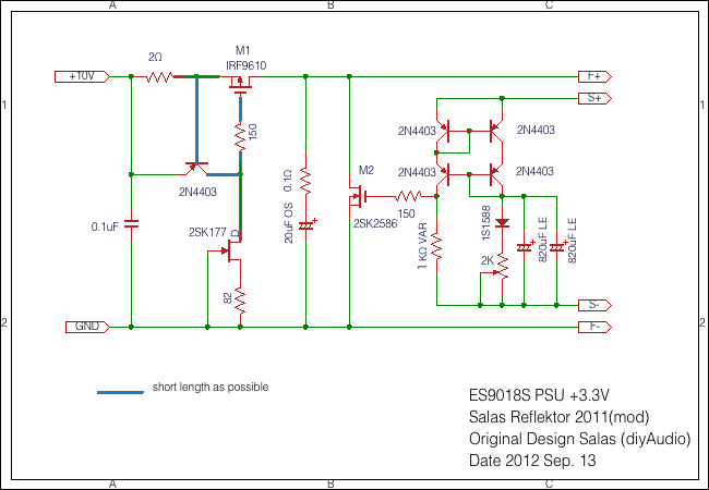

Its the Vgs barrier of the output Mosfet and the Vbe additions of the mirror transistors. When running a high power Mosfet at 200-300mA its Vgs is sleeping enough and it can get you near 5V when compromising the mirror for voltage, that is why I recommended 7V floor, to have room. With low Vgs TTL Mosfets things change for margins.
Hi Salas, asking the same question Phisci asked. I'd like to use the REFLEKTOR for my pcm63 dacs. How would I get the voltage to 5V? Or is it just a matter of building the Japanese version? Or could one actually use a reg after like 7805?
Ok.. it needs a 7 V floor... I use 10v floor... but it can work outputting 5v, you just need to input 5 + 7 = 12v to have enough headroom right ?

Vin-Vo is another story than VoMin, follow the normal practice with such regs. No less than 5V Vin-Vo not to goof up the CCS, 10V projecting for good measure against Tx & mains tolerance. Although you may find that this class of regs can regulate very near to Vin=Vo (one Vbe dif) the CCS will lose steam.
Kazuo-san used that Mosfet type to go 3.3V he certainly tested those values in his schema. If he will post he will explain further I suppose but he already mentioned that a quad of those regs are @ work in his latest Sabre DAC build.
P.S. Kazuo-san may post to discuss it & clear the assumptions?
The Sabre DAC seems to be working well for me. But I have only poor oscilloscope. It is possible that I can not observe osc.
When I move the position of the reg. board, it may sometimes oscillate obviously.
Honestly saying, I have no confidence the value of Zobel. I would like to wait for diyer's suggestions.

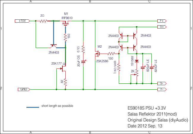

Attaching is the latest version.
