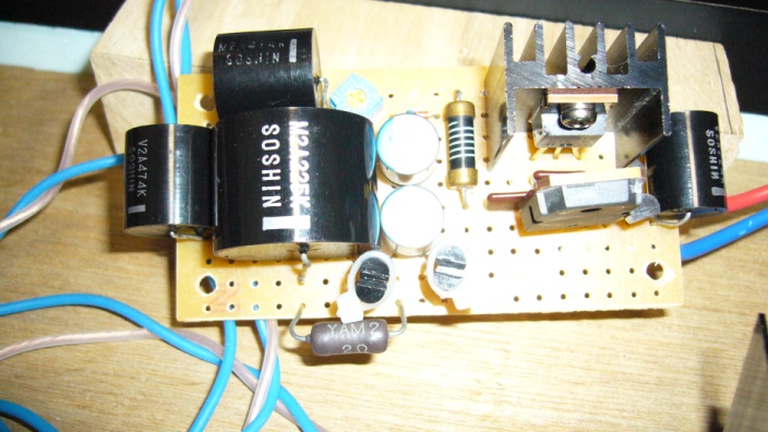

I made prototype Reflektor suggested by Salas.
Zobel value is changed from 0.1ohm+20uF to 2.2ohm+(2.2uF+0.47uF+0.47uF).
I use four Reflektors, so I replaced one of them that is connecting SI5317(Jitter Cleaner).
I am not good to explain impression of sound in English, but I say that it becomes more musical than before:D
Thanks again Salas. Your contribution is great.
Next step I will change three other Reflektors.

I replaced all Reflektors and I got the used oscilloscope Tektronix TDS350 (200MHz, 2ch). I have been evaluating on these few weeks.
Sound becomes changed drastically. Bass and mid are clear, smooth, deep.

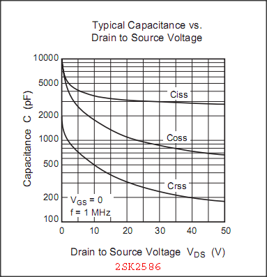

But I find one serius problrem. Treble is harsh. Although I changed Zobel C (2.3uF, 3.8uF), no effect. I guess that the cause may be big Cxxx of 2SK2586 in low Vds area as Salas mentioned.
Of course, I have observed that it does not oscillate.
From these result I am convinced that we are going in the right direction, but I must explore other low Cxxx MOS FET. Now I am purchasing some MOS FET from DigiKey.

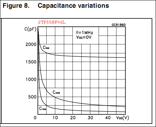

Low Vgs Mosfets like the 2SK2586 Renesas you used to go under 5V reg normally have very high transconductance but high capacitance always comes with it. Congrats on getting a good scope, it will prove very valuable. The fact that you saw its stable plus it sounds good on all regions except HF points to suspecting the Mosfet's capacitance, yes.
See another low Vgs Mosfet example (they call them TTL level some times). This is STP55NF06L from ST Micro. Yours is 2V Vgs(th), this one is 1.7V. Looks better for capacitance. Pay special attention to Crss for this application when choosing candidates to test. Maybe you will find more ideal. Thanks for replying about the NOS Japan parts.

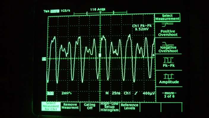

I have to correct the previous report.
The attached photo shows that my regulator is oscillating.(Vertical X10) :ashamed: First I thought that it was normal fluctuations.
Salas. I was searching low Cxxx MOS FET. The device you propose is the best as far as I found out. Now I am purchasing STP55NF06L. I will report later.

~50ns period, that is very high. 20MHZ. Also low in amplitude. Can it relate to any clock fundamental or harmonic since you use them for digital? Anyway put 0.1R at the +side on the DAC's particular power feed point and see if that waveform damps away.
diyAudio Chief Moderator
Joined 2002
This is very high a frequency, if it is just a matter of moving it maybe you need shielded coax and/or to shorten/redress the wires loop. Or to dampen it as I mentioned. Maybe your new Mosfet with less capacitance will make it less sensitive, but it may very well be it just picks something over the wires so try to address that as it is made now. I see much loose wiring in #5326 as it is in test configuration now. In any account make sure that when the whole configuration is assembled as a final system the layout is economical for wire loops and there are no waveforms.
