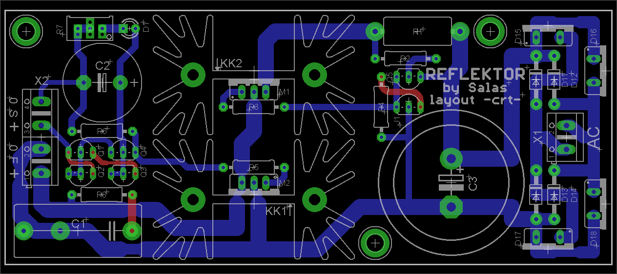

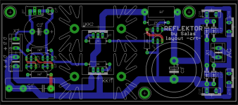

P.S. Hey where are some pics?
diyAudio Chief Moderator
Joined 2002
I have got double layer with on board rectification and filtering. Maybe you can follow some ideas from it though. If you will have your raw DC part on a different board add a decoupling capacitor across the reg's board input.
Joined 2002
Very important. Remember you burn total CCS current times (Vin-Vout) on M1. You burn Vout times (totalCCScurrent-loadcurrent) on M2. Do the power calculations for any setting conditions in each app you got in mind and estimate thermals and sinks.
