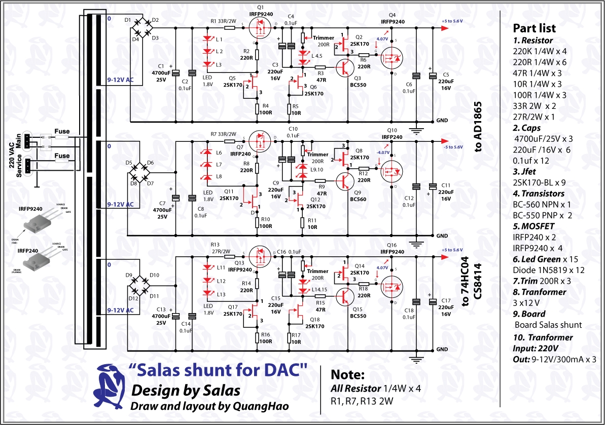

Why the use of double diodes in the bridge?
On the PCB design there is position for MUR120 diodes or MUR8x0 diodes. Use one or the other, depends on designed load current.
Well, If your shunt is designed for 3.3A then yes, the resistor should have 0.3ohm. The voltage dropped over this resistor should be around 1V
It's valid for all Salas shunt regulators?

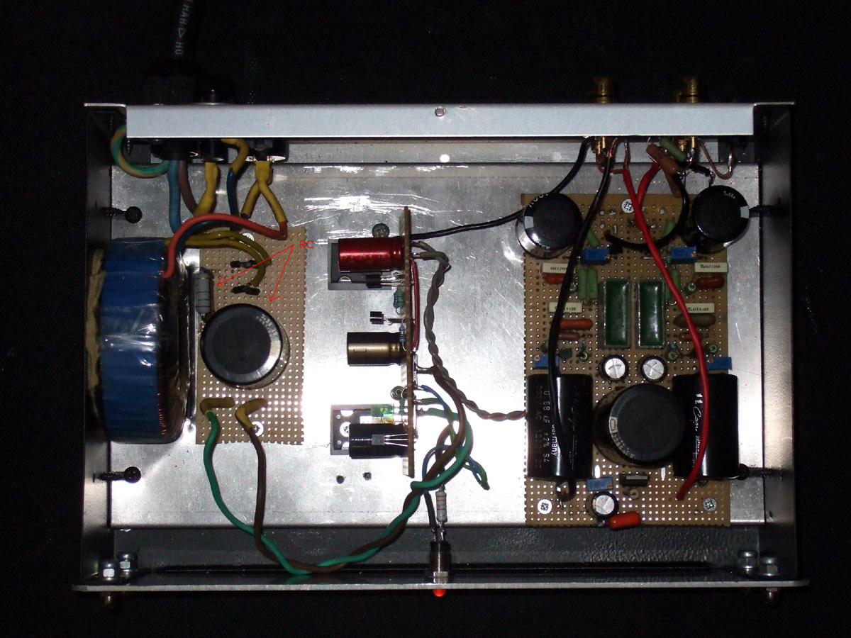

My attempt at a PCB for 5v Reflektor. Thanks for the help SALAS.
I should add that I inserted C1 as additional smoothing post rectification. If used, I'll obviously have to connect the + terminal.
Also, will be adding heatsinks for the mosfets.
Any comments?

I assume you mean for the IRF9610 gate. Its the resistor I've labelled 150R2?
That on is near, talking the IRF940 one. You named it 150R3.
Quick question. I've built the shunt reg pictured in the first schematic in the picture below using one of dvb-projekts PCBs. C3 and C5 are listed as being 220uF. Would it be OK to use 330uF caps for those positions instead? I have a pair of 330uF/35v Rubycon ZLHs I found in the parts box here. If not suitable I'll order some 220uF types instead.
Thanks.
