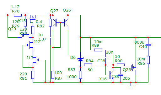

Also, what about this schematic? Its like an reflektor+one bjt, higher gain? How about it?
Just use one of your lower measuring GR without any drop idss resistor if you can't readily get say a BF245A or 2SK30Y 2N5457 etc.
The schematic is a basic reflektor hybrid with a CFP, it may oscillate on you terribly or it may not, I can't comment expertly on something not made yet. You may make it and let us know. Some day I will test the REFLEKTOR X idea I have in mind for about a month now for more theoretical performance with less parts than that. If it will work stably and I find it really adds subjectively too then it will only pass. Both demands are difficult.
