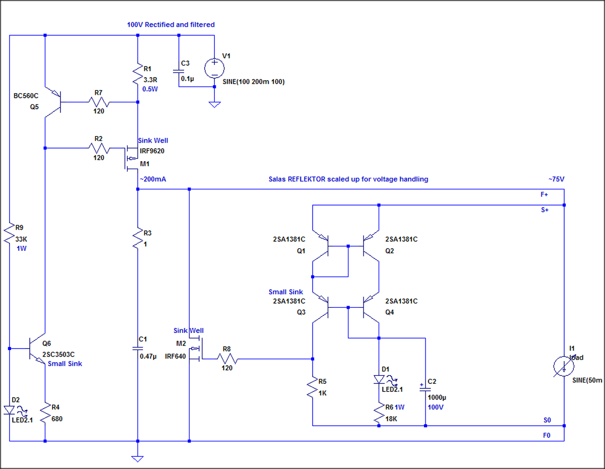

Can you recommend MOSFETS and transistors for a 100Vin, 75Vout?
Then also for a 75Vin 38Vout?
Can we use 2sk170 in these as well?
This config should do theoretically. For 75Vin & 38Vout R9 should be 24K, R6 8.8K, C2 50V. For 75Vout R6 can't be a trimmer reliably, for 38V a 0.5W trimmer will not suffer initially but better not for long term. FAIRCHILD KSA1381/KSC3503 can be found in large stockists, prefer ESTU hfe grade. Its power inefficient to use shunt regs with such constant current over load demand allowances in those voltages, watch your thermal planning and M1,M2 sinking.
Only BJT output version there is for V1 and 1.1, the CCS is still Mosfet. I recommend full Mosfet if looking for 5V and up. 1.1 guide you can find in "SSLV 1.1 builds and fairy tales" thread, post#1

Salas, in the REFLEKTOR, just to confirm:
1. that the CCS current is (2N4403)Vbe/R1?
2. And this should be = load current plus shunt current
3. The dissipation on 9610 mosfet is (Vin-Vout)*(CCS current)
4. The dissipation on 640 mosfet is (Vout)*(CCS current-Load current)
Thus when adjusting the Reflektor for different optinal currents, the best way would be to change R1?
Your help much appreciated.
