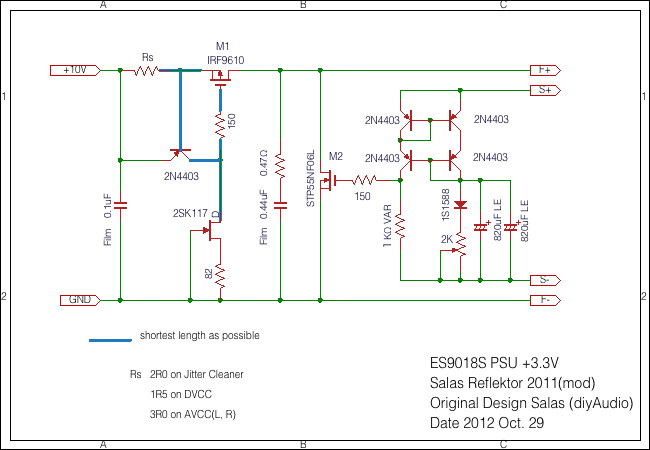

Zobel of Reflektor +3.3V
1R 0.47u is quite different to listen to for instance. If stable on the scope as the other, you can see where it goes, if there is something to gain or lose in lower values or to stay where it was. Like a recognition shot.
After long journey I reached the goal to serch for Zobel of Reflektor +3.3V.
The story is following.(Of course no oscillation on all cases)
1) 2R2+2.2uF
Not bad, no harsh, but sound dim.
2) 2R2+0.22uF
Become brilliant, but harsh.
3) 0R47+0.22uF
Become decent, but still a little harsh.
4) 0R47+0.44uF(0.22u//0.22u)
Become great deep sound, no more harsh.:)
I also guess that it is very good for 1R0+0.47u as Salas recommends.
On this experiment I found a few principles about Zobel.
1 Zobel is strongly related to quality of sound.
2 If Zobel is not been optimized, sound become harsh or dim.
3 The optimal value is between the narrower area than I expected.
Next step, I build Reflektor +1.2V. If I get good result, will report.
Best regard
