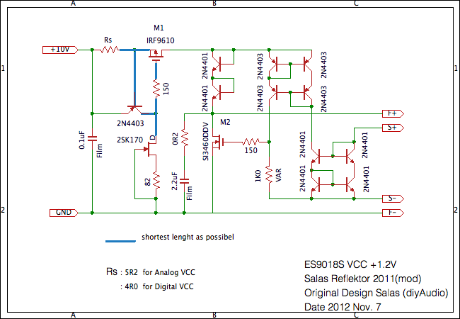

Reflektor +1.2V
I have been evaluated in a few days, and decided to optimize Zobel.
Old; 0R47+0.44uF New; 0R2+2.2uF
As a result the sound became more smooth, transparent without stress. Space is fully filled with music. Of course it is stable strongly. I am satisfied.
Now I noticed on one principle foolishly.
In the Bode chart, if Zobel is optimized rightly, the gain and phase of output are changing smoothly beyond audio frequency zone.
Salas, is it correct?

diyAudio Chief Moderator
Joined 2002
Yes its true. Still it has to do with possible load oddities too. So there is safer general termination or optimized. You could end up to something bit different in another DAC for instance. Checking stability with your scope is the first testing principle when making changes as you have mentioned.
Joined 2006
In my experiments with the reflekor I also found 2uF better than 0.47u in the output zobel.... Of course I was powering a simplistic and not a DAC so results are system dependent.

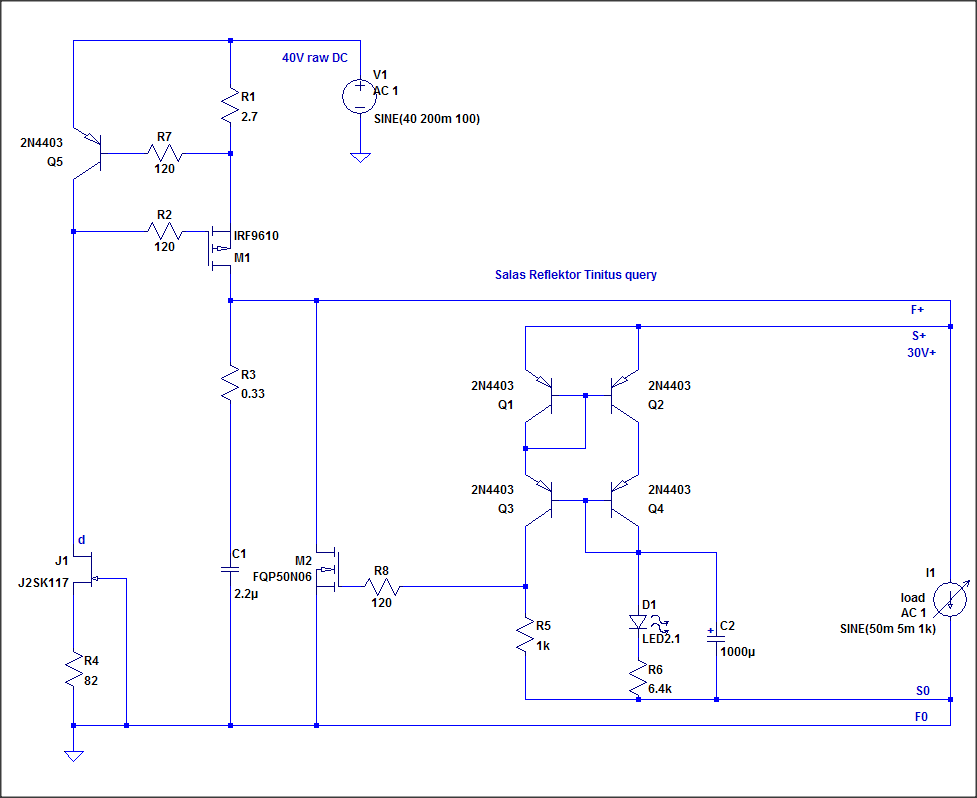

I wonder if it's possible to use the salas regulator as a filament dc supply.
What's available is 7.5v ac and that is supposed to end up as
4,75-5,25v dc @1,8A.
Is this possible and how much ac ripple is there to be expected at the output ?
It has been done for heaters using a basic V1 special with low Vbe power BJT output by member disco for a #26 preamp down to 1.5V.
