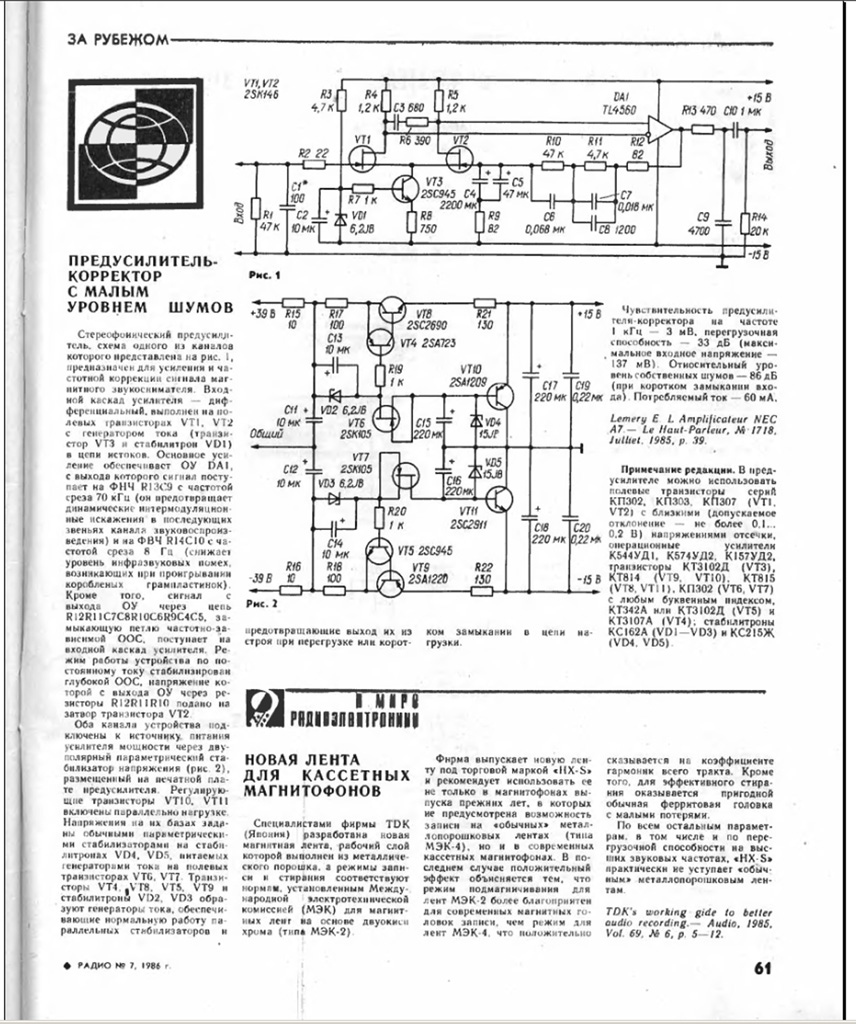

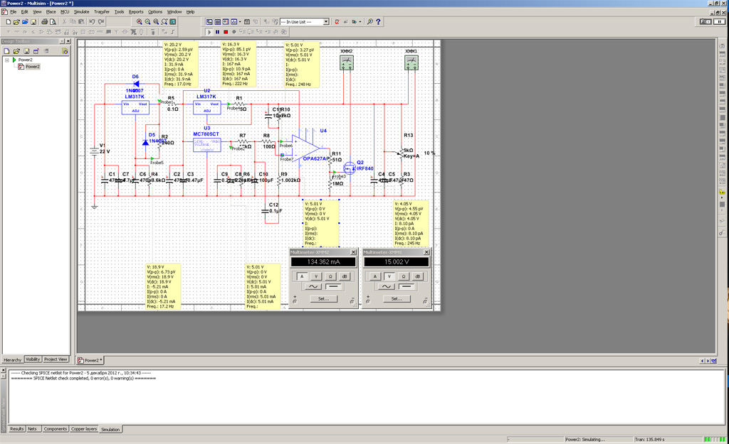

This is one more variant of scheme.
Salas
Similar schemes is used for HI-FI audio in Russia.
Left LM317 is used as a parametric (sequential) stabilizator with low noise, additional R5 - 0.1 Ohm, manual change C6 - 470 uF, additional C2 - 470uF, C3 - 0.47 uF .
Right LM317 is used as a current source (current generator) about ~170 mA.
OP AMP and n-MOSFET is used as a parallel stabilizator, max ~150-160 mA is stabilized.
MC7805 is a stabilized high quality voltage source with capacotors filter on out of chip.
R1 must be 6.8 Ohm - 10 Ohm, 2 Watts.
Salas
Transistors VT4, VT8 and VT5, VT10 are the current source (current generator).
Transistors VT10, VT11 are parallel (shunt) stabilizator (regulator).
VD4, VD5 are the parametric (sequential) stabilizator for VT10, VT11.
VT6, VT7 are current source (current generator) for parametric (sequential) stabilizator on VD4, VD5.
VD2, VD3 Zener 6.2V, VD4, VD5 Zener 15V .
Stabilized voltage +-15V, max current is about ~60-100 mA.
