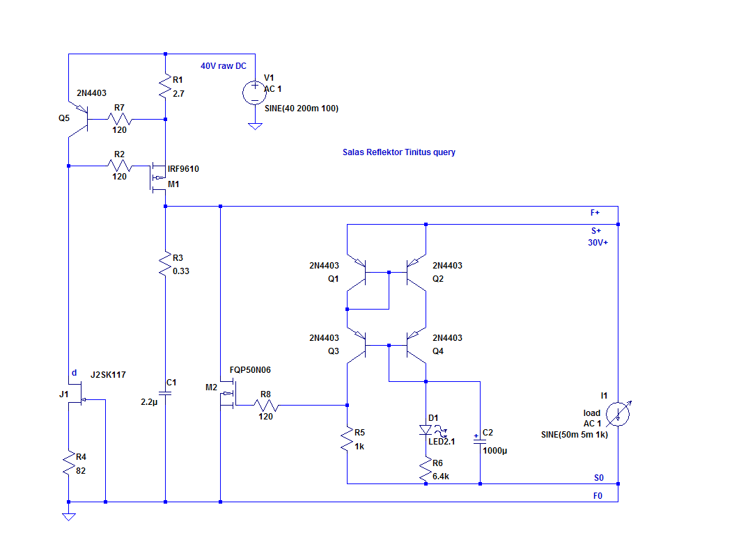

Salas, I have question
looking at ordering parts for the Reflektor reg
is voltage too high to use 2sk170 instead of 2sk117 ?
diyAudio Chief Moderator
Joined 2002
The JFET is going to have about 35V across in your case. K170 has 40V max. Make R4 120R if it will be a BL range to save the JFET some dissipation. I prefer the K117 for it being less capacitive and 50V rated. But both can do, except than in the odd input over-voltage of course.
