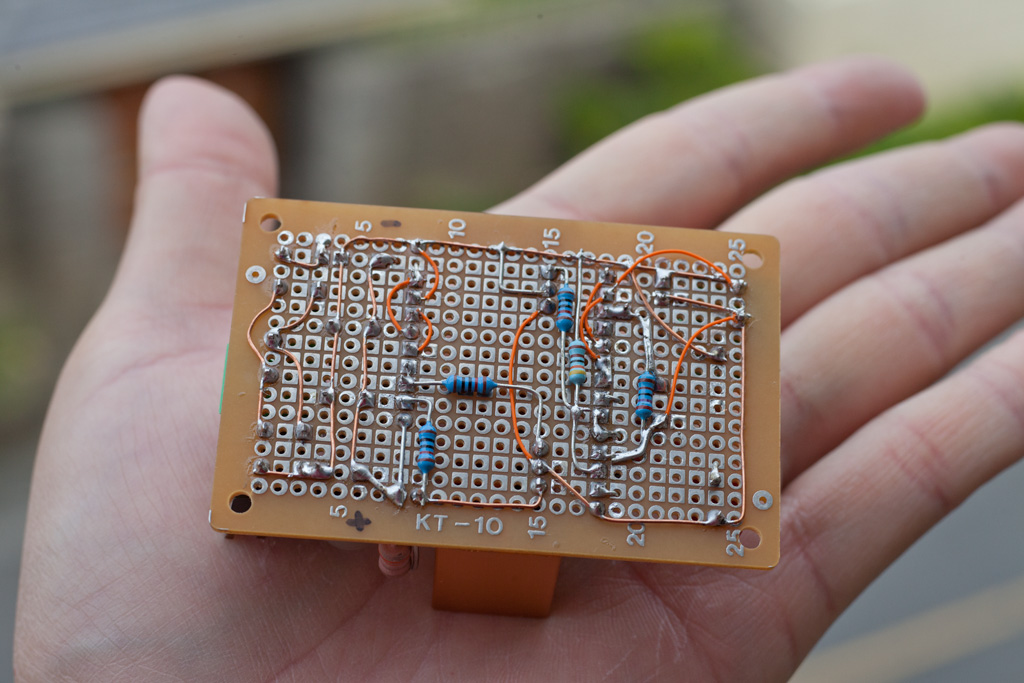

The 1.2R could be very compact. Here is my result.
As you can see, the heat sinks occupy many of the space. I chose larger ones to sustain up to 600ma current draw in total (12vin/5vout). At 600ma, the heat sinks are "very" hot, but it's been running for weeks without problem. BTW, the red WIMAs are 4.7uf MKS2.
![salas12rf.jpg](/community/proxy.php?image=http%3A%2F%2Fkspqm.kymco.com%2Fckfinder%2Fresource%2Fjohnny%2Fimage%2Fsalas12rf.jpg&hash=932176fd893c59109eb666548cac3f1c)
![salas12rb.jpg](/community/proxy.php?image=http%3A%2F%2Fkspqm.kymco.com%2Fckfinder%2Fresource%2Fjohnny%2Fimage%2Fsalas12rb.jpg&hash=164412ea31bcf903cf58d686d89900a4)
Hi Salas,
Yes, it includes 4 HFA08TB60 and filter caps. The output cap is OSCON 47uf/16v, and it's stable under my scope. By the way, the zobel network is very important. At first, I put an OSCON 4.7uf there, but after I replaced it with 4.7uf WIMA MKS2, the sound has dramatic improvement. With limited space, it seems the WIMA MKS2 (MKS4 maybe?) is my only choice.
