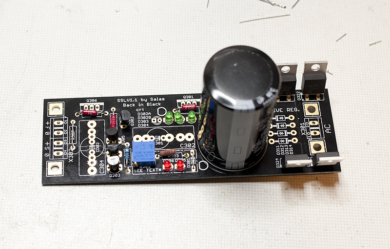

I am also building an 8V BiB @500mA to try with my Shigaclone
Reference R is 300R + 1K pot aiming for ~1K
Filter and zobel will be electrolytic as per the guide (220 and 47 uF)
The CSS R will be 2R, the main filter cap will be 10000uF and the diodes are MUR860.
Oh and I just noticed that I need to short D302B
Any thoughts taking into consideration the weird load that the ShigaClone will be? Digital+motors....?
Is there any reason to use a 22000uF cap ?

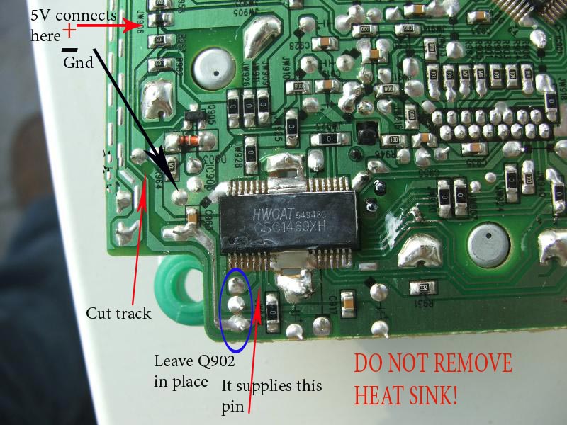

I don't have Shigaclone, but I heard it can be powered separately. 5V for digital + 8V for motor.
This photo is not mine. If there is issue, I will remove it.
Although Salas's regulator performs excellently, I don't recommend it for CD motor. Too much heat. You can power the digital 5V by Salas's and use a LM317T or LT1085 for motor.

canvas the Shigaclone on its current incarnation can take up to 4 separate PSUs and this is something that I would love to check at some point.
About the heat, the psu will be on a separate case so no problem there.
To be precise, the laser pickup can be powered separately (5V+8V). Others, of course, can be powered as much as you can. My transporter is based on SONY CXD2500 & CXA1372, and I am planning to to do the same thing. Perhaps 2 PSUs for CXD2500 and another for CXA1372. BTW, I think it's overkill to have Salas's regulator for motor.
