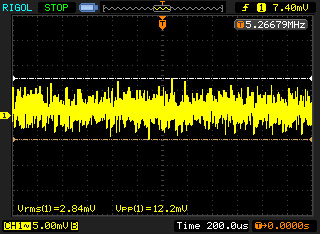

My WaveIO board is running with this config. and seems to be good.
Can you take a scope picture of its output on dummy load resistor for nominal WaveIO current at 10nS/2mV div and shortest probe ground fixture possible? I want to observe something, thanks.

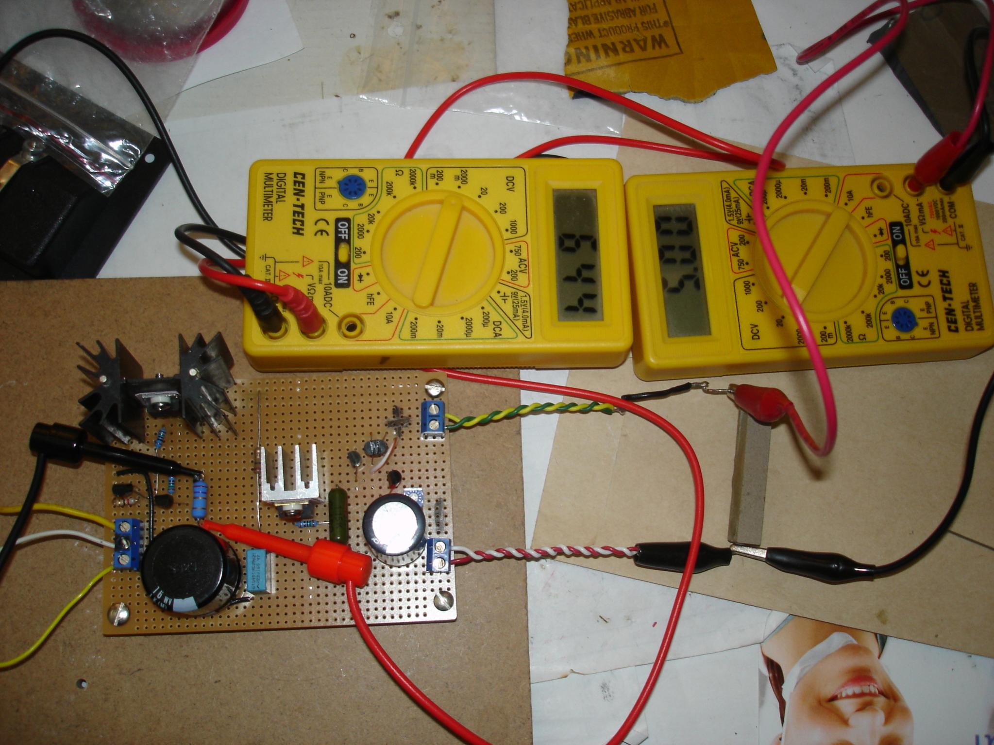

Lookie lookie, my first reflector powered up, and a little adjustment at the pot, it was dead on 5V, so happyThanks, Salas, off to heating up the soldering iron now
It is going to be fun to explore !!
Right said Fred.Lookie lookie, my first reflector powered up, and a little adjustment at the pot, it was dead on 5V, so happyWill swap out the Bib with this later for a comparision.
OK, however would you give me a time of a few days? because my business is busy

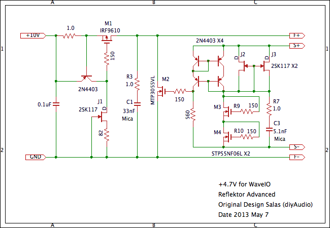

I'm glad you've improved the reflektor. I am planning to try the new version. However, I don't have STP55NF06L at hand. Can I still use MTP3055VL as M3?
Thank you for having you be interested in this circuit
Simulation says MTP3055VL is not good, because the output impedance does not go lower sufficiently. However spice model is not real world. It may be worthy to try.
But I recommend STP55NF06L at present.

Improved Reflektor is going on experimentation, having both merits and demerits. I will plan to change some config.

You will need a 4th LED on top left so to have some margin for easier R1 values since the Vgs is going to be higher in the current region you aim at. You gonna need a 6th LED in the middle for 12V. You use red 1.9V Vf LEDS. You may skip R4 & R5. On the positive one change the connection of Q6's gate for going to ground instead of D pin. Going to D is a Mez DCB1 specific trick only. For circa 4.3A CCS you gonna need 0.56R R1 (ballpark). That resistor is gonna dissipate ~10W(!) so use a sinkable one. Maybe a Caddock.

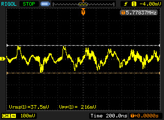

Niko I have added a 47uF cap at the output of the BiB right on the Shigaclone PCB entrance and noise has dropped to about 10mV
But hitting auto gives me this...
It is not detectable with shigaclone off
Can you please advise? Do I have to worry about this?
