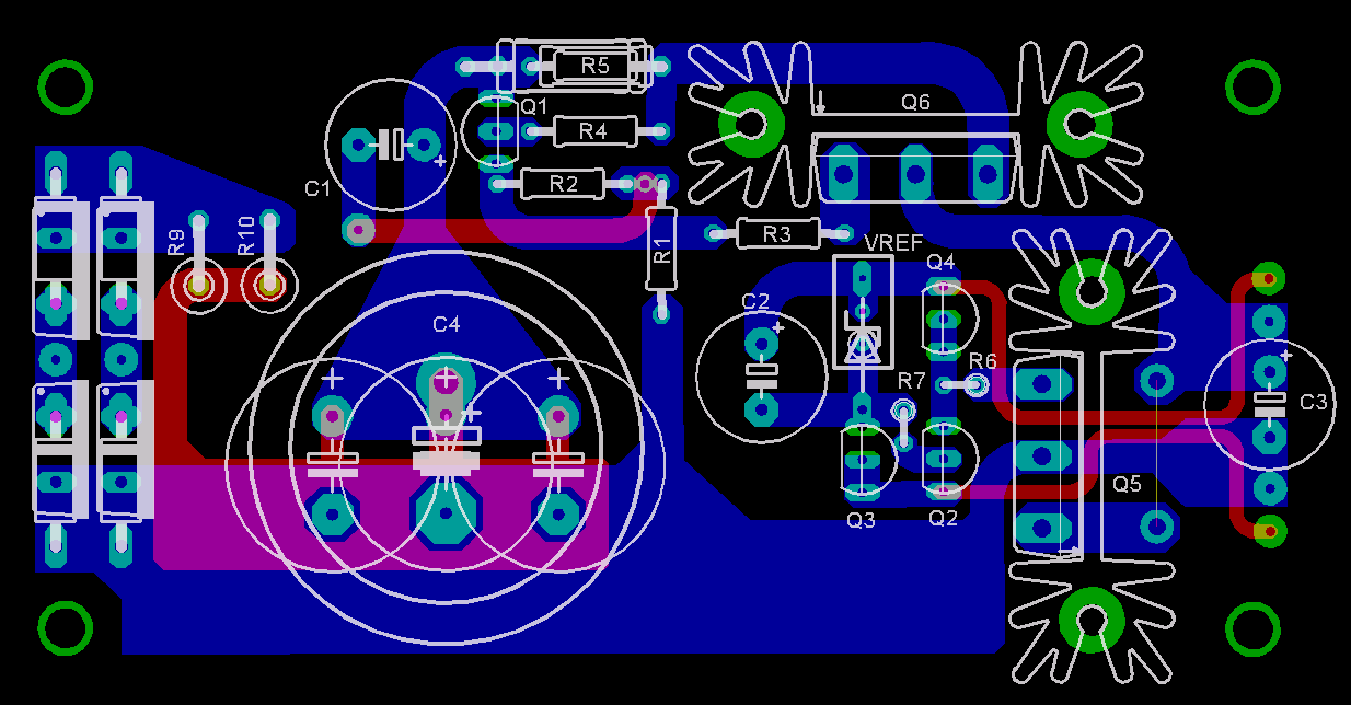

No, that's now wrong.
It was the pair of joined leads that was wrong in the pic. (look at some other datasheets to see the pic error).
The gate and the way it exits near the Source lead was correct.
You now have them upside down.
They are both Pch devices and the drain goes to -ve side.
The gate and source should both be towards the +ve side.
It's the pic that was drawn incorrectly by the software supplier.

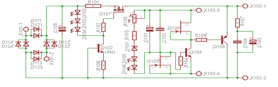

Q102 is 2SK117,is it connected correct in schematic?
Drain -1
gate -2
source -3
Is it source that connect to R108?
Like this
Jesper.
Yes, Source and Gate to R108Q102 is 2SK117,is it connected correct in schematic?
Drain -1
gate -2
source -3
Drain to R102

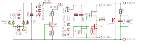

i built another pair using irfp9240 this time, using this schematic.
one of them acts differently than all the other ones i've built- when turned off, the output led dims out before the ccs leds, where as all the other ones have ccs leds (the 3 string red leds) dim out first. all other behaviors of the 'abnormal' one seems ok, though.
where can i measure voltages to make sure it's working properly?
