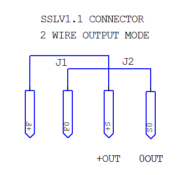

Also skip the Kelvin 4wire output mode that the SSLV offers. Make it two wire conventional mode which is more immune to electromagnetic interference for long cable runs. It keeps the voltage sensing loop area contained to the regulator's PCB only. See my attachment on how to do that by adding short insulated wire links soldered under the board at the pads of its output connector pins.
Since it will be serving as a remotely located PSU to the main unit which has extra DC circuitry between its power input and its pre-pre circuit, there are no direct nodes of interest to sense anyway.
