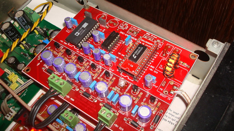

Nice board !

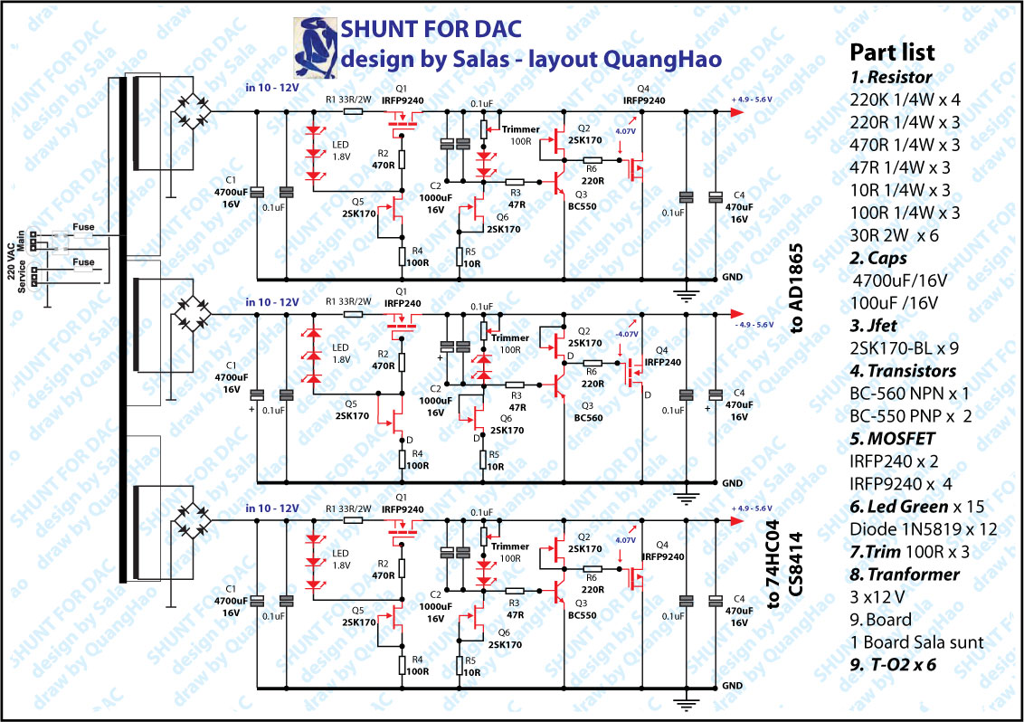

Would you please post a schematic that goes with the board so we can all follow your work ?

Ok! you can see some image my friend make with Salas shunt low!
thank

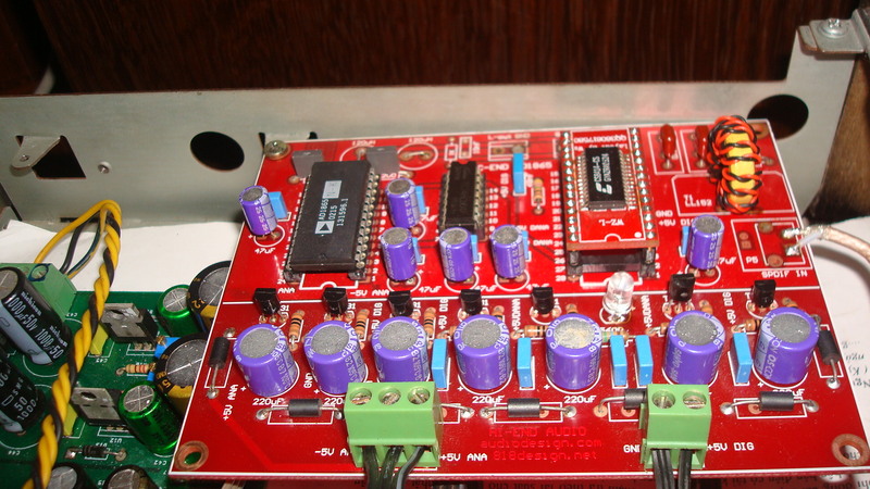

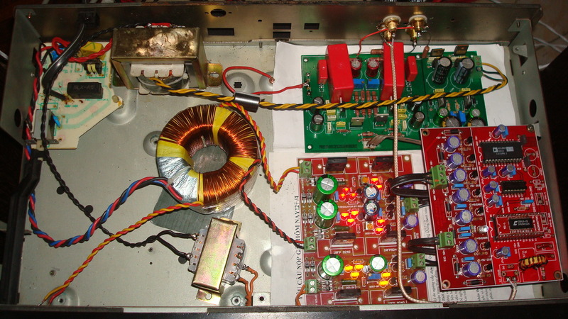

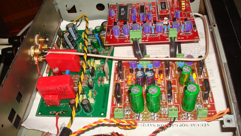

Quanghao, tell your friend to reduce the lentgh of the black cables connecting the shunt board to the Dac pcb to the bare minimum. Those cables must be very short if you want to get fully advantage of the very low output impedance of the power supply.

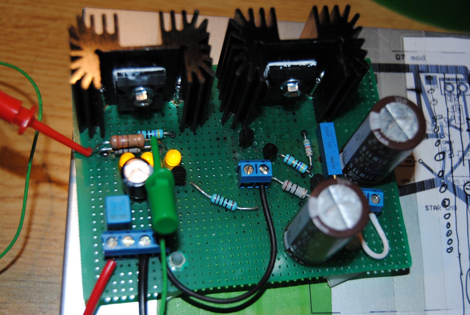

My measurements are 8.39r on R1, 1.99Vdrop on R1 so I calculated 0.237A... but measuring the current flow in the shunt input I get 0.25A.....All this without loading.
How can I explain the current diferences ?
