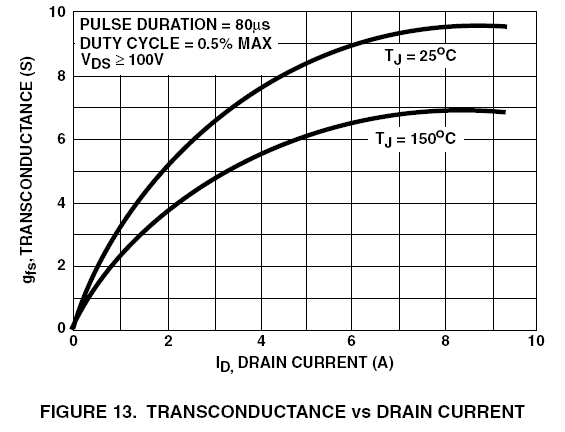

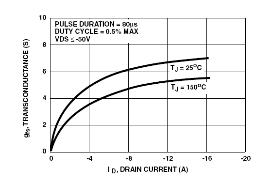

See the two graphs. One is for IRFP9240 the other for IRF9610. Normally someone says, choose the smaller faster Mosfet for a shunt that will serve a phono or line circuit. Me I say from the start the heavy one does better. Why? More gm. Slower? OK drive it with a buffer, if the bandwidth helps certain audio circuits. Ricardo see how the 9240 takes off around 0.2-0.25A. Then again at 3A. That is what you hear. Iko, maybe yours is more equal around those currents?

I was surprised because I know your riaa doesn't have wild current variations, so one would think that low output impedance isn't really important. But I trust you guys, if you hear the difference, it means it's there. salas, you make a good point about the transconductance. My using the irfbc40 is a nice compromise between low capacitance and good transconductance
At 2A and 25C it shows just a bit over 5S. Not bad, eh?
Now I look at the curves better, I see that up to 1A that we use them and especially around 200-300mA, the 9240 was a very nice choice for being in my drawer and accessible in all downtown shops all the time. Cool. I use 9140 now. Even better for such common a part. Ooops! Ricardo is off to the shop still wearing his pyjamas.
You're right, the 9240 is a great choice. The irfbc40 I got initially for testing only, because they were so cheap that I could buy a hundred for the price of eight 9240. But they seem to fit my requirements in many ways. They're nice to use in the high voltage version just as well. In retrospect it seems I lucked out on them. I looked again trying to find a better mosfet for what I want to do, but couldn't find it, except in some 2sk parts, which are very difficult to find and expensive.
I haven't seen the IRFBC40 in local shops. Its good NMOSFET indeed. Very good for the Simplistic HV too I would guess. Depletion they don't stock here too. But to tell you the truth I don't like Depletion cascodes much because there is not much feedback between them due to the close voltage. An IRFBC40 CCS open at 5-6V and governed with a cascode tail would take 600V and maybe do better with more Gm even, don't you think?
