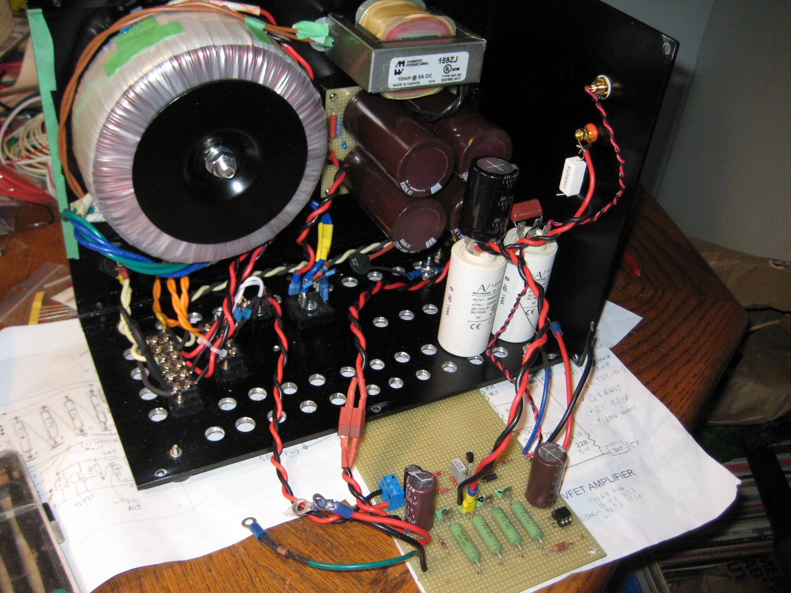

As bypass of the output cap, is something like https://www.amazon.com/TEMCo-Motor-Capacitor-RC0096-100-Electric/dp/B01A5ZGUR6 appropriate?
I used motor run caps as input coupling and output coupling/bypass caps in my version of the amp. I used 10uF Kemet in both cases. The amps sound great. Maybe boutique caps might sound better or maybe not, but it's not worth worrying about. It's diy.

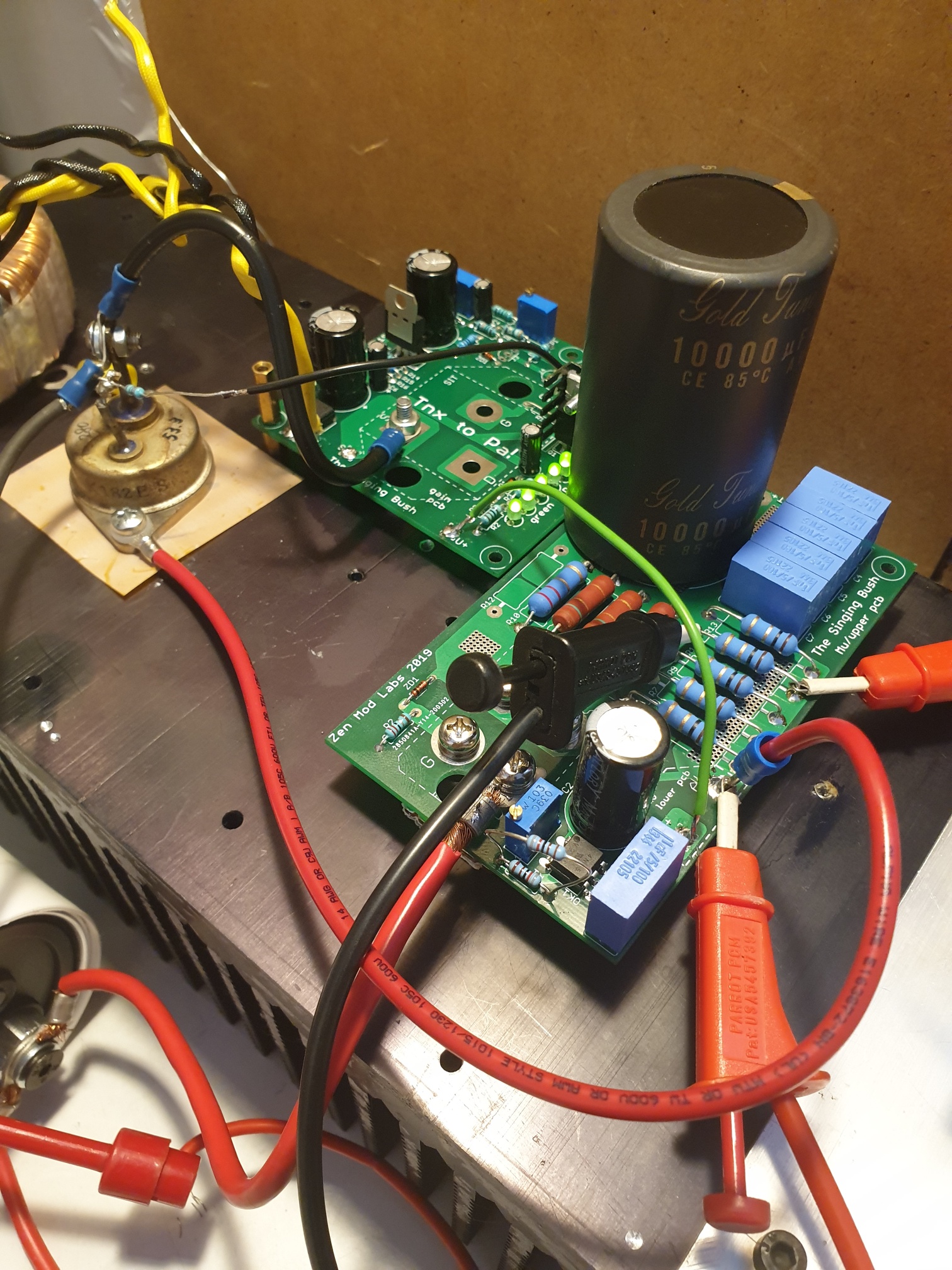

output node is at 35V(ish) and you can't increase Iq?
which pucks you're using?
same situation in both channels?
anyway - do not change 8K2 ....... set trimpot to have approx 10K ( together with 8K2) then slightly increase R3(100R)
you can try step by step with standard values (120R,150R, 180R) or you can put trimpot there connected as variable resistor (mid pin soldered with one outer)
say that 500R is handy value, start from 0R then slowly increase, carefuuuuuuly
interesting, first case of mosfet being lazy .......
If they increase to 35 V, the Iq drops a little below 2A.
That's why I set it to 32 V and the bias is around 2.1A.
I didn't have patience and I put another 8K2 resistance on R1.
Bias increased to 2.75A. I even auditioned, it sounds great!
Until I have a single channel connected to the radiator.
OK, I'll go back to the initial 8K2 resistance and change R3.
