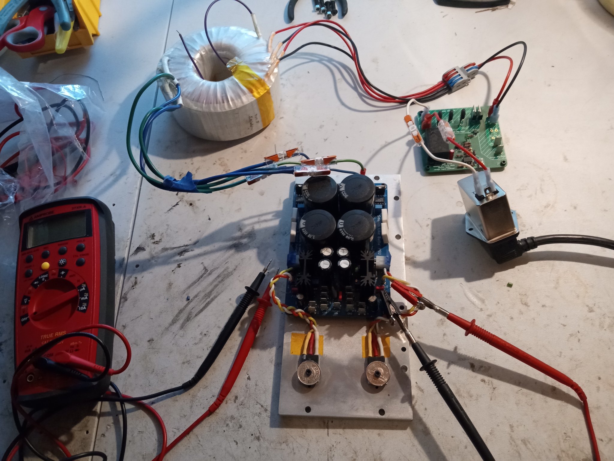

Sorry for misunderstanding.
I'm trying to remember, but I do recall testing my setup with the SLB without a load, and other than the output voltage being a little high (since there wasn't a load), I was able to verify the voltage rails being around +/- 25 to +/- 28V (I had an 800VA Toroidy which has rather good regulation on its own). The reason I did that was to make sure I had connected the BJT's in the capacitance multiplier properly. That's where most builders have trouble, especially with the Molex connectors. I used the knob on my variac to adjust the mains voltage while monitoring the output of the SLB and measured the variability in the DC voltage as expected. That's how I verified that everything was working as expected.
The SLB is basically: Active rectifier -> CRC supply -> capacitance multiplier (with a pot at the end to adjust ripple).
Can you post a picture of your setup starting from Variac to mains IEC to SFP (softstart) to Transformer Primary to Transformer Secondary to SLB?
If you really want to set the pot on the SLB accurately, you want to do it with the actual load along with an oscilloscope looking at the output of the SLB to adjust the pot to the lowest ripple value. That pretty much necessitates a fully built amplifier and would be a last step/tweak to final testing.
But for now, I would double check to make sure your connections are correct for:
Variac to mains IEC to SFP (softstart) to Transformer Primary to Transformer Secondary to SLB.
Best,
Anand.

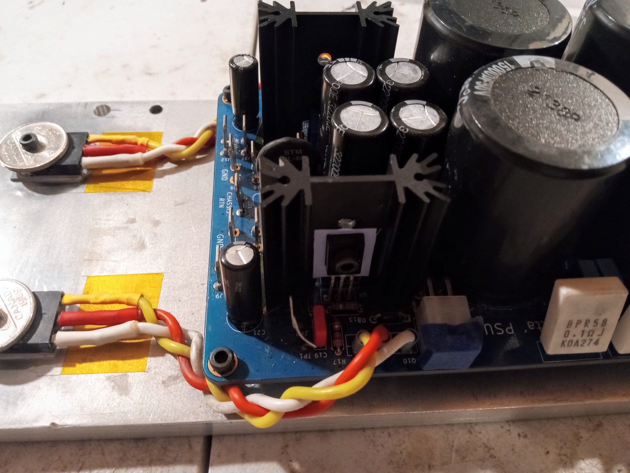

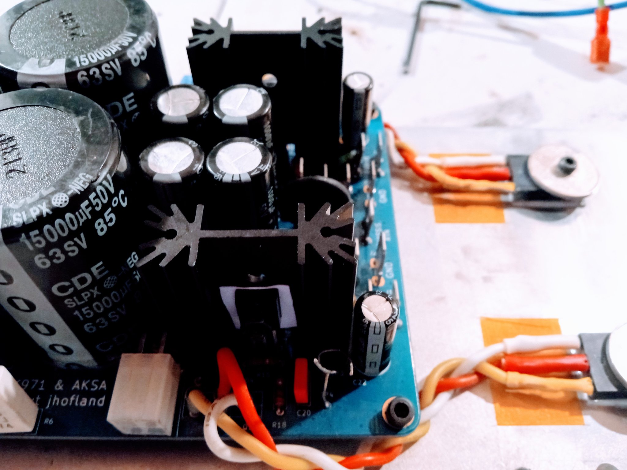

Greetings,
I had to solder up a new U2 on my SFP and I was not satisfied with the continuity i was getting from the SLB molex boxes to the molex boxes on the BJT helper boards. I changed to soldered ends. I have checked continuity and all is solid.
I think I am ready to apply some power and would like to know if anyone see's something amiss in the pic attached.
One question: Since I have the BJT legs shrink wrapped already, can I attach probes to the appropriate pins in the molex box's (shown with blue tape across open end) to measure the V between the emitter /collector of the BJT's.
MM

You can, just ensure you don't accidentally have the DMM lead probes slip causing a short.One question: Since I have the BJT legs shrink wrapped already, can I attach probes to the appropriate pins in the molex box's (shown with blue tape across open end) to measure the V between the emitter /collector of the BJT's.
Best,
Anand.

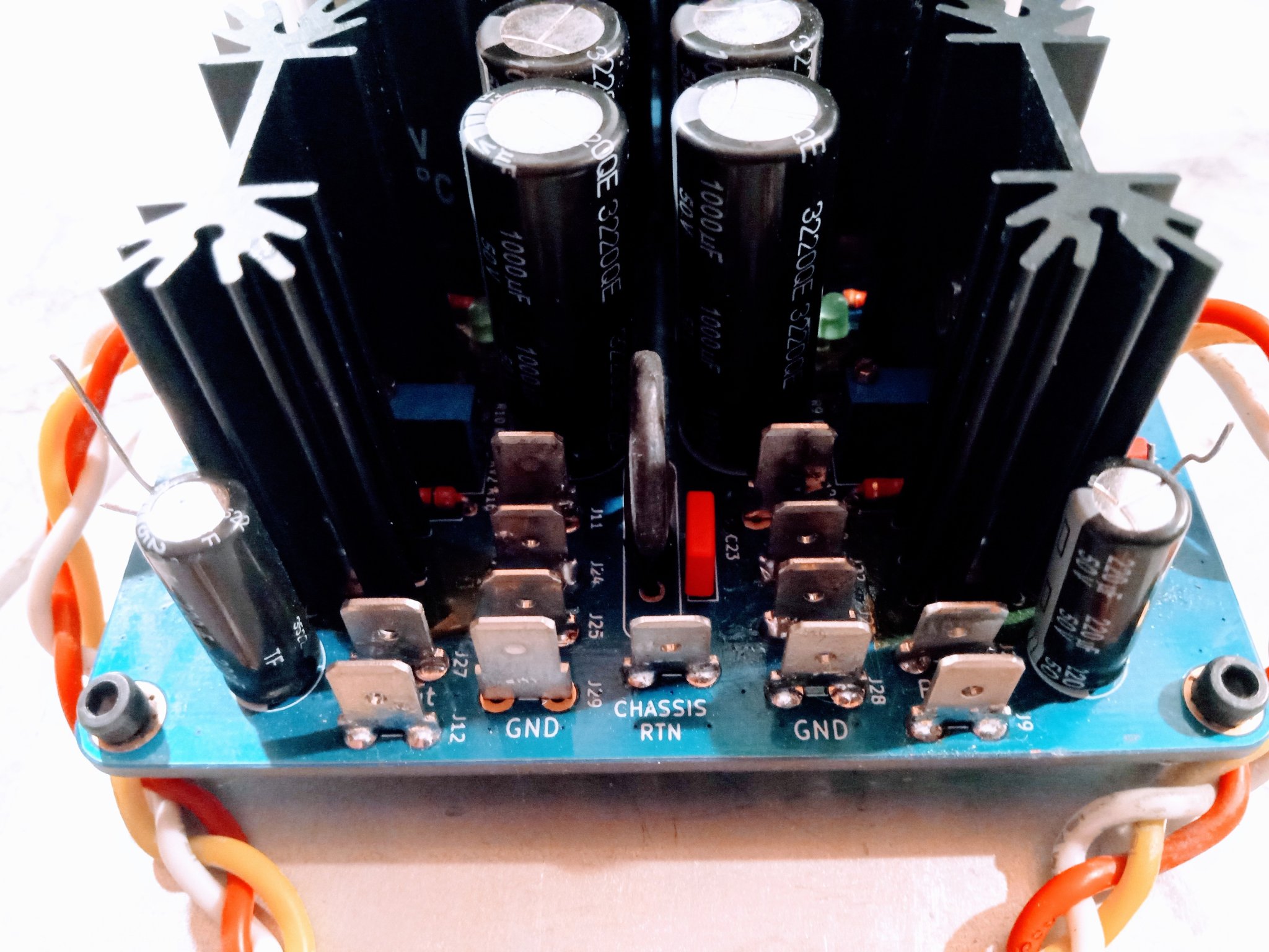

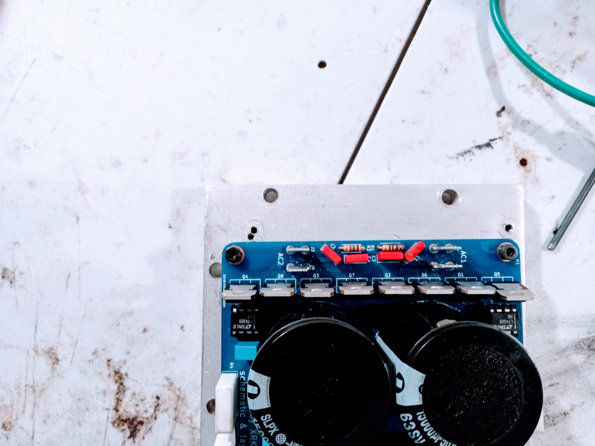

Well not as much luck with the 2nd SLB. When I powered up with the Variac & DBT, I was only able to get to 40V on the variac and the lightbulb was glowing. I shut it down and then just tested the negative side and all I got was -2.36V on the output. The led's did not light.
Not quite sure if I know what is blocking the voltage or what to look for. I have attached a few pic's.
Thanks for any suggestions that would help me out.
MM
![SLB5.jpg SLB5.jpg](https://www.diyaudio.com/community/data/attachments/1232/1232998-0bc9e940e22d308a28f07a6281c324c6.jpg)
- So what I did was confirm that the transformers were OK. Tested each secondary at 24V on the Antek 4224, so no problems with power to the psu.
- I compared the working SLB with the Non working one, looking at all the components and each resistor to confirm the same. I could not see anything out of place.
- I compared the transistors on the heatsinks and all have the wide flange on the heatsink (123/ECB), so should be correct. The BJT's are all hooked up the same and wired correctly.
- I tested the the 2 green led's with a DMM and they both tested and lit.
MM

Anand,
Since SLB1 tested successfully with the DBT in place, I did not remove it from the test circuit when testing SLB2, the one with problems.
The DBT is glowing brightly when only 40V applied. No smoke or weird pops, click's etc, Just no voltage getting to the output.
I will start by checking/reflowing suspicious solder joints. If this does work, then I will ask for some help with taking some voltage measurements to try and pinpoint the problem.
I have not soldered the heatsinks to the board as I was waiting until after power up to see if any problems. This seemed OK on the successful test of SLB1.
MM
MM
