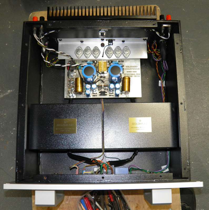

Take a look at the heatsinks on Mimesis 3:
No way that would survive 140 mA 60V (witch is the supply voltage for mimesis 3)

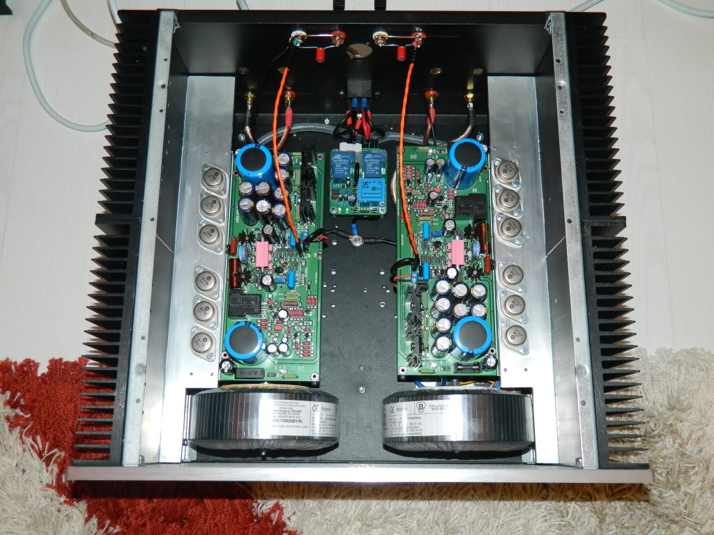

Let me share my own thoughts as well.
Firstly I'm very thankful to Nikos for assisting me(through PM 😀) to set my amp to different bias
After listening to different bias which needs me to adjust the DC offset as well, the higher the bias the higher the DC offset, this is my observation to my amp:
My conclusion is to stick to the original what Nagys recommendation. If I made it High bias I'm loosing the control of the bass at the same time soundstage and dynamic is not that good to my ears.
With the original bias I can feel the separation of the instruments the bass is totally in control and the vocals are really detailed.
Again this is my observation and I admit I'm not an audiophile in any aspect but I know if the amp I'm listening is good or bad 😉.

So here is the original Mimesis 9.2 that is the basis of Nagys design.
+/- 80V supply....😱
And agian look at the heatsinks. They are small!
140 Ma ... They will not survive long, and If I know Goldmund original amolifiers, NONE of them were hot when running.

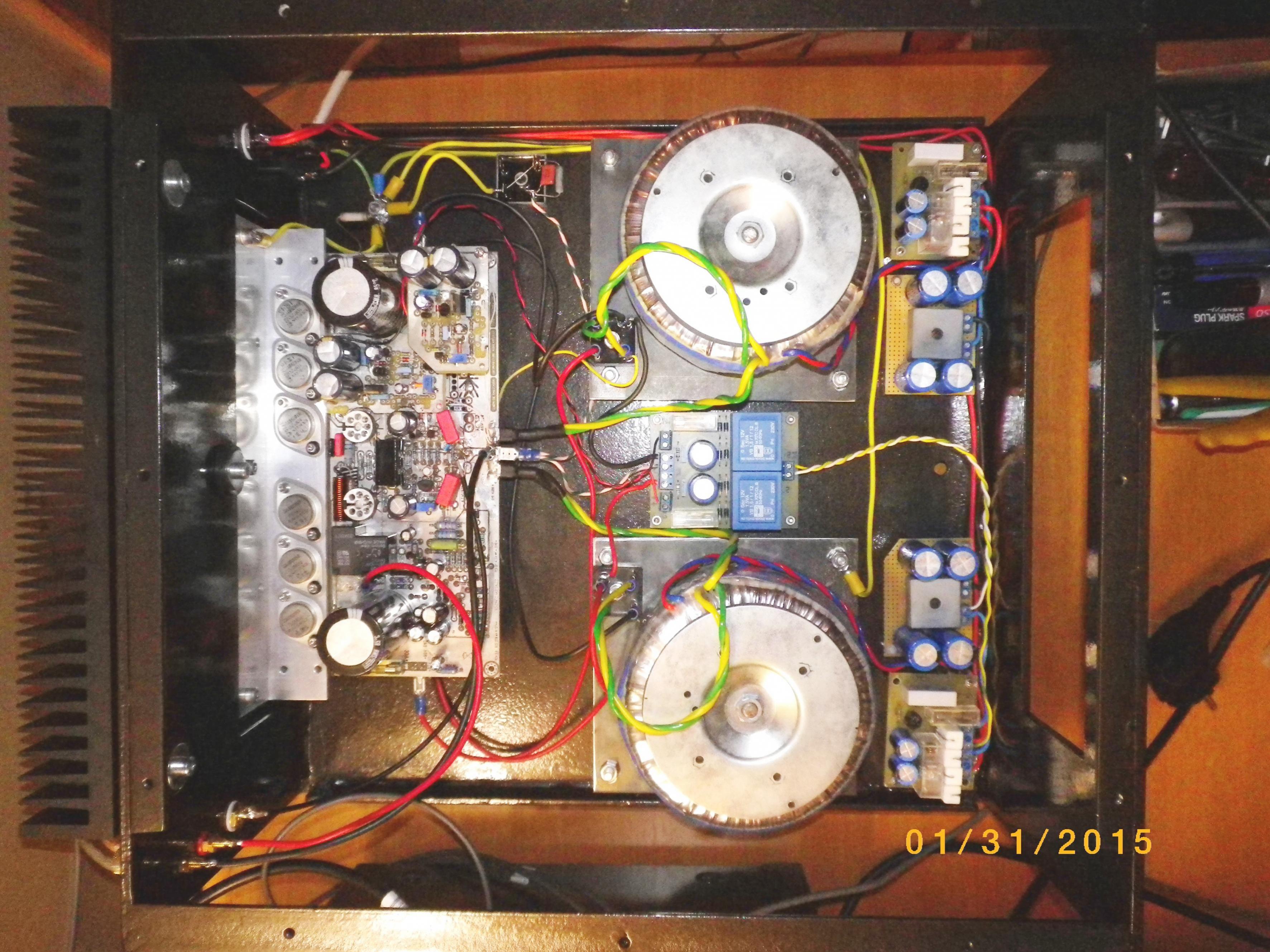

Ηι Κoldby
i have the same heatsink 300mm 200mm 40mm yes its small for 145 ma
For the history i have made some small mods
i change the zener 6,2V
i run the Vas at 5.0 ma per side very stable ,i have turn the legs and all are face to face and with caught clip, and my Mpsa 93-43 now runs at 52-56 C, before mods they run at 6,8 ma 65-68 C really really hot .Thats why the Junie have offset the Vas MPSA are not in caught clip. Now the offset is very very very stable
i change R20 with 470Ω at 70-115ma per mosfet .
