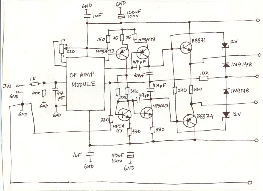

Now I want to use separate power and VAS, looking for a schema...
Thank you!
That confirms that Goldmund are using feedback to reduce errors in a high distortion amplifier.
Everybody here knows that one should design for low distortion before applying high feedback.

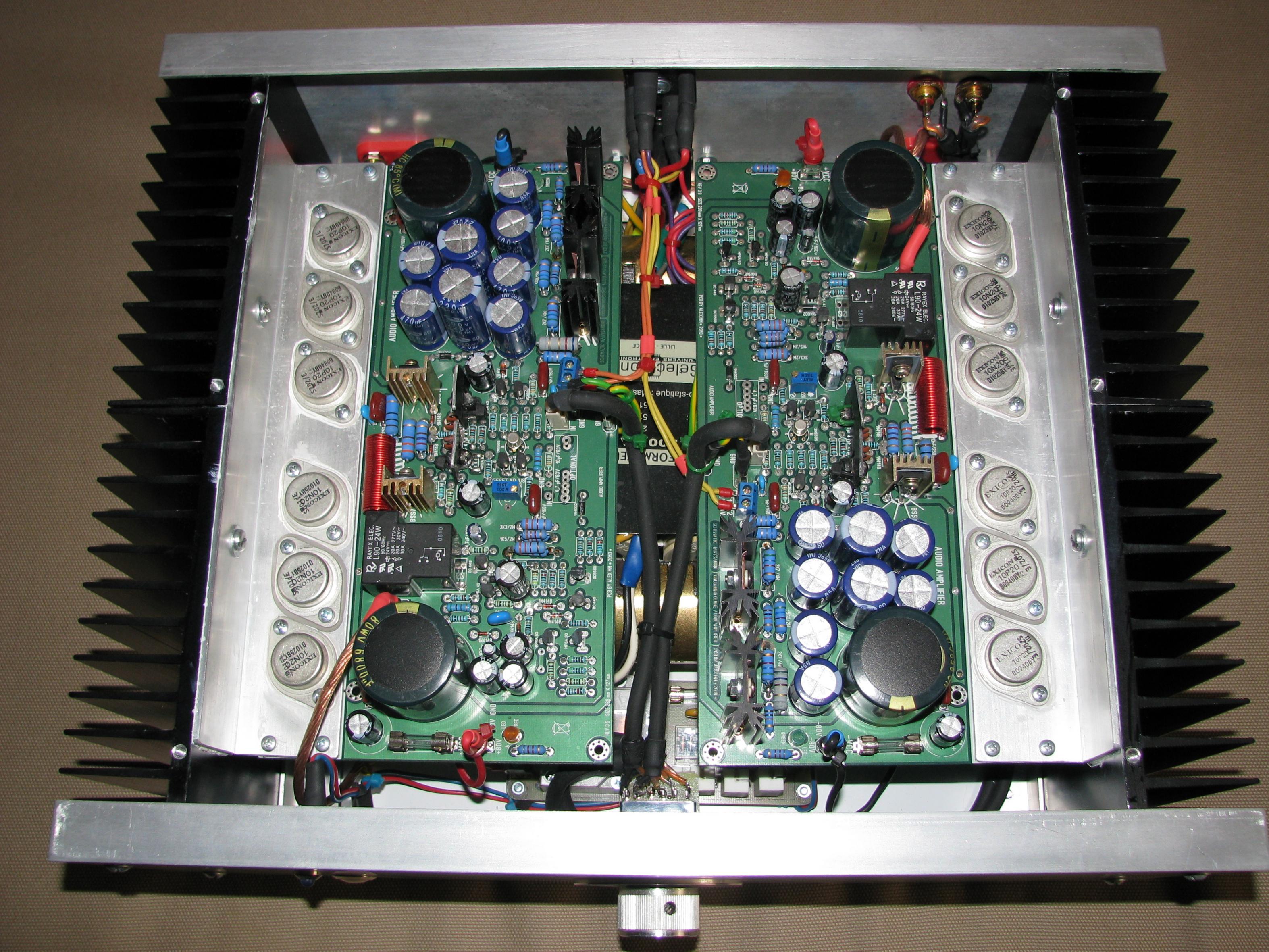

Very nice indeed!My Goldmund 's .
Regards,Alex

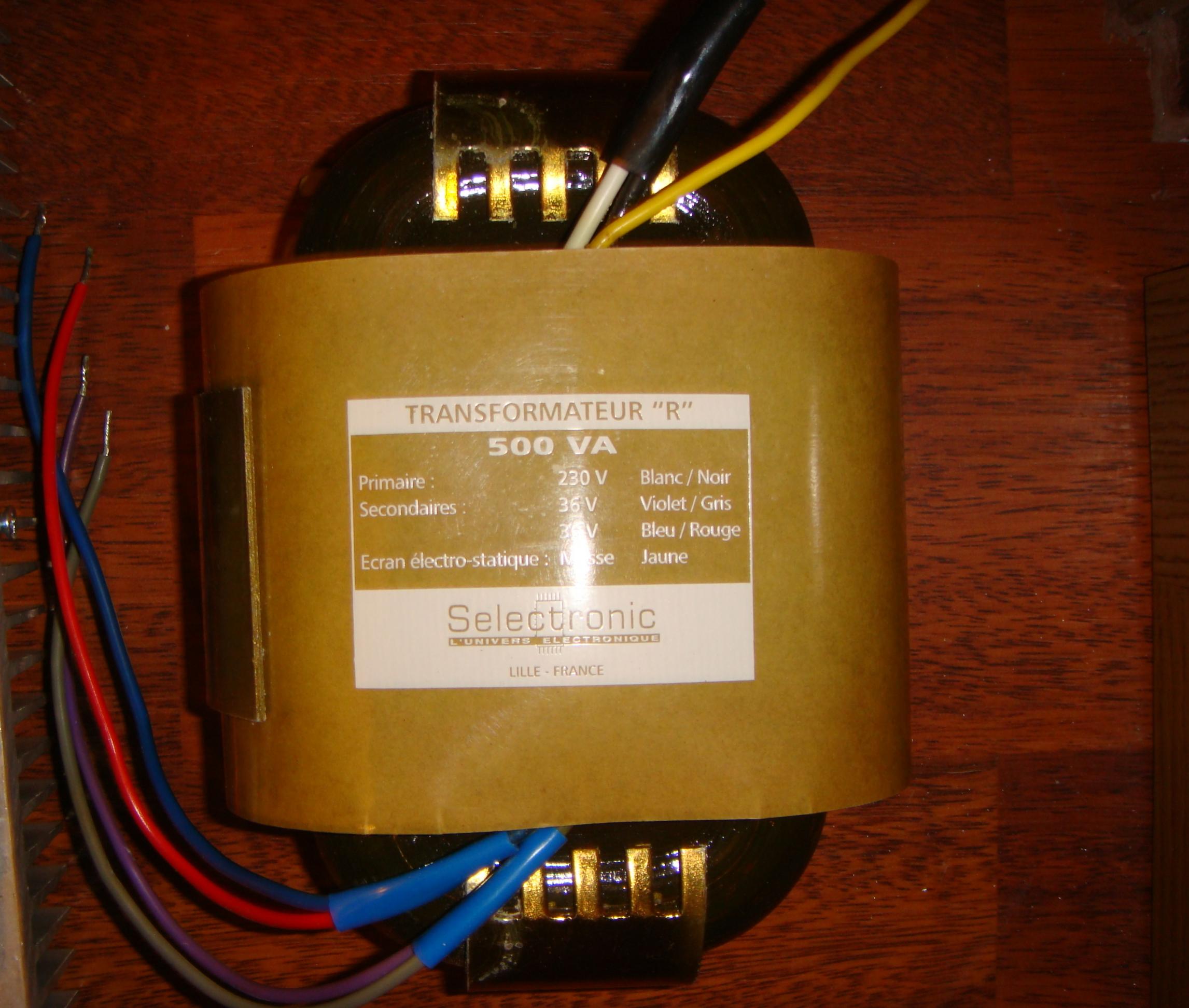

Do you use SMPS?
No SMPS, only toroidal transformer, in first picture ,and 500VA R-CORE in the second picture .Very nice indeed!
Do you use SMPS?
Regards,Alex

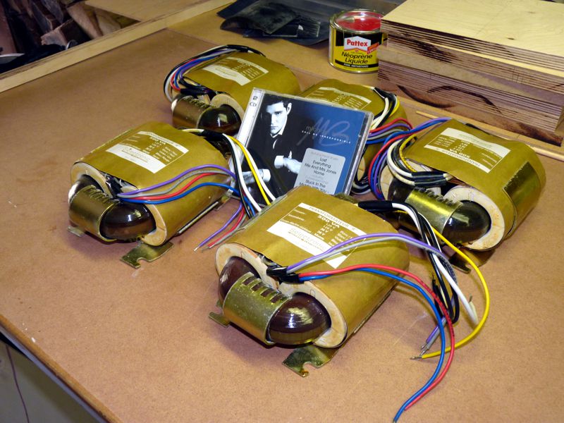

Where did you get big R-cores from and how do they perform? Good I guess?
You, can read from picture, from where ..... They are, special manufactured ,for audio, and perform very well ,without noise and small magnetic loss .
Regards,Alex
Regards,Alex
I can confirm Alex words. I use one of my five collection in NBip build. I will use rest of group in several slewmaster build.
Marc
Thanks Alex.You, can read from picture, from where ..... They are, special manufactured ,for audio, and perform very well ,without noise and small magnetic loss .
Regards,Alex

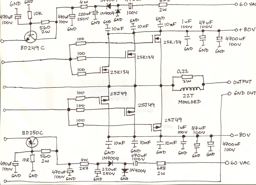

So you only have about +/- 50V on your ampboards?
No problem then with pretty high bias.
+/- 80 V on the other hand would cause a VERY hot amplifier, don´t you agree?
No, bias current is bias current.
If you increase the voltage you turn down the bias back to your chosen current.
The Perreaux I am repairing has ±115V and is set to only 170mA total per channel = 34mA per pair as it has 10 devices per channel. The heatsinks are about room temp.
I know bias current is bias current , but power consumption is very different with +/- 50V @ 150mA bias and +/- 80V @ 150 mA bias. That was my point.No, bias current is bias current.
Yes, sorry, my mistake, my brain was off-line at that moment due to a flu or something. After a good sleep I could then again remember and comprehend that the Wattage to be dissipated is derived from the voltage drop across the device x the current through it.power consumption
At that impaired moment of typing I was thinking (or not!) that only the current determines the heat, but, of course, the resistive element de-energises the elections higher potential into lower potential, energising the device into becoming warmer and the higher the potential, the greater the de-energising.
