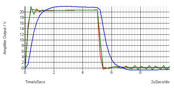

The scope shots show a pretty stable amplifer if the laod you are driving is indeed 8 Ohms in //with 2.2 microfarads. You will get overshoot and some ringing with that kind of load - it is brutal. Just to confirm this to everyone why dont you post the screen shots of the amp driving a straight 8 Ohm resistive load?

This is load test in simulation of the schematic on page one.
Red line pure 8 ohm load
Green line 8 ohm / 100 nF
Blue line 8 ohm / 2.2 uF
This conforms that the original MM9.2 amp is not perfect with capacitive load.
Note the rise time with pure resistive load and with 100 nF: <500 nS as per GM datasheet.

((((((It is usual to test amplifier transient response with a square wave while the output is loaded with 8 Ω and 2 μ F in parallel to simulate an electrostatic loudspeaker, as this is often regarded as the most demanding condition. However, there is an inductor in the amplifier output, and when there is significant capacitance in the load they resonate together, giving a peak in the frequency response at the HF end, and overshoot and ringing on fast edges.
This test therefore does not actually examine amplifier response at all, for the damped ringing that is almost universally seen during these capacitive loading tests is due to the output inductor resonating with the test load capacitance, and has nothing whatever to do with amplifier stability.
The ringing is usually around 40 kHz or so, and this is much too slow to be blamed on any normally compensated amplifier. The output network adds ringing to the transient response even if the amplifier itself is perfect.)))))))
