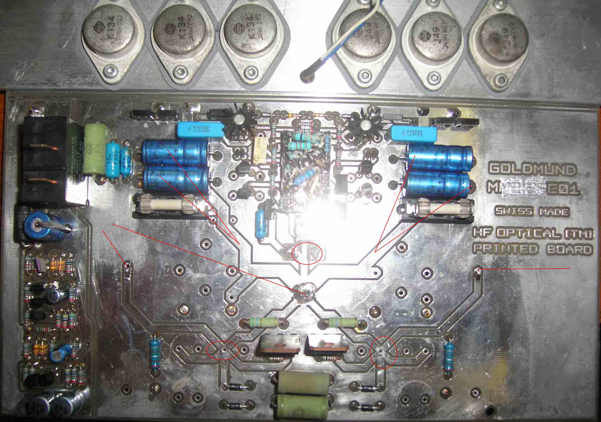

Based on this photograph we see that all the electrolytic capacitors and other materials diode main reservoir electrolytic capacitors 4700μf are joined to a thin line
ground PSU .
ground PSU .

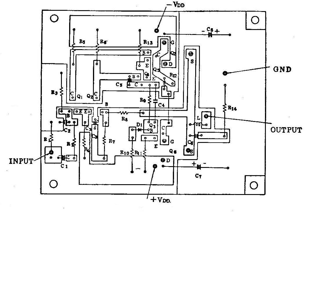

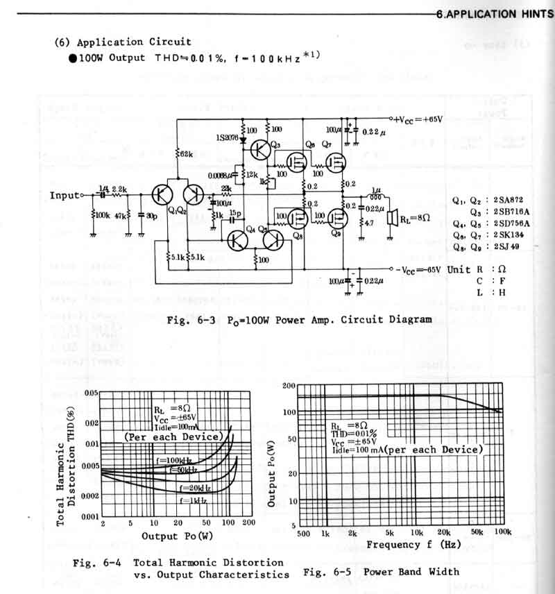

Yes, it is a star ground arrangement. That is also described in the Hitachi application note. It suppose to prevent +/- line unbalance. However Hitachis "standard" printed layout in the application note follows HF design topology PCBs. They may have obtain a design less prone to oscillate that way. Hitachi actually states that "in this high negative feedback amplifier, caution must be taken to avoid oscillation which depends on the printed pattern".
Is the Hitachi application note available?
http://www.diybanter.com/attachment...mosfet_appnote-pdf-hitachi_mosfet_appnote-pdf

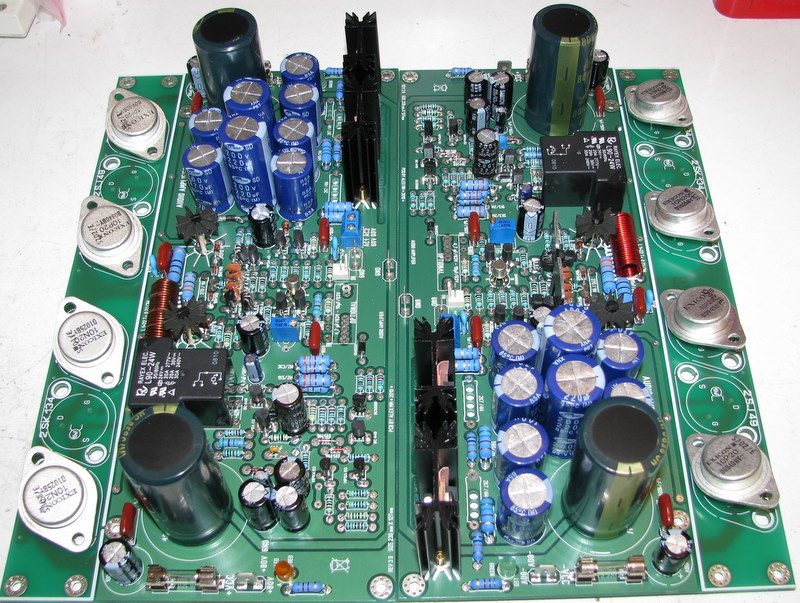

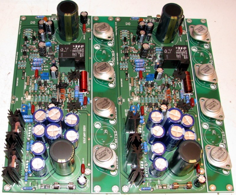

Hi Alex.... not finished , missing some parts (resistors) but here are few pictures with my second Goldmund clone amplifier....![]()
Alex.![]()
Congratulate you have very nice KIT.
I have clone many Goldmund amplifier circuit
My experience,have two ways to have great sound with Goldmund circuit(lateral mosfet output) is:
1. High current bias(200-300mA), with power supply enough clean (large capacitance>10.000uF or parallel multiple small capacitors),it raises more heat,heatsink must be large enough.Goldmund does not choose.
2. Low current bias(70-90mA), the power supply does not need too clean(for Power Amplifier stage - Output).Goldmund has chosen this option,so they just choose capacitors for the power supply is 2200uF +1000uF = 3300uF.Their heatsink is very small.

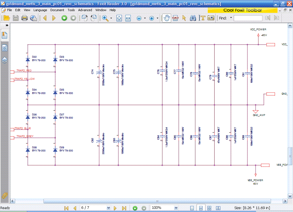

Metis3 used 3300uF/100V/one chanel ( main power supply for output stage,Vas,input,...)
T5000 use 18x100uF = 1.800uF/one chanel(power supply for output stage),not large capacitor after diode rectifier.
T5000 use 2x4700uF + voltage regulator circuit super-linear for Vas,Input,...

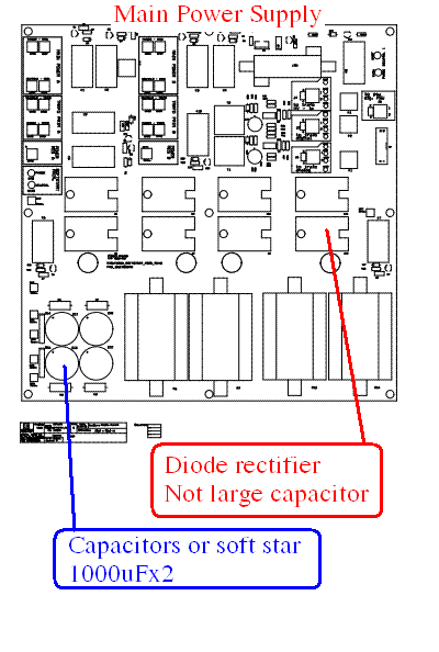

No,In the schematic and part list and layout of T5000 is not so many
Here
In main power supply not large capacitor
In output stage not large capacitor
