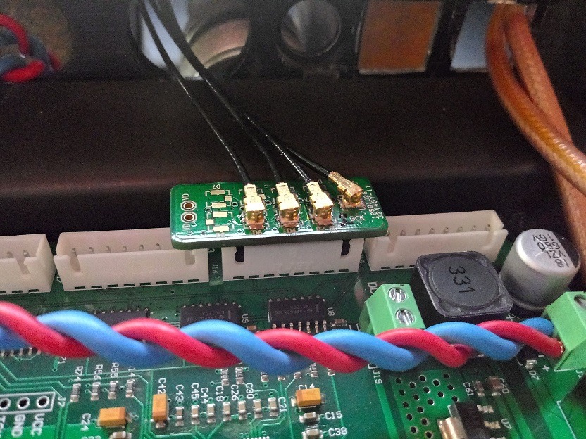

Blitz,What I used to connect UFL cable to the FIFO

- The PCB with the u.fl headers. Is that from IanCanada?

Hi Crom,I suppose that it is mine that you address you,
the PCB with UFL header come from Ian,It seems to me that it was for the B3 DAC ,Contact Ian, with a little lucky........
