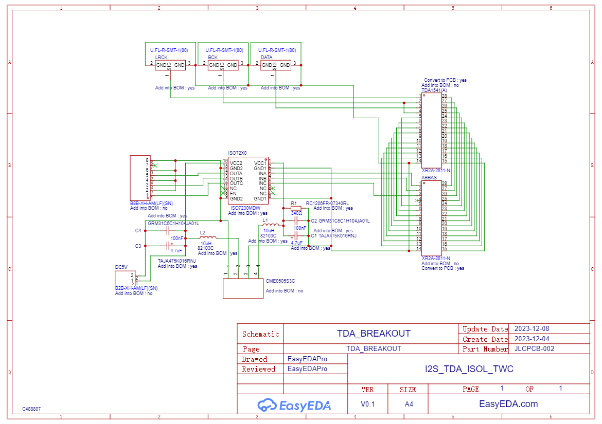

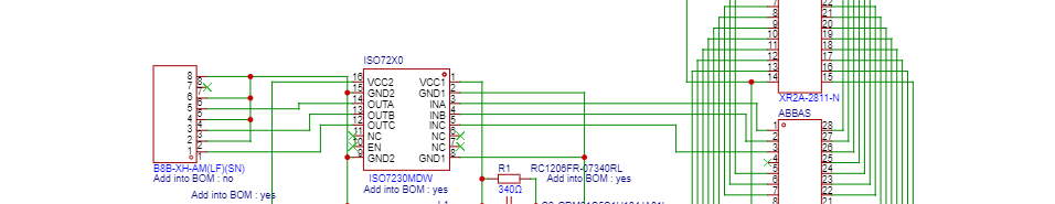

It is quite clear what your board is supposed to do. The only puzzling thing is why do you have pins 2 and 4 connected on TDA1541? That is not needed in any of the 3 TDA1541 modes. But it probably does not hurt either.

Hi bohrok. Maybe I am wrong but for non A version, pins 2 and 4 must be tied together (https://www.audialonline.com/community/topic/non-a-tda1541/)
The OIR board provides isolation and reclocking at the output so it is already isolated. But as OIR board will be powered with the same regulator as the clean side of the FIFO I need to power the other isolator with a different sec/reg psu, at least the side touching the TDA.
First approach was the dc-dc but, as Mark correctly pointed out, they seem to be quite noisy so I am thinking about another solution. Been reading about SN6501 + PushPull transformer but not sure it is a good choice....

Sorry, I did not realize you were using non-A chip. Actually in non-A pin 4 is the system clock but you can tie it to BCK (pin 2).Maybe I am wrong but for non A version, pins 2 and 4 must be tied together

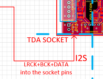

True! In original PCB, I2S signals (red arrow in diagram) would enter into TDA1541 when IC was populated. When the breakout board is installed, those I2S signals are routed to the XH connector through the isolator)
Mark, so the XH is an output connector and the U.FL are the inputs.
I am been reading the datasheet of high speed optocouplers (50Mbps) and they only need to be powered in one side. What do you think?? Are they good for this purpose. I think Andrea is using them but not sure....

The power on the output side would be provided by the dedicated psu that previously fed the DC-DC isolated so no problem here. On the input side the I2S signal would power the led right?
I have downloaded the application datasheet where explains how to calculate Ri and Rl
So long as whatever device is driving the LED can supply enough current. The datasheet specifies 5.5mA-10mA. Some logic devices can sink more current than they can source. If you need to sink then the logic would be inverted, so you would need an inverter somewhere.On the input side the I2S signal would power the led right?
