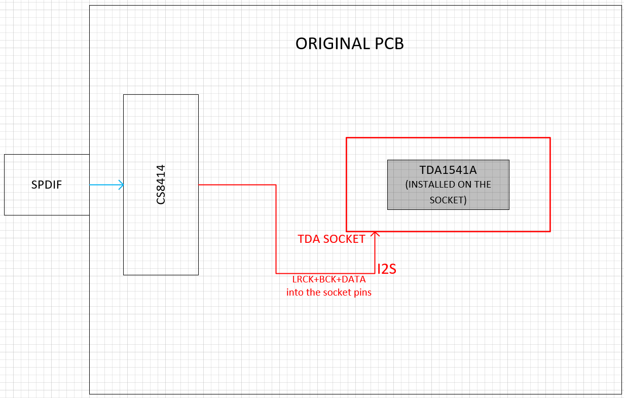

This is the original PCB

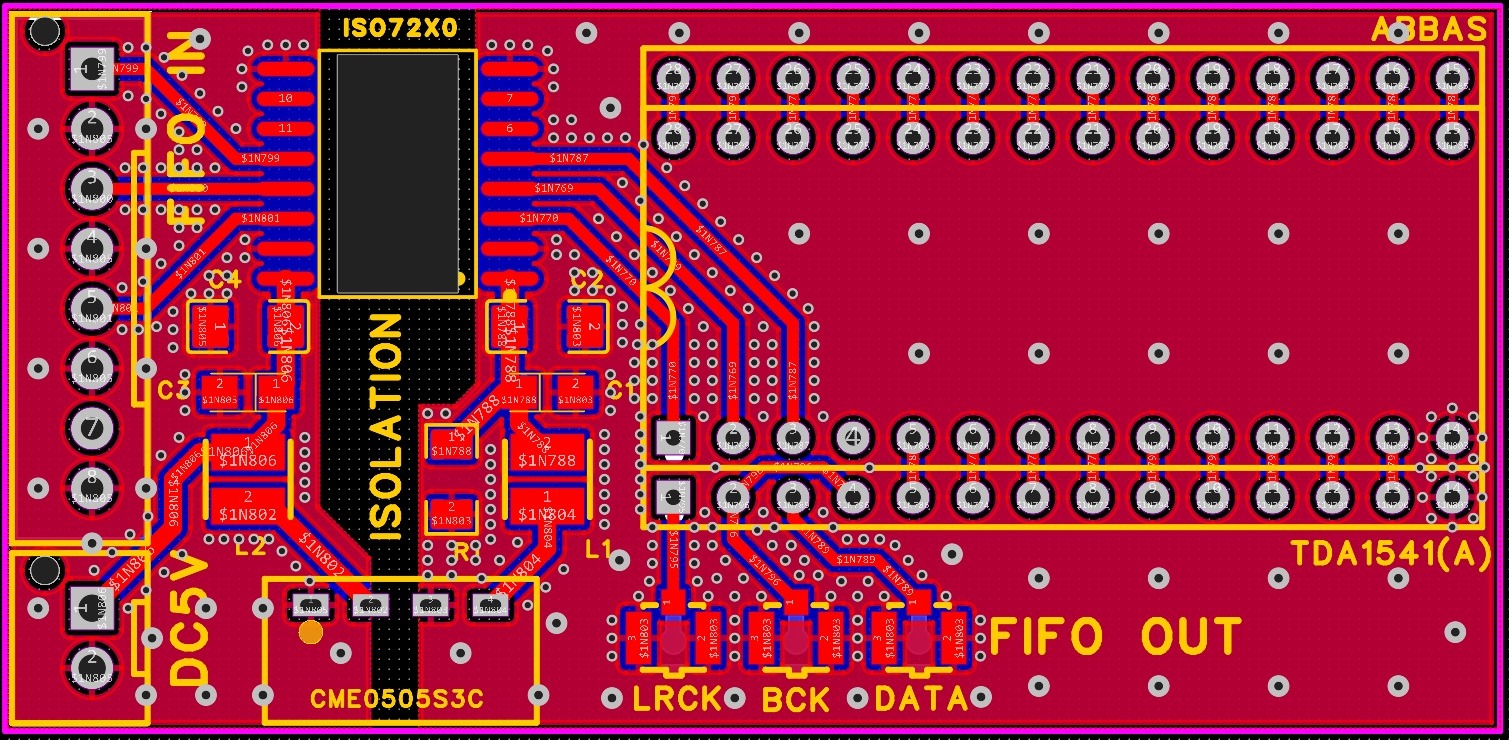

Below is the modded. First you uninstall the TDA IC from its original socket and place it in the breakout pcb socket, labelled TDA1541(A). The breakout pcb is connected to the DAC pcb via 10mm header pins from the DIP28 footprint labelled ABBAS.
The pcb reroutes the input I2S signal coming into the socket pins to the 8p XH connector, which is connected to the FIFO inputs. Then the FIFO u.fl outputs are connected to the u.fl connector in the breakout pcb.

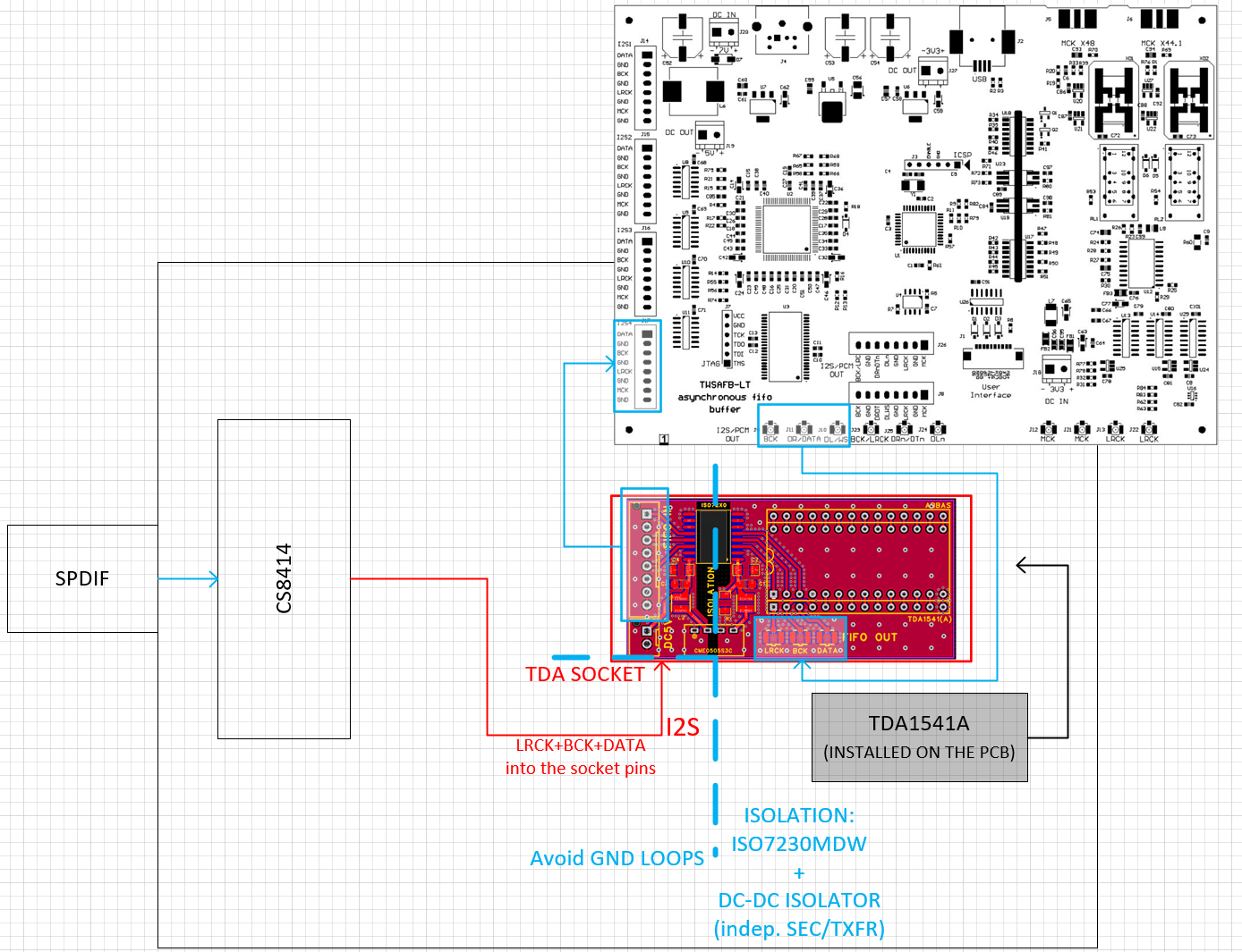

Just to make sure there were no ground loops I have placed a simple isolator circuit for the FIFO input signal based on ISO7230MDW. This way FIFO GND connects into a single point. This isolator circuit will be powered with a separate winding plus a little shunt regulator and a DC-DC isolator (CME0505S3C).
Okay. I would suggest to talk to Andrea about it. IIRC, the signals you are taking from the FIFO board need to be reclocked by MCLK and galvanically isolated.
Again, from memory, the only truly clean signal from the FIFO board is MCLK. Andrea makes an isolated reclocker board (OIR) that I used for external clocking of MarcelvdG's RTZ DSD dac. For his own DACs, Andrea does galvanic isolation and reclocking on the DAC board.
When I used the OIR reclocker/isolator board with Marcel's dac, I had to modify the OIR. There were two problems. The OIR board was not originally designed for use with the FIFO board. Thus it has parallel termination at the end of the MCLK line. Since the FIFO board uses series termination at the source, to make it work I cut the trace to the OIR parallel termination. Also there was an issue having to do with square wave symmetry with one of the signals. To fix that I needed to invert MCLK. There was a spare inverter on the OIR board anyway, so a simple trace cut and a jumper fixed that. Later when using the OIR in a different way, I didn't want the inverted MCLK so I removed the jumper and put a solder bridge across the trace cut I previously made.
LRCK is optically isolated and relocked from external clocks as well. In fact OIR is recommended when reclocking bck is needed, which is not the case of a tda1541. Andrea recommends the OI board fot a TDA which just provides optical isolation from FPGA on the "dirty" side.
For simplicity I had decided not to use it, as phase noise performance was not degraded, but maybe I should reconsider....
Okay. At the very least its probably a good idea to use isolators, otherwise the I2S signals will have common mode noise on the ground that goes all the way back to the SPDIF source.
Regarding phase noise on I2S signals and your particular dac, don't have any personal experience with it myself. That being the case and for one-off project, I would probably be inclined to play it safe and reclock. However, that's just me. If Andrea says no reclocking is needed, that's fine too.
EDIT: Also, probably wouldn't use a DC/DC converter anywhere myself. Problem is that they can generate common mode noise up around 1-2MHz that can then get into other parts of the dac. Again, isolators can help but some of the noise may also be radiated and thus able to jump across a typical galvanic isolation gap. Have verified it can happen in multiple cases with extensive experiments and measurements. I believe Andrea has seen some of it too, which is why I said I think there may be some physical differences with Sonic Empire tech. Of course, doesn't mean there would be an audible problem in this case, only that its been known to happen in some other cases.

Guess I'm not clear on why you need the isolator on your adapter board if you are going through the FIFO buffer and then through an OIR? I kind of assumed it would only be populated if you weren't using the FIFO.
In my own case if I need isolated power, I generally use a dedicated transformer winding and regulator for that.
Maybe the reason you have two rows of pins on your isolator board is so you can offset it one way or the other to use the FIFO and OIR, or else use the on-board isolator? If so, then the dirty side of the isolator could run on whatever dirty power you have on that side. Same for the clean side, use whatever clean power you have.
It is not a double row of header pins. It is two overlapped DIP28 sockets:
All pins are connected in parallel excepting the I2S pins (1-4). It is actually the main idea of the adapter board:
In this topology, if no isolator is installed between the XH and the FIFO input, wouldn´t a ground loop be created?
- In the upper one, labelled ABBAS, 10mm header pins are installed at the bottom of the PCB to connect to the original DAC PCB socket.
- In the lower one, labelled TDA1541(A), a DIP28 socket is installed at the top of the PCB to place the TDA1541 IC.
- I2S 1-3 pins of the upper DIP28 are connected to the XH connector, and then to the FIFO input (any).
- I2S 1-3 pins of the lower DIP28 are connected to the u.fl connectors coming from the FIFO output u.fls.
The only three lines through the isolator go to pins that wouldn't be connected to the anything unless that one of the 'overlapped' sockets was plugged into something. However, if no isolator was used then a ground for the I2S signals would be needed to carry across as well, but it could be enabled or disabled with a jumper.
The main difference would be when using the dac without the FIFO an OIR, then the ground jumper would have to be on, which means the dac is exposed to the SPDIF source ground common mode noise. OTOH, using an isolator would add a little jitter, but would provide galvanic isolation. Therefore, I'm guessing that in most cases it would probably be better to have the isolator if there is no FIFO and OIR.
As to whether there is a ground loop or not, there would be one if both the SPDIF source and the DAC were connected to AC power ground. However, that ground loop could be broken by using a pulse transformer between the SPDIF input connector and the SPDIF receiver IC. There are little transformers made especially for that purpose. Could still be that some HF common mode noise would make it through the pulse transformer depending on its design. If there is no electrostatic shield between primary and secondary windings then there would be some possibly significant capacitive coupling between them. Have to try it and see if any problem.
No worries Mark... the point is that I am not really sure you understand what I am trying to do. Very probably the problem is that I cannot explain clearly the idea.
Please, take a look to this site. https://www.bramjacobse.nl/wordpress/?p=6035
Basically "my" adapter board is like the DEM MOD.
So getting back to the subject, if I connect the OIR+FIFO to the ufl connectors and, at the same time, the xh connector to the FIFO input without any kind of isolation, TDA1541 digital GND (pin14) is connected to both the dirty and the clean side of the FIFO. Isn´t it a potential issue?
