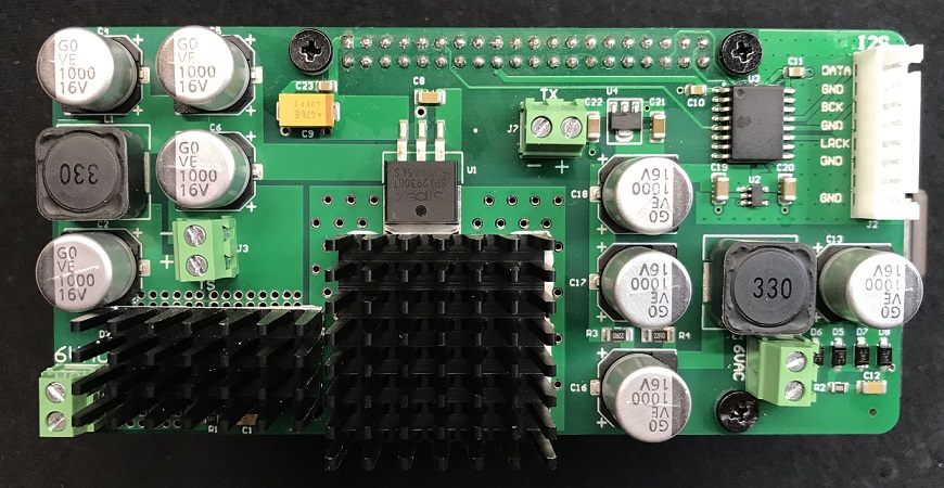

TWSAFB-RPI Raspberry power supply & isolated I2S
5V Linear regulator to supply RPI and SSD hard disk
5V connector to supply the official 7" touch screen
5V independent linear regulator to supply I2S LVDS transmitter
Galvanic isolated I2S output
Board size: 117mm x 56mm
Board options: finished and semi-finished
Note: supplied without raw materials to stack it onto the RPI

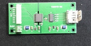

TWSAFB-TX LVDS receiver I2S over HDMI
I2S LVDS input
I2S CMOS output
2 x 3V3 low noise regulator on board
5V power supply from transmitter board (non isolated section)
Connector for independent 5V power supply (isolated section)
Board size: 82mm x 38mm
Note: TWSAFB-LT FIFO buffer provides 5V power supply to this board

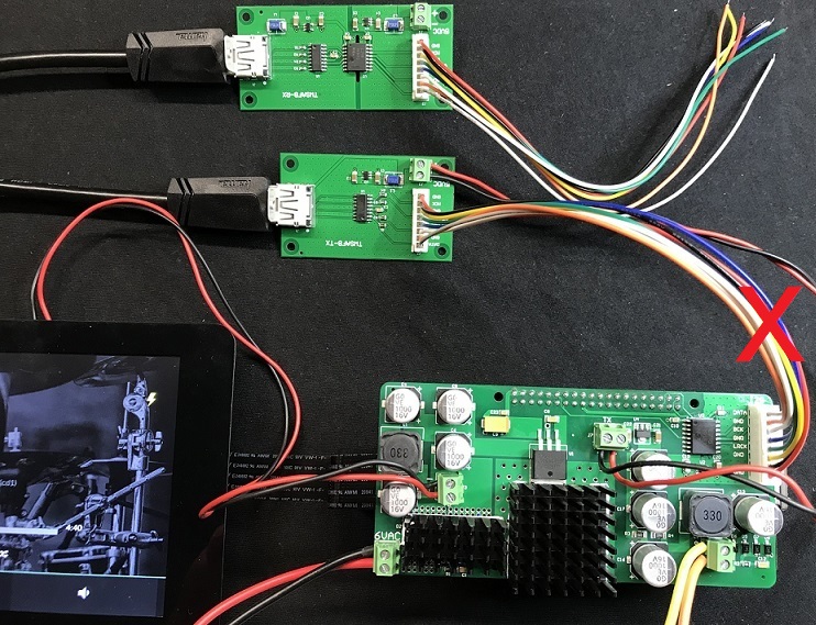

Hi Andrea! Would it be possible to connect the I2S pins from the source (UP2 in my case) directly to the TWSAFB-TX? (<->TWSAFB-RX<->I2S recloker)
I understand that possibly loosing the first isolation could be a problem, but there is also isolation in RX side...
Should I use any isolator before TX for best performance?

Yes, you can use the TWSAFB-TX to connect to whatever source you want.
Anyway there is an isolator on the receiver board TWSAFB-RX.
You can simply use a non terminated cable and solder the I2S wires to your source as in the attached picture.
