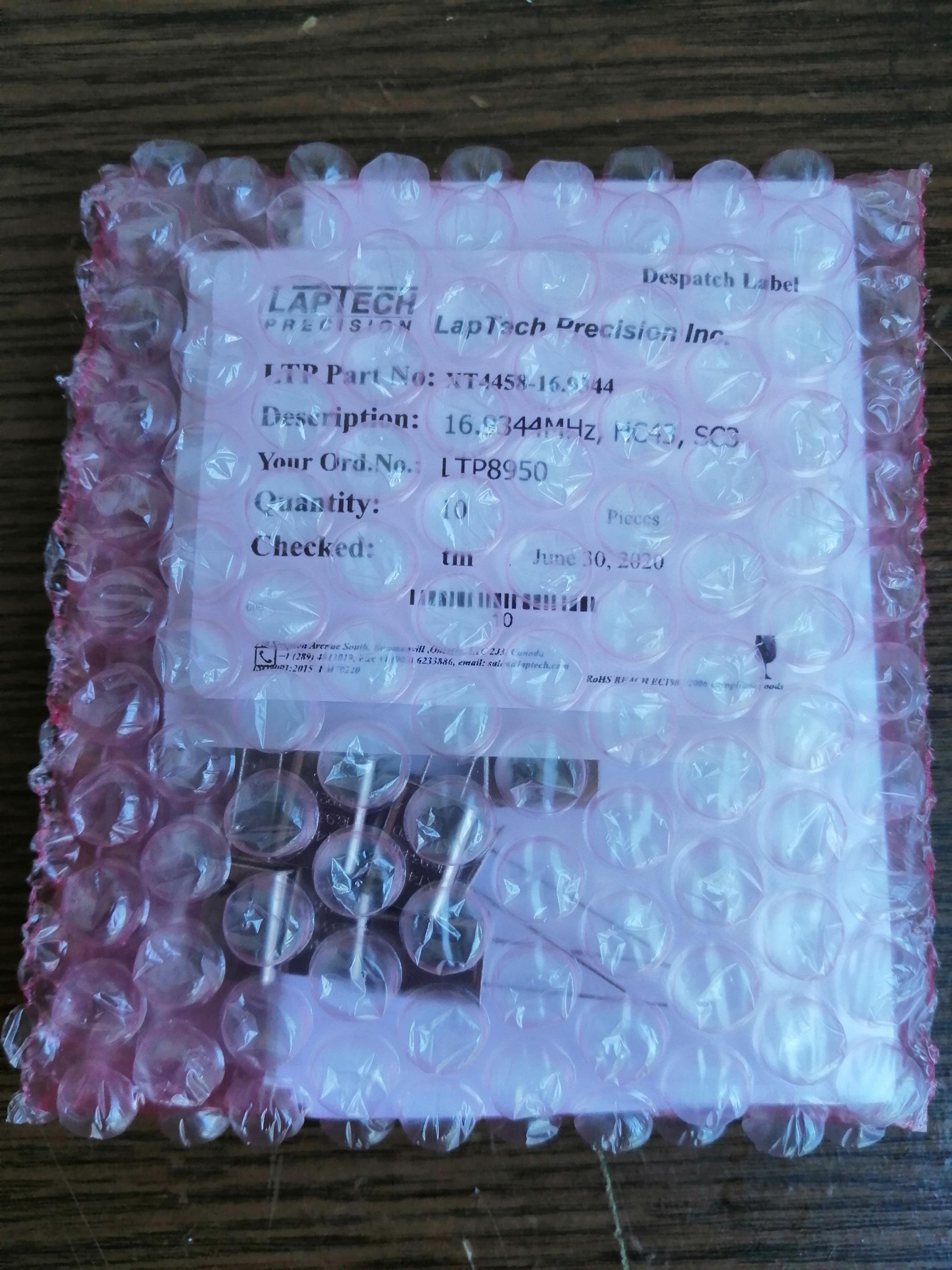

I think I was lucky, nothing else.There was not enough interest for the frequency of 16.9344MHz even in the previous GB. So I decided not to wait, but to order.The fact that it was accidentally available in stock
from some previous production, certainly helped.
I should ask Laptech, anyway at least a MOQ of 10/15 pcs.
