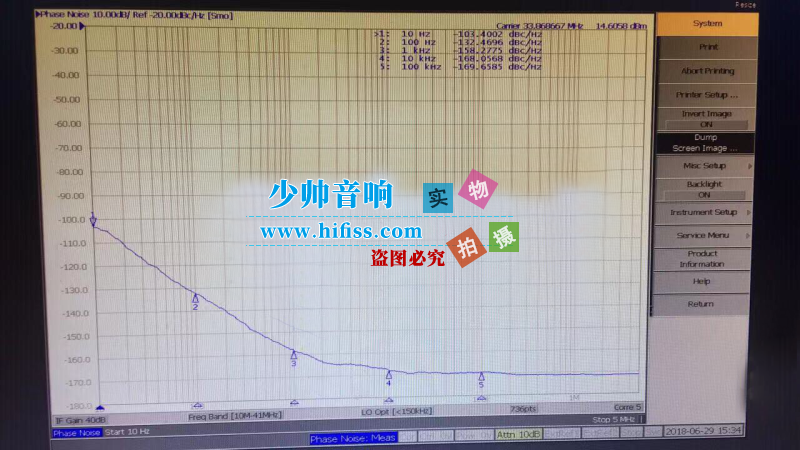

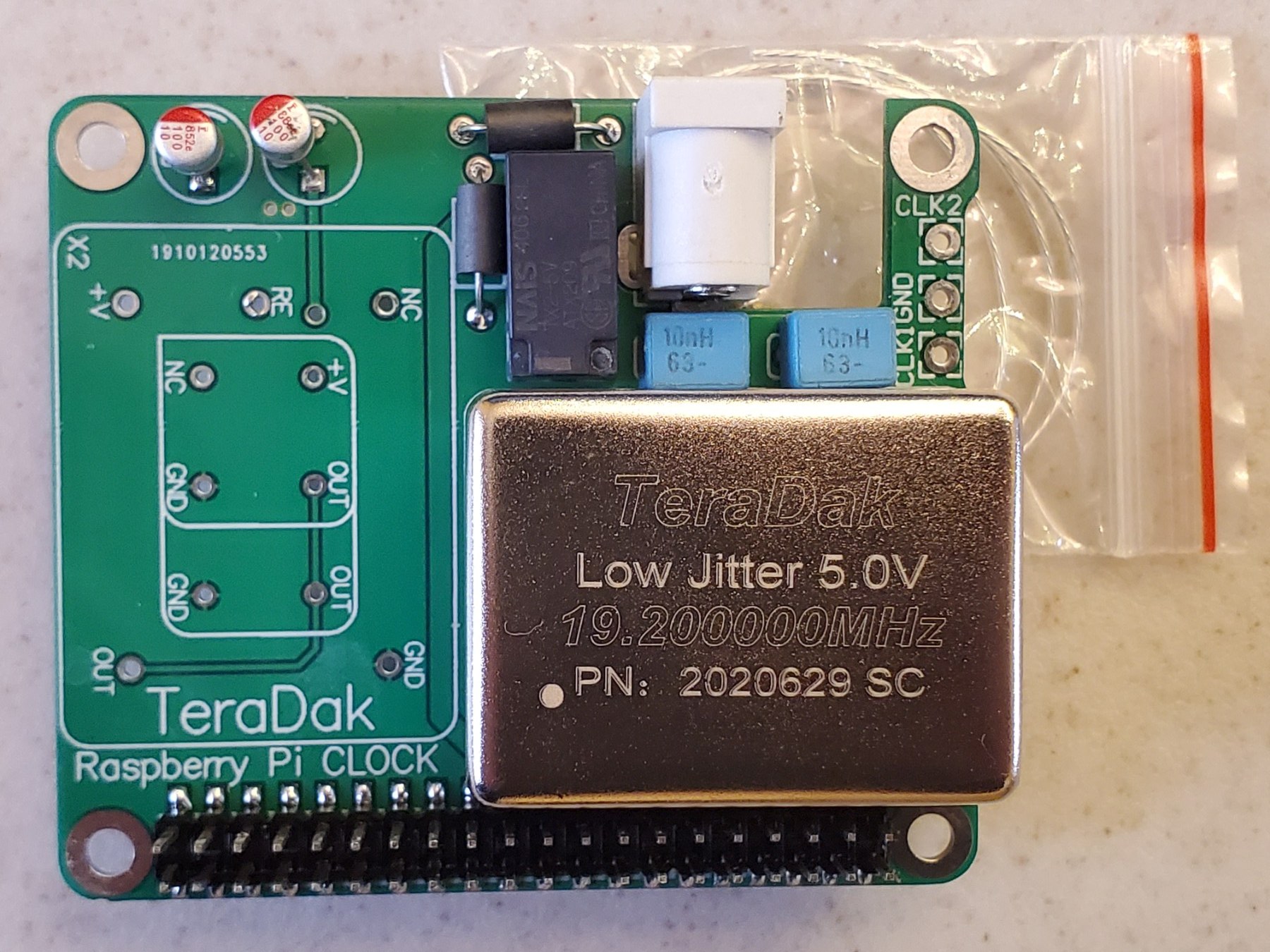

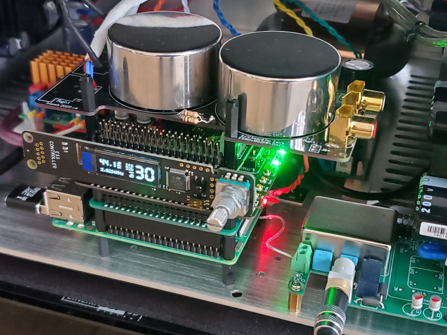

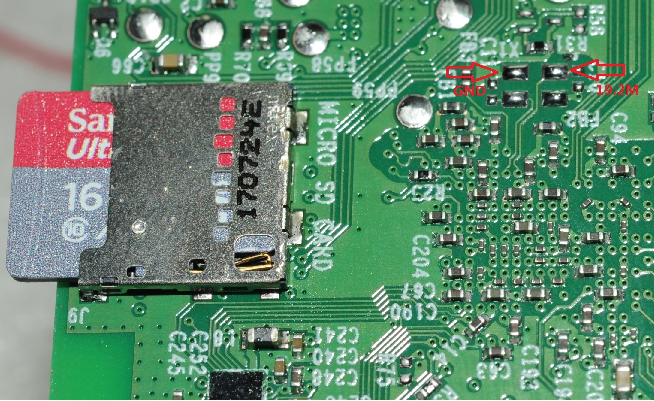

Andrea, no problem!
1) I attach a photo of the Teradak modified clock crystal OCXO 19.2 MHz for Raspberry Pi 3B;
2) Datasheet stationary Raspberry Pi 3B clock 19.2 MHz;
3) !Approximate! graph of Teradak OCXO noise;
4) Scheme for dismantling stationary clocks 19,2 MHz with Raspberry Pi 3B;
5) Photo of my setup at the moment with connected OCXO.
Andrea, an improvement MORE than changing a clock with FifoPI. Substantial synergy occurs Teradak modified clock crystal OCXO with FofoPI. this is a real reduction in jitter for the whole set. I beg you, take measurements of the noise and make sure of it.

So your RpI is reclocked by a clock hat then ? The Fifo is mandatory as an noise gnd & I2S signal isolator before it as the RpI is a bad source for DAC purposes - but an excelent one of course for library management & playback from the sofa purposes. Even so the sound quality is changing according the power suplly and so on : look at Greg thread improvment about the Fifo Rpi board from IanCanada as illustration. Andrea is right about that.
Your best bet for the moment is to use the better Allo Rpi clone. Or reclocking a raw Rpi is like icing a garbadge box : it will look nicer but not smell better. Your Rpi is needing an Allo Kali hat or a FifoPi reclocker from Iancanada at a minimum. Imho. But you maybe already uses that ?

While I think the Teradak 19.2MHz OCXO is good one, I doubt the jitter of RPi will be improved with it. The problem is the connection between the Teradak OCXO board and the clock pads on RPi. Using the long cable without paying attention to impedance matching will likely makes the jitter performance worse than the inferior onboard clock.

I think there is something wrong, you have attached a picture with an oscillator at 19.2 MHz but the phase noise plot shows a 33.8688 MHz carrier.
Anyway -103dBc at 10 Hz from the carrier is not low phase noise.

I have attached an approximate noise graph Teradak OCXO with two exclamation marks.
Oleg

Well, an "approximate noise graph" is not relevant, each oscillator is characterized by its own phase noise performance, and moreover as I already said even if the plot is true it shows a typical high phase noise expected for a AT-Cut crystal not for an SC-cut type. A low phase noise OCXO at 19 Mhz should be at least 25-30 db better.
I'm sure that replacing the clock of the Raspberry with a better one is not the right way to improve the system, there are several reasons I have explained in this thread and other threads about Ian's stuff, but anyone is free to follow his own way.
