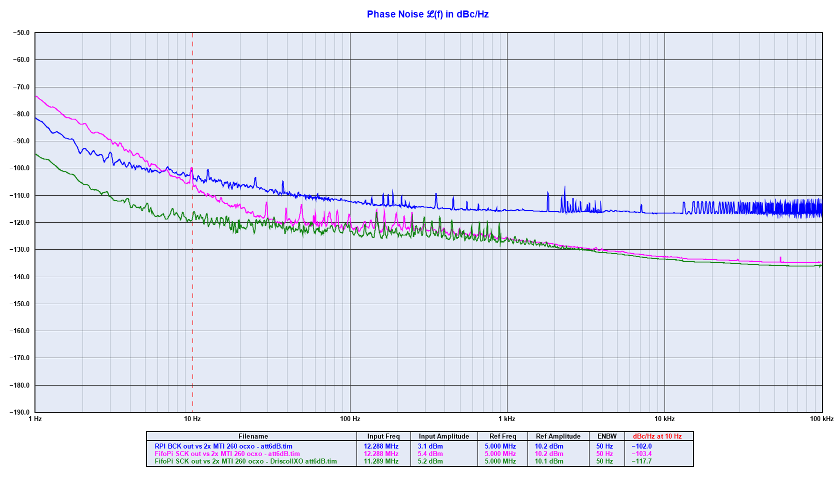

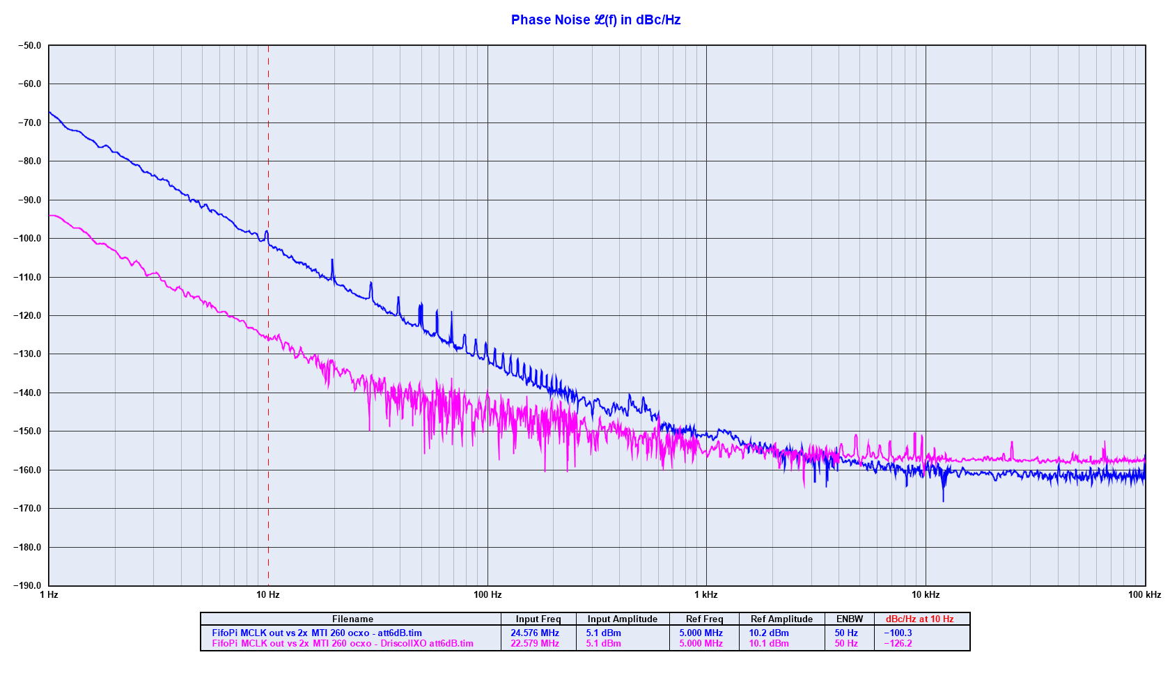

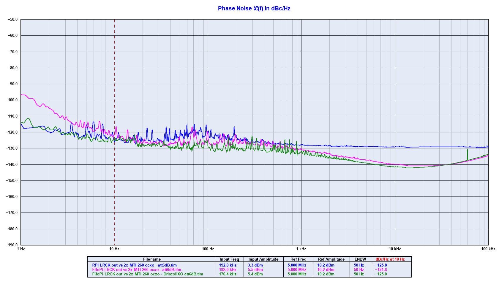

And now a few comparison of the phase noise plots:
- Fifo MCLK Out Crystek vs Driscoll
- Fifo SCK Out RPI vs Crystek vs Driscoll
- Fifo LRCK Out RPI vs Crystek vs Driscoll
The plots tell themselves, so better if avoid any comment.
Maybe the designer could comment the measurements.
I only have to say that the Crystek is 26dB worse than the Driscoll at 10Hz from the carrier, as expected.
There was an error in the plots, I have published the same LRCK plot 2 times instead of the SCK one.
I attach the corrected plots.

You have always to look at the close in phase noise, around 10 Hz or lower from the carrier, since the short term stability is the most important factor in digital audio.
The MCK was measured at the output of the FifoPi, I don't know how the FifoPi manages the MCK.
I could imagin that it crosses a multiplexer.
I said I would avoid commenting, I wouldn't want to be burned at the stake of fundamentalist followers, anyway it looks like the jitter won the battle against the ultimate weapon.
About the SCK output one would expect a phase noise 6 dB better than the MCLK since the MCLK is divided by 2. Unfortunately:
- at 1 Hz from the carrier the SCK is 10 dB worse than the MCLK
- at 10 Hz from the carrier the SCK is 9 dB worse than the MCLK
- the broadband noise of the SCK is around 20 dB worse than the MCLK
- in both SCK and LRCK plots there is a noise peak in the range 30-300 Hz.
The LRCK output is even worse, in that case we are dividing down several times, so one expects a great improvement, instead:
- the noise peak is more pronounced
- at 10 Hz from the carrier the phase noise is almost the same of the RPI with the Driscoll oscillator and 4 dB worse than the RPI with the Crystek oscillator
- the broadband noise is a disaster related to the MCLK

Finally, how can you correlate the measurements with the sound?
Since you are using the PCM1794 that switches on the BCK signal you can expect an improvement in sound using the FIFO with a fine oscillator.
If you look at the SCK output comparison plot you can see that the SCK is 8-9 dB better than the original from the RPI with the Crystek, and 22-23 dB better with the Driscoll at 1 Hz from the carrier.
At 10 Hz from the carrier the SCK output has almost the same phase noise of the RPI, while it's almost 16 dB better with the Driscoll.
Certainly it's not the best you could reach, we are far away from a very good digital chain.

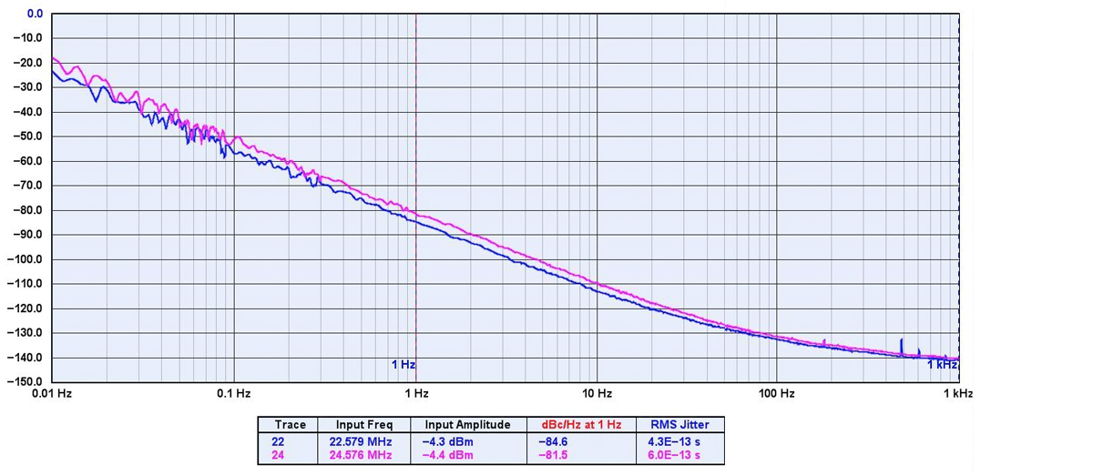

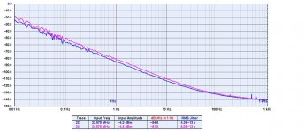

I have said several times that jitter is a standalone number that does not say anything because it does not explain the spectrum of the noise. It's a valid measurement results for telecommunication but not for digital audio.
BTW I attach some phase noise plots from real measurements and RMS jitter conversions to better understand the importance of the noise spectrum.
The title of each picture refers to the measured device.
Sorry but I have no time to comment the measurements, maybe later.
P.S.
Anyway your calculated 3.12ps or my calculated 2.656ps from real measurements for the Crystek CCHD-957 means that the members got a crappy oscillators, real low noise oscilaltors are in the fS region.

Thank you for posting the phase noise testing result. The 24.576 MHz (MCLK) and 12.288MHZ (SCK) measurements are very close to my time domain jitter test result. You did a good job.
But I don't think your low frequency 192KHz LRCK phase jitter testing result is correct. Low frequency clock measurement is really challenging to a phase noise analyzer. However, your TimePod may even not be capable of the192KHz measurement. You also forgot to mention to us that the TimePod has limitations to measure frequency lower than 0.5MHz and higher than 30MHz. 192KHz LRCK is already out of the testing range. No matter how you implemented the measurement, How can you keep accuracy for an out of range measurement? How about the change on phase noise floor? How to calibrate, How to validate the testing result.... All of those have to be questioned before you post the result.
Basically the FifoPi I2S jiitter will be MCLK jitter + additive jitter of the flip-flop. SCK and LRCK are both slaved to the same MCLK , and from the same flip-flop package. So, the jitter of FifoPi LRCK will be exactly the same as SCK. Since your FifoPi SCK phase jitter test result was RMS 3.103ps, the LRCK phase jitter should be around RMS 3.103ps too. My time domain jitter test result also supports this. However, your 192KHz LRCK phase jitter testing result is way off compared to this number and also my time jitter testing result. That's very unreasonable. How can we trust your phase phase noise and phase jitter measures at low frequency?
Why don't you measure the SCK and LRCK of a 44.1KHz 16bit music? I was wondering if I can use phase noise to discuss the I2S signal, but finally found it's impossible. Even yourself have to convert the phase noise into phase jitter for the I2S testing result. BTW, as long as you use RMS for jitter number, it means the jitter is not just a number. Actually each point of the time jitter histogram curve is corresponding to an offset frequency at phase noise plot.

Well, if the FifoPi performs 7dB worse than the Rigol with a true low noise oscillator (the Driscoll) and 10 dB worse than the DDS generator with the Crystek oscillator, and even worse than the original BCK from the Raspberry (4 dB with the Crystek), I believe that you should ask yourself several questions.
Are you sure that FifoPi I2S jitter should be BCLK jitter + additive jitter of the flip-flop?
Firstly, each time you divide you should theoretically improve the phase noise for 6 dB, so SCK and mostly LRCK should have a lower phase noise than the MCLK.
Then, I have never seen any schematic of your devices, but I assume that the SCK and the LRCK are generated inside the FPGA. How about the firmware?
Again, I don't know anything about the firmware, but I suspect there is something not well optimized since the broadband noise rises a bit (maybe crosstalk?).
I have converted the phase noise into phase jitter only because you continue to ask for this number, that's a valid result for telecommunications but useless in digital audio.
As you can see from the plots the phase noise analysis shows perfectly the spectrum of the noise, and regardless of the jitter measurement there is a clearly visible peak of noise in the range 30 to 300Hz.
And it does not come from the master clock and neither from the Raspberry.
These plots can help you a lot to improve your devices, now you know exacty where you have to put your hands.

"Are you sure that FifoPi I2S jitter should be BCLK jitter + additive jitter of the flip-flop?"
FifoPi generates both SCK and LRCK at finial flip-flops in clock section by the MCLK. Fifo logic (FPGA) only makes them synchronized to the new MCLK domain (to perform clock domain isolation). Has nothing to do with firmware. So, why not?
"Well, if the FifoPi performs 7dB worse than the Rigol with a true low noise oscillator (the Driscoll) and 10 dB worse than the DDS generator with the Crystek oscillator, and even worse than the original BCK from the Raspberry (4 dB with the Crystek)"
If the measurement result is not reliable then everything could be wrong. And also I2S are square wave digital signals, you need to measure the jitter of the rising edges of the signals. That could be another limitation of phase noise measurement.
Ian
It looks like you don't know how a phase noise analyzer such the Timepod or the E5052 works, I would suggest Time-Nuts forum and Rubiola.org.
We have not hacking anything, simply there is an option in the software to remove the lower limitation.
So, the measurements of the Timepod are not "quite accuracy", they are the same of the Aeroflex PN9000 and the Agilent E5052A. We have measured the same devices and the phase noise plots are exactly the same for all the gears.
The cheap DDS was the DUT not the reference! The reference are a couple of MTI 260 OCXO, used in 3 cornered hat measurement.
The cheap DDS, the DUT, was measured with square wave ouptut at 192 kHz, the measured phase noise at 10 Hz from the carrier was -132dBc, while the phase noise of the LRCK from the FifoPi at the same frequency is -125dBc at 10 Hz from the carrier, 7 dB worse.
So do you think that the Timepod penalize the FifoPi?
"If you have high speed logic design experience"... I have no experience of anything, I am a beginner who likes to measure rather than claim.
"A good clock divider normally have a couple of ps of additional jitter." Although you continue to talk about jitter, it's not true, a good divider does not add any jitter/phase noise, when you divide you should improve the close in phase noise, otherwise there is something wrong.
The problem here is that your divided clock is worse than the MCK to be divided. Please, take a look at the SCK comparison plot #2398, the MCLK (22.5795 MHz) is -126.2 dBc while the FifoPi output (11.2896 MHz) is -117.7 dBc, 8.5 dBc worse.
The measurement results are more than reliable and the phase noise analyzer ha no problem to measure the phase noise of a square wave. Please, compare the first plot in post #2398 with the plot #2017, the plots are almost identical.
The older is the phase noise of the sine wave output of the Driscoll oscillator at 22.5792MHz, the newer is the same oscillator followed by a squarer.
You continue questioning the reliability of the LRCK measurement, especially the noise floor, when the SCK measurement is even worse.
Do you trust the reliability of the Timepod at 12MHz?
Please, take a look at the second and third plots in post #2395:
- 100 Hz from the carrier, FifoPi LRCK is -120dBc, while FifoPi BCK is -116dBc, 4 db worse
- 1kHz from the carrier, FifoPi LRCK is -130dBc, while FifoPi BACK is -126dBc, again 4 db worse
- 10kHz from the carrier, FifoPi LRCK is -140dBc, while FifoPi BACK is -133dBc, 7 db worse
- 100kHz from the carrier, FifoPi LRCK is -136dBc, while FifoPi BACK is -134dBc, 2 db worse
So the noise floor of the FifoPi BCK at 12.288MHz is far worse than the noise floor of the crappy Crystek.
Do you think the Timepod adds 20-25 dB to the noise floor of the FifoPi BCK?

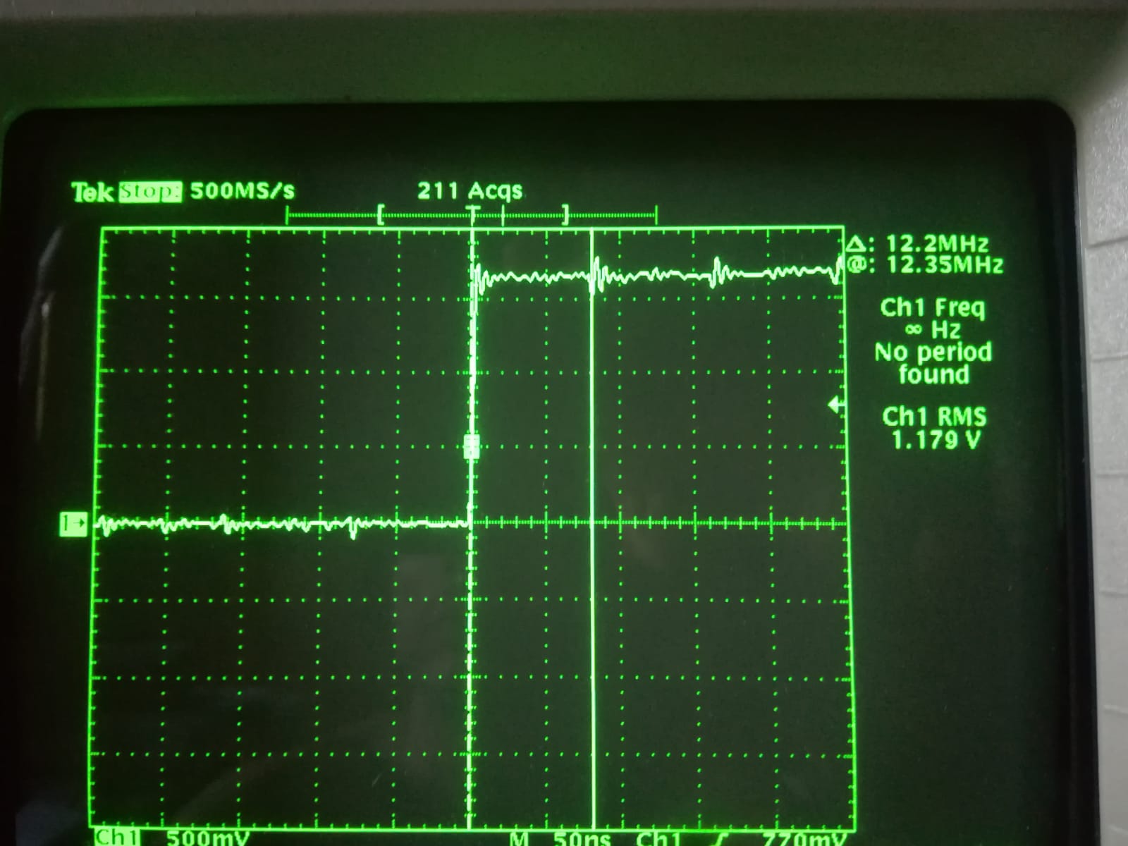

Now take a look at the attached picture, it shows the LRCK output of the FifoPi.
It looks like you have crosstalk.
